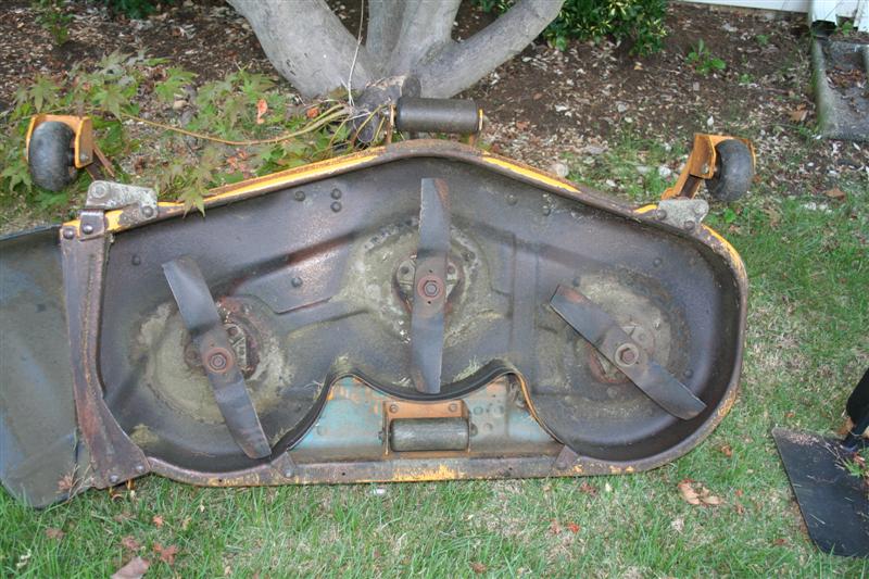

Got my Gators in from C&G and installed them last night.
Pulling the deck was quite a chore. This 48" Model 317 deck with it's big out-riggers simply is not coming out from under this tractor without it being jacked up.
I had to jack up the front of the tractor about 18 inches so the riggers could come out under the front tires.
First picture is the deck removed. Looks pretty good for 12 years old and never really serviced.

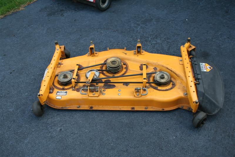

Second picture is underside with old blades. I did not clean it. This is as it came off the tractor.

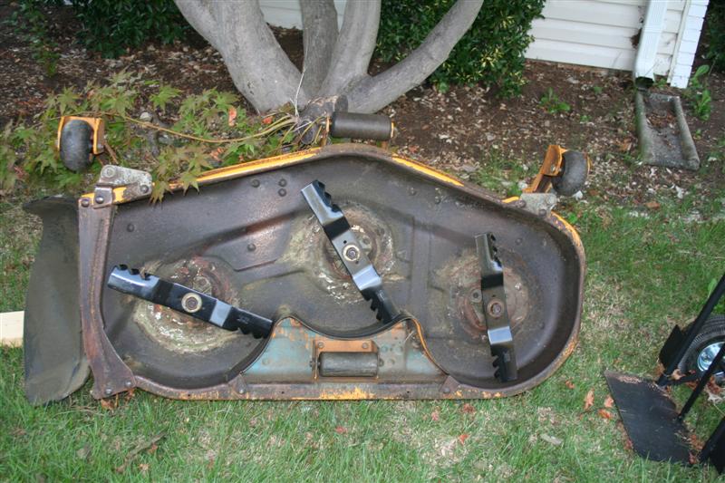

Picture 3 is with Gators installed and ready to go!

In the second picture, can anyone tell me what type of blades the old one's were? Standard? High Lift? Mulching?

They are pretty noisy too. When you raise the deck, such as when coming around for another pass, you can hear them roar like ****!
