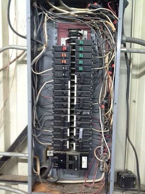

   / Installing 240V Service To Your Shop - Price Breakdowns... #5
Go big
I've 400 amps :) Left as a mess by the prior owner.
