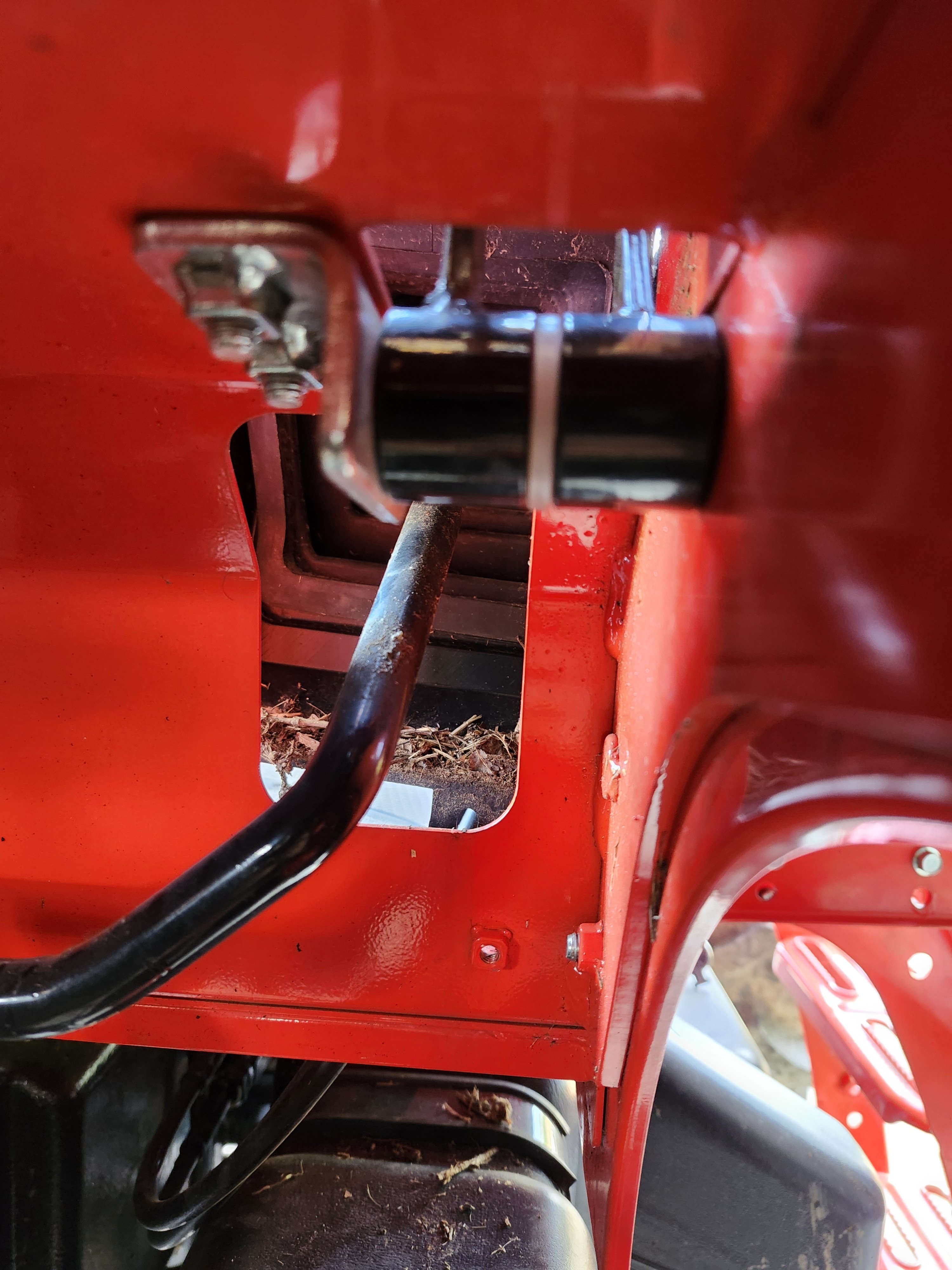

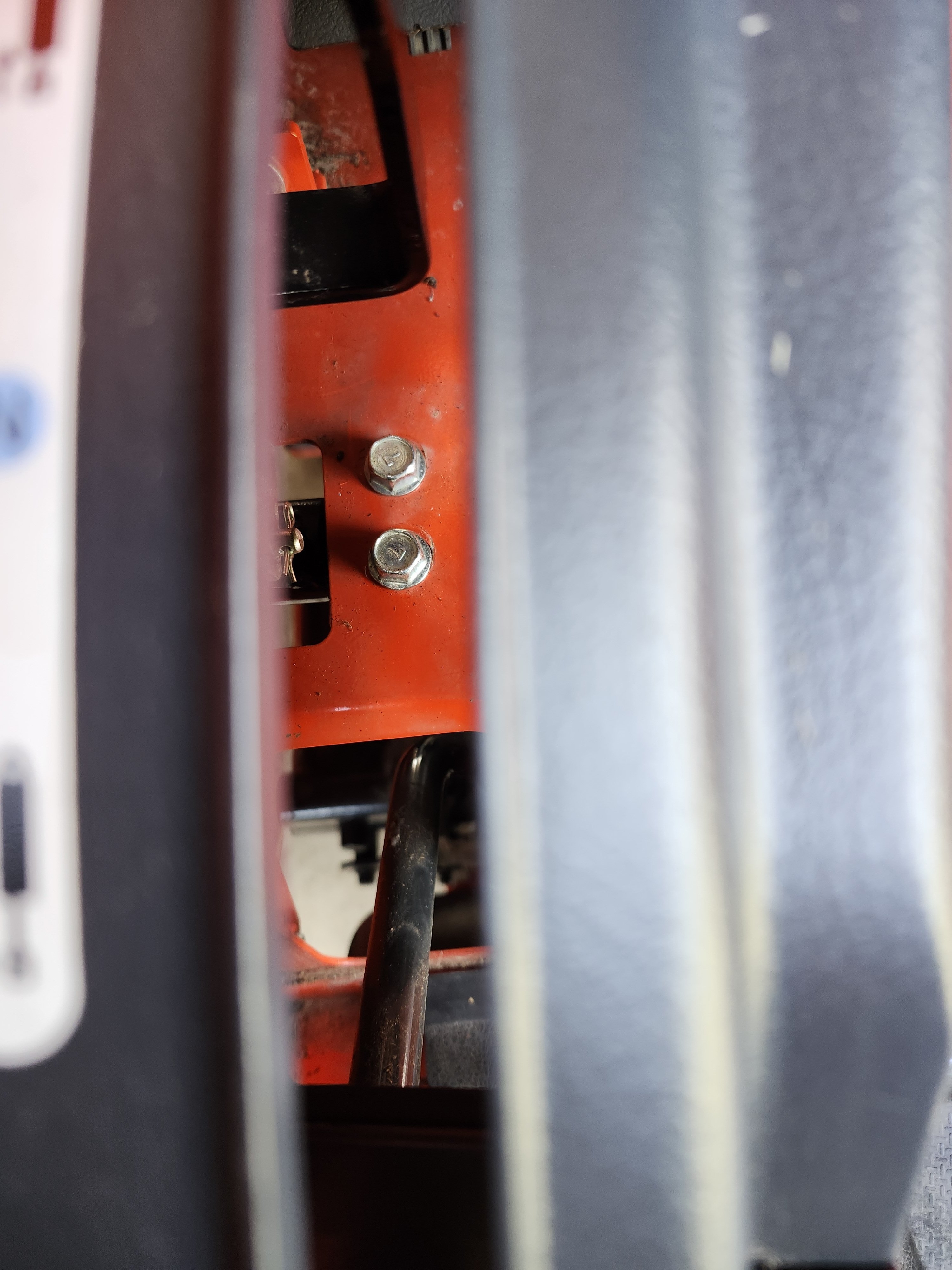

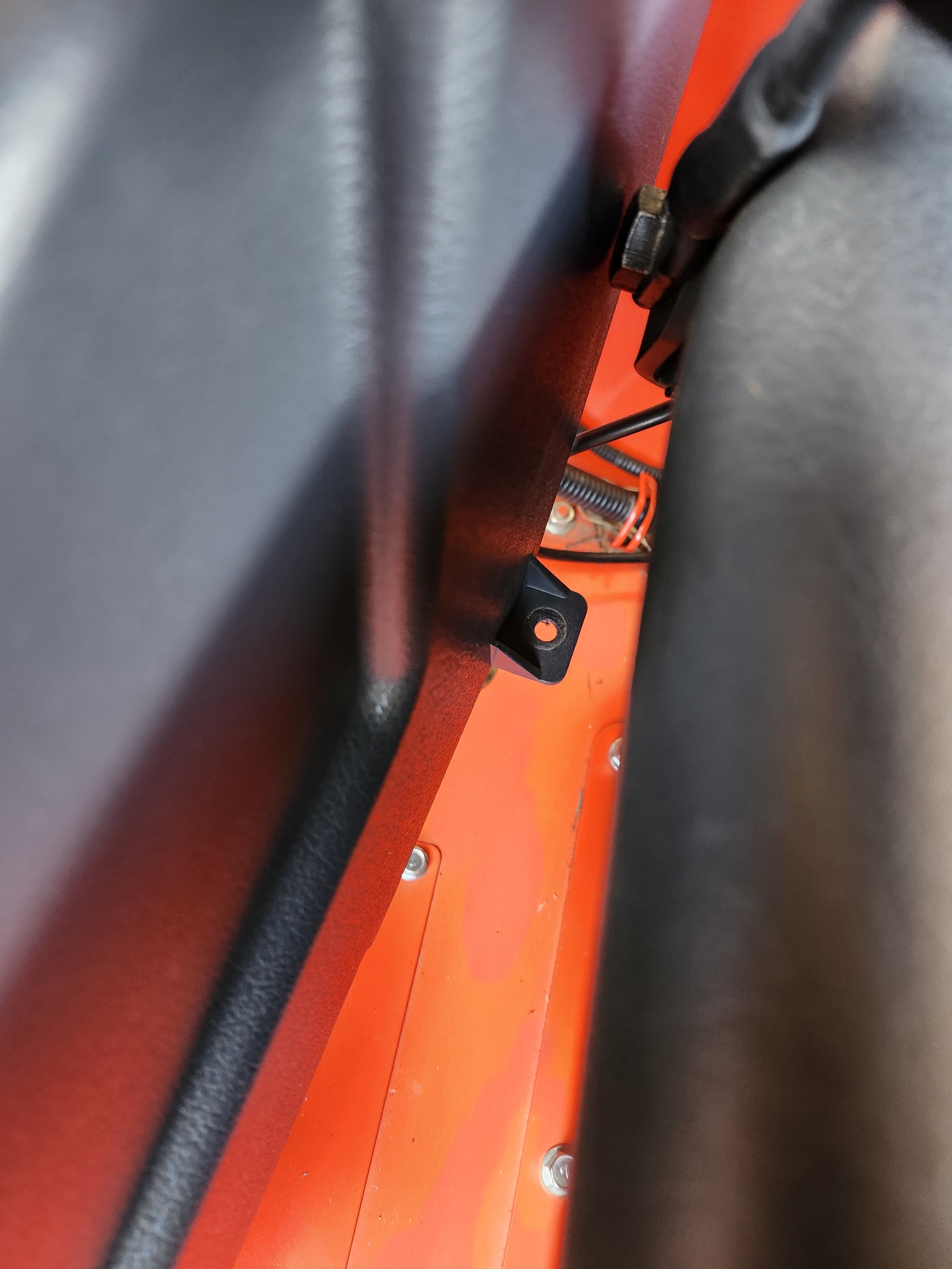

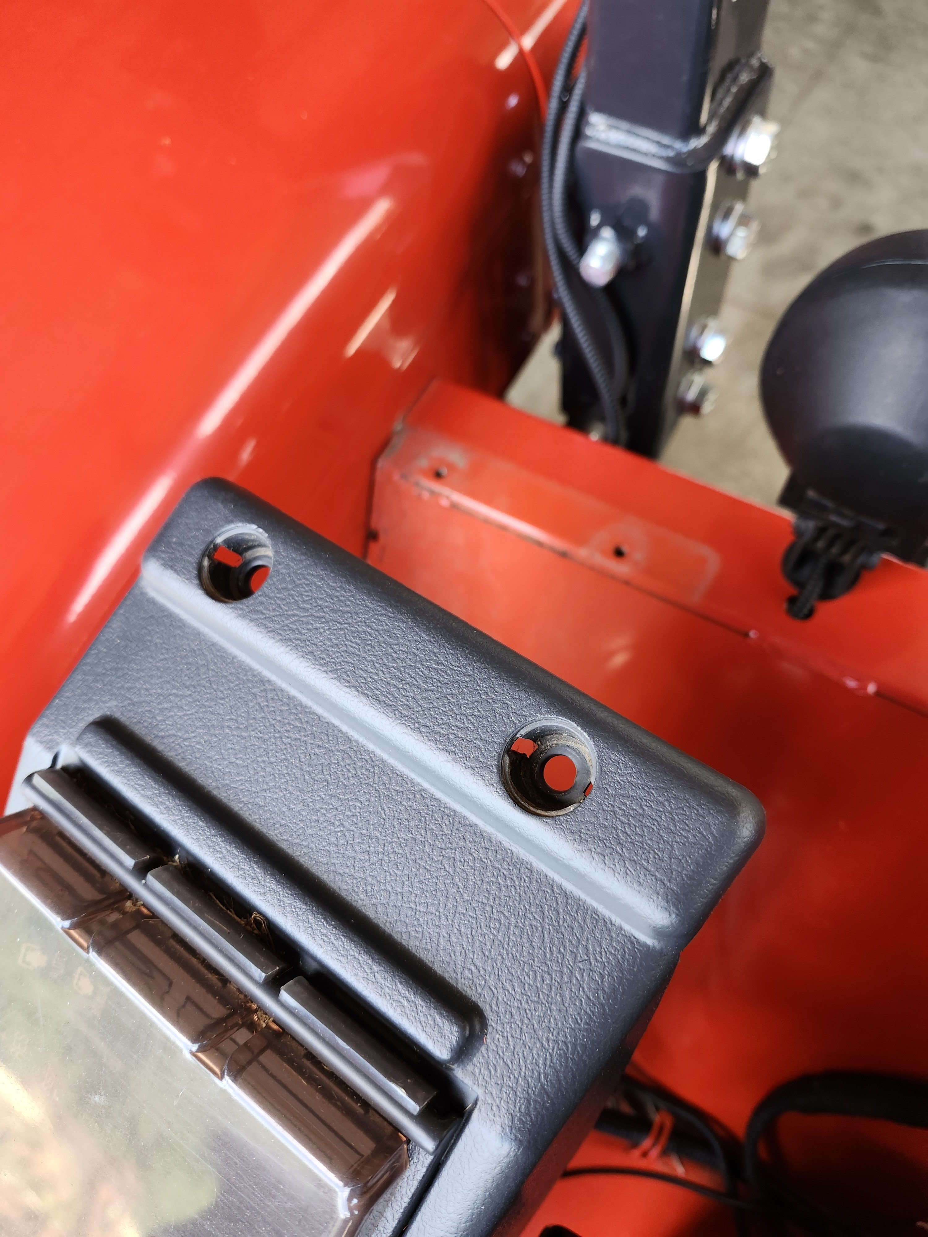

I installed a detent floating valve on my tractor. The 1st thing I did was get the shifter cable and handle installed. There were a total of 6 bolts to remove to get the right side "console" loose. 20250704_165247.jpg
Lower left of pic shows slot for bolt.
Can see location for top 2 bolts. Had to pop off plastic covers first.
Location in middle of pic.

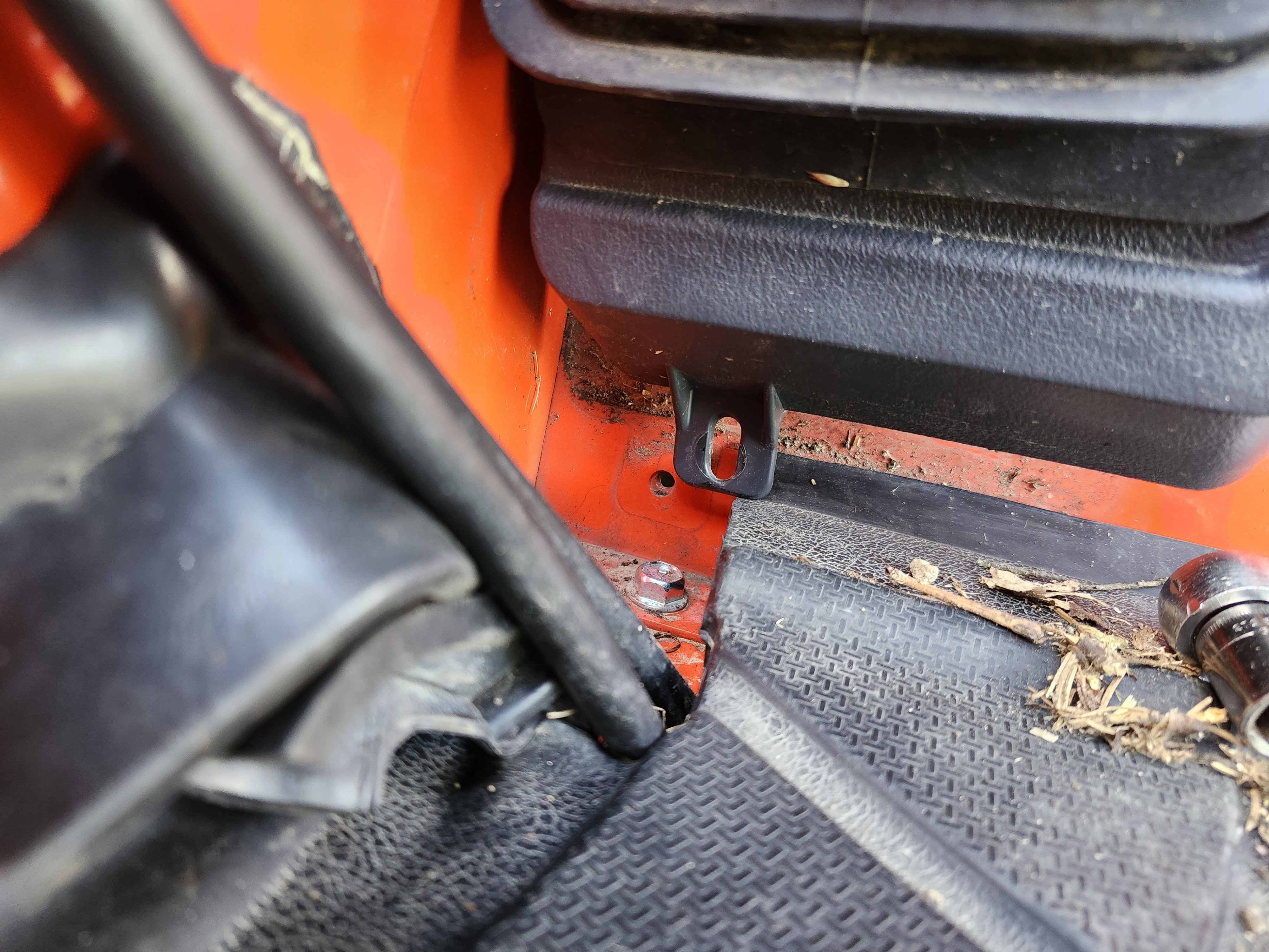

This bolt located below pto lever.

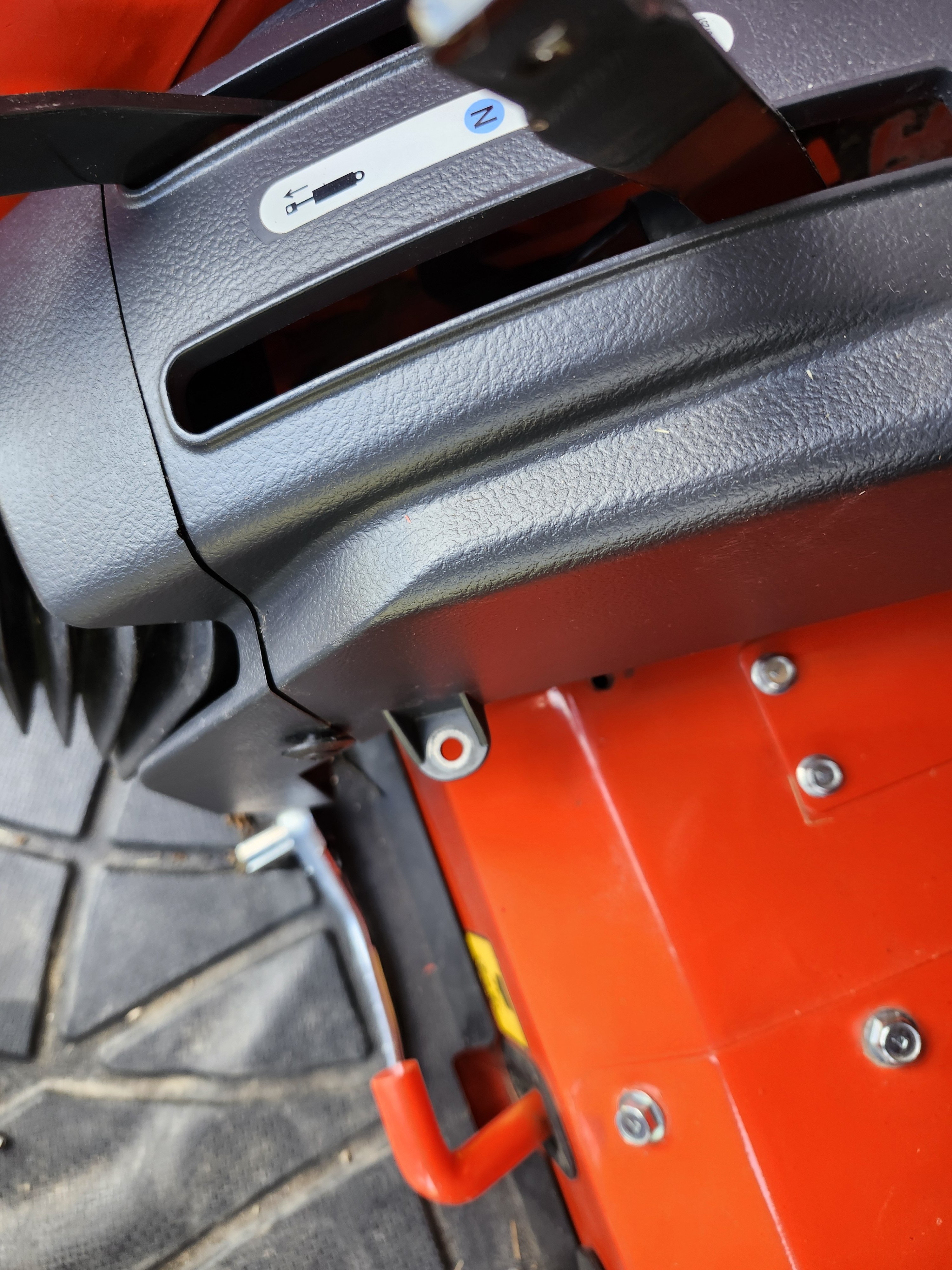

This bolt located at back bottom. I think bolts were 10mm.
Once I removed these bolts I had to detach the cover for the 3 pt lever and draft lever and slip it under the console to lift it up far enough to install the parts. I did not unplug anything and left pto lever alone. My very 1st pic shows the cover recessed down below the console.

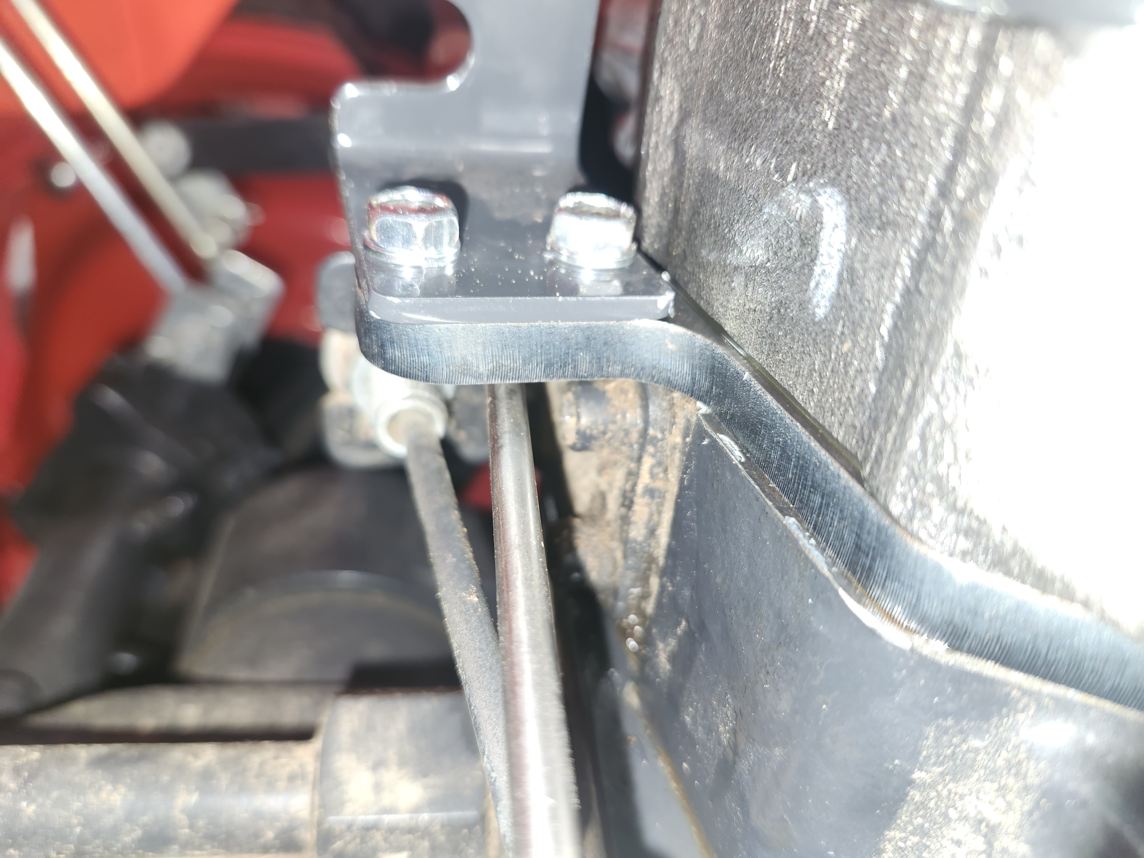

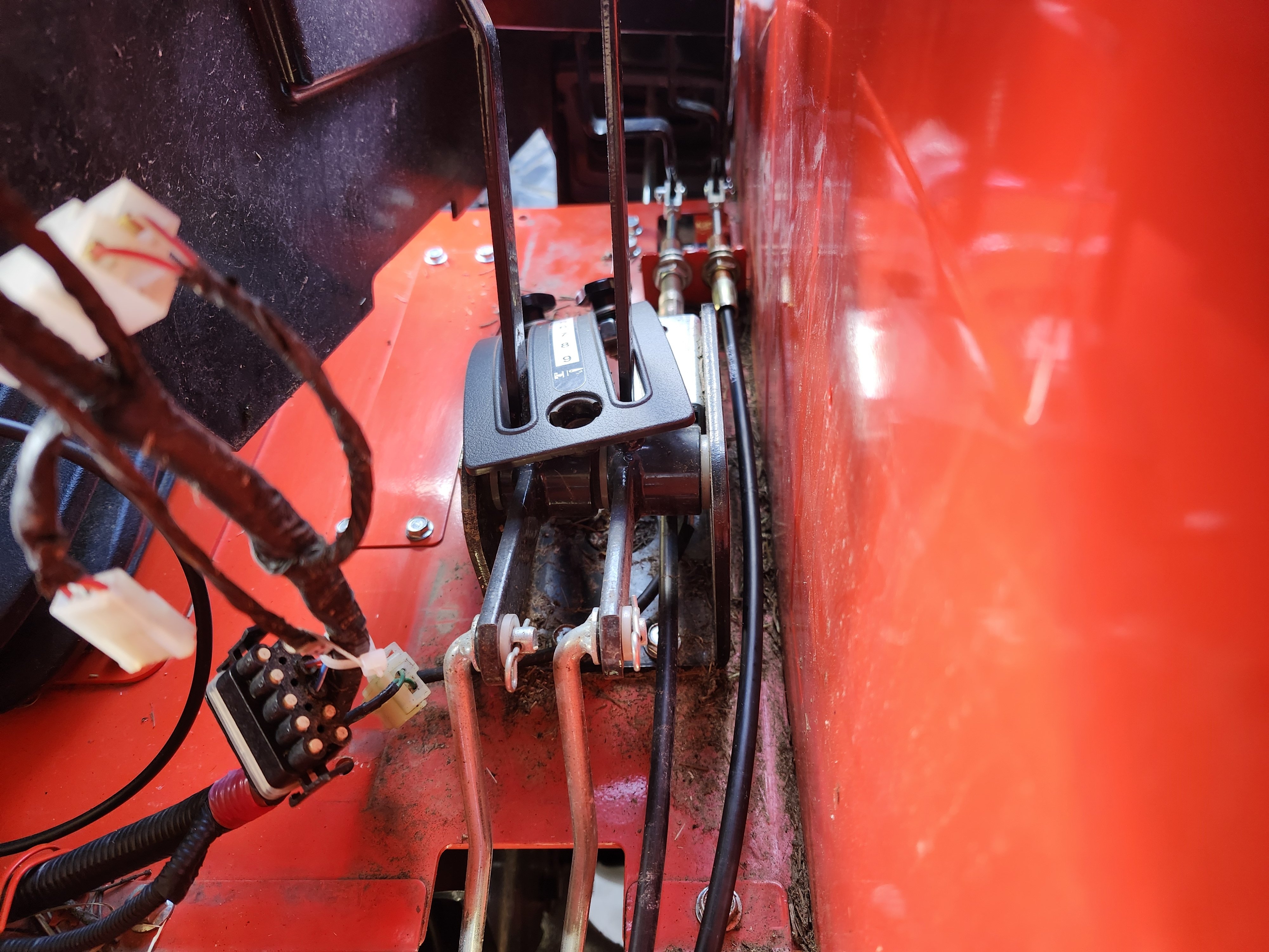

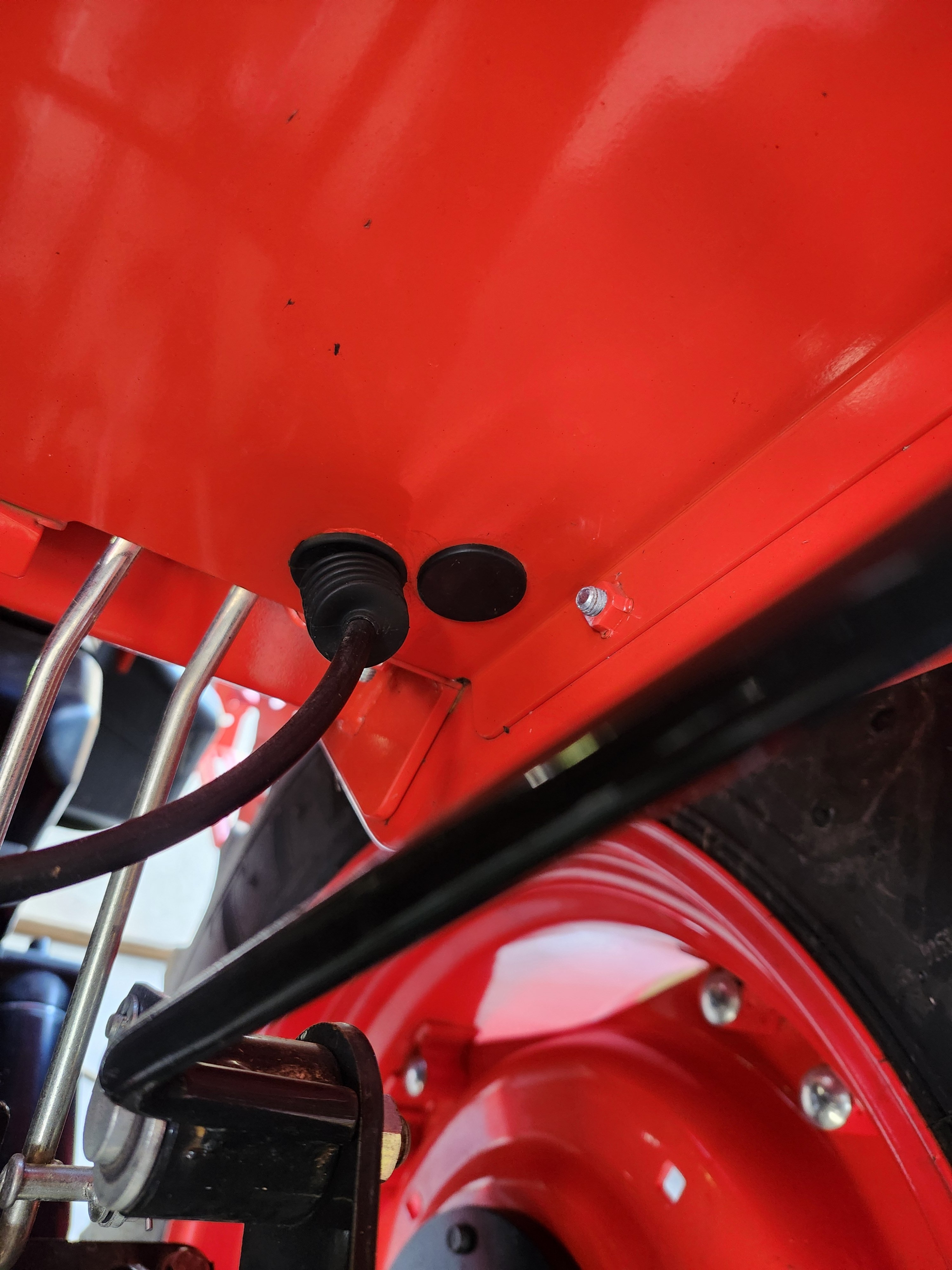

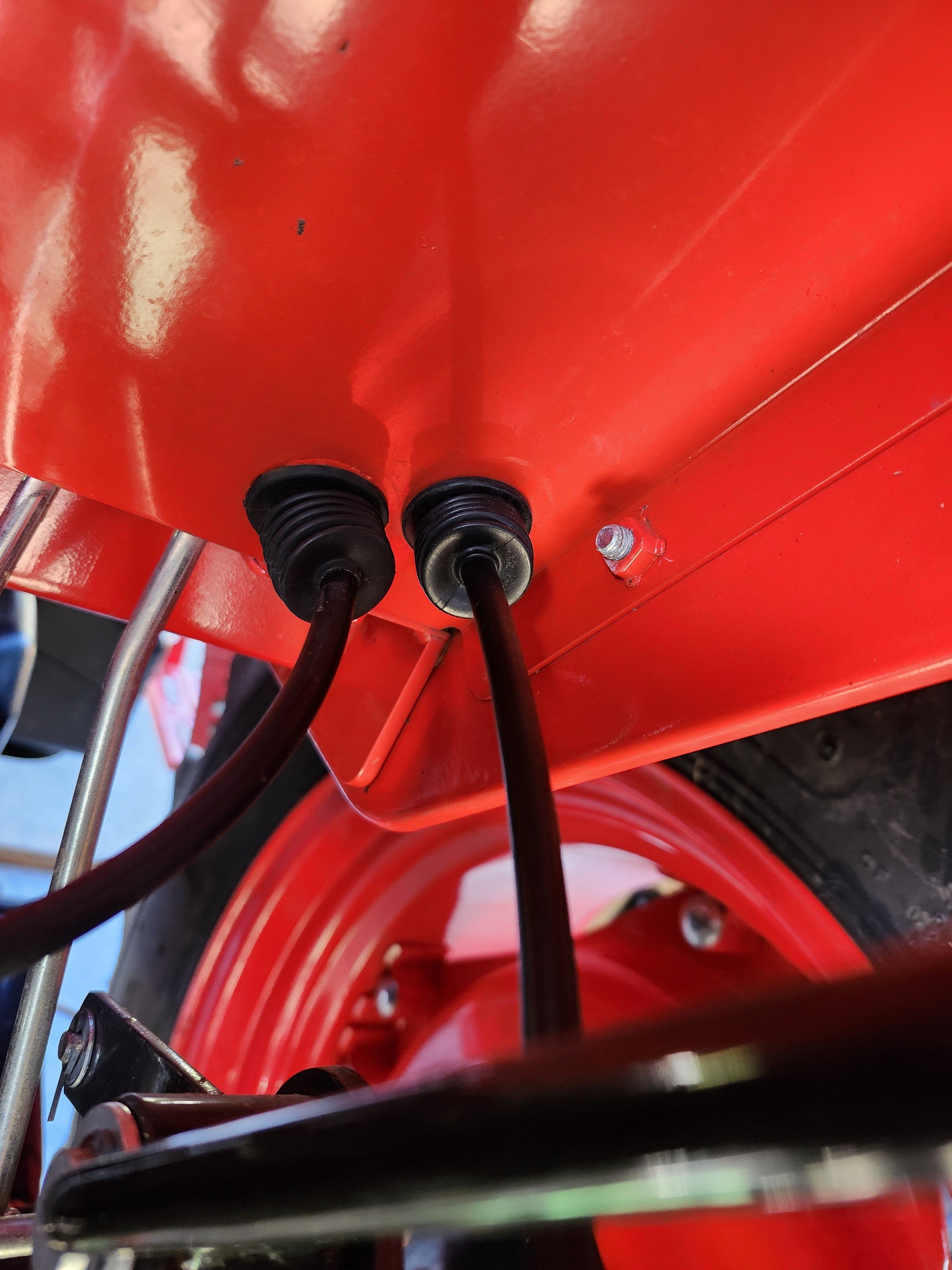

I then routed the cable through the back and bolted the sheath to the bracket.20250704_165732.jpg
I removed the plug.
The cable came with its own flex plug.
I had to use a 17mm flare nut wrench to tighten the nuts. There isn't much room. You can see this towards top of pic. Once this was done I removed the bracket holding the shift lever. I used a 12mm socket. I discarded the metal spacer and installed a bushing and the the shifter and reinstalled and tightened bolts. It took a little patience to wiggle the 2 handles up into place.
This shows the 2 bolts holding bracket.

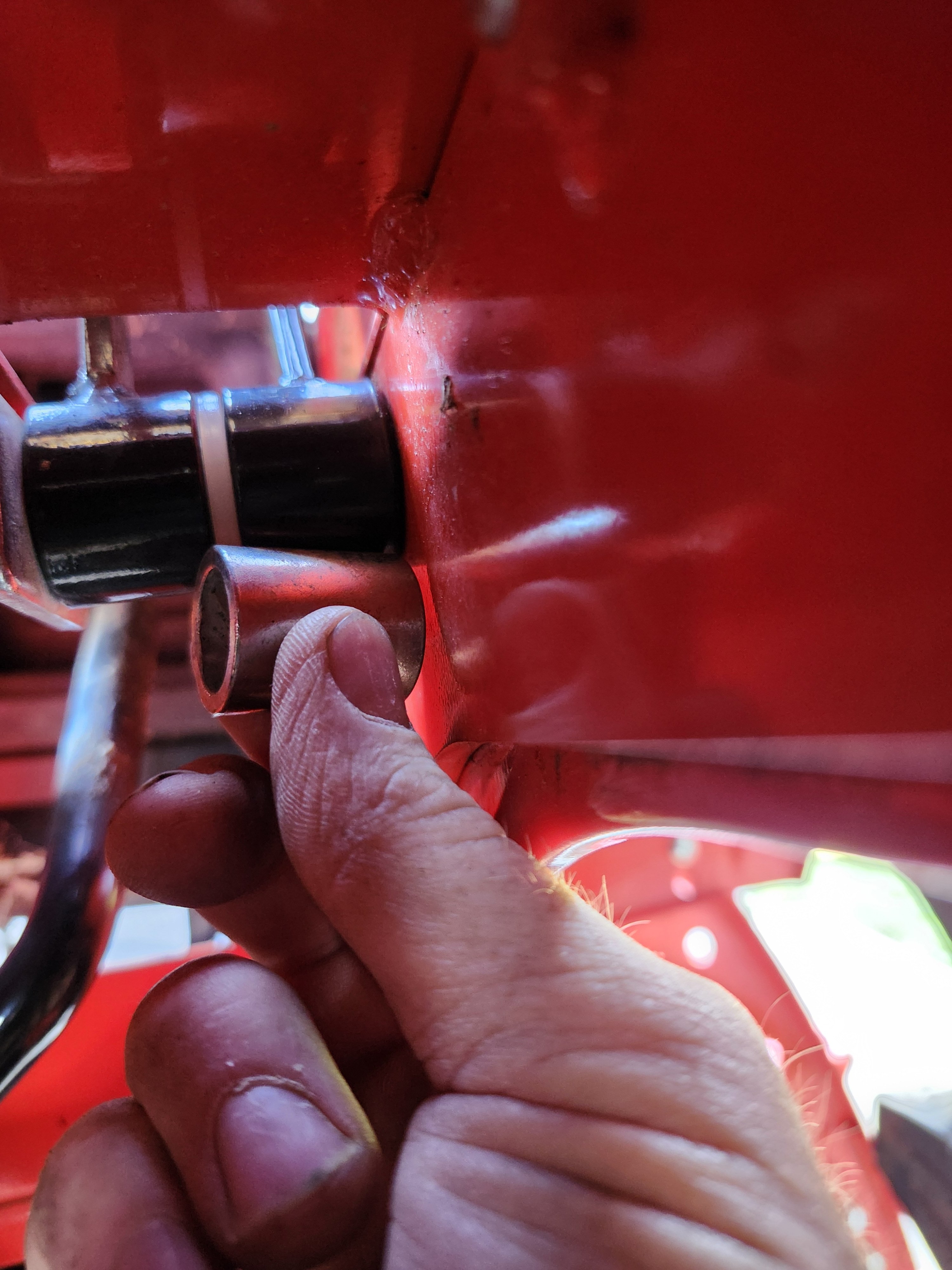

This shows metal spacer i removed and the bushing and handle that replaced it. After this I put a pin through the cable and handle to connect them, then put a cotter pin through end to secure it.
Once this was done I put the cover for the 3pt and draft back in place and then put all the bolts back on, making sure everything was OK. I then put both handles for the valve levers back on making sure I got colors correct.

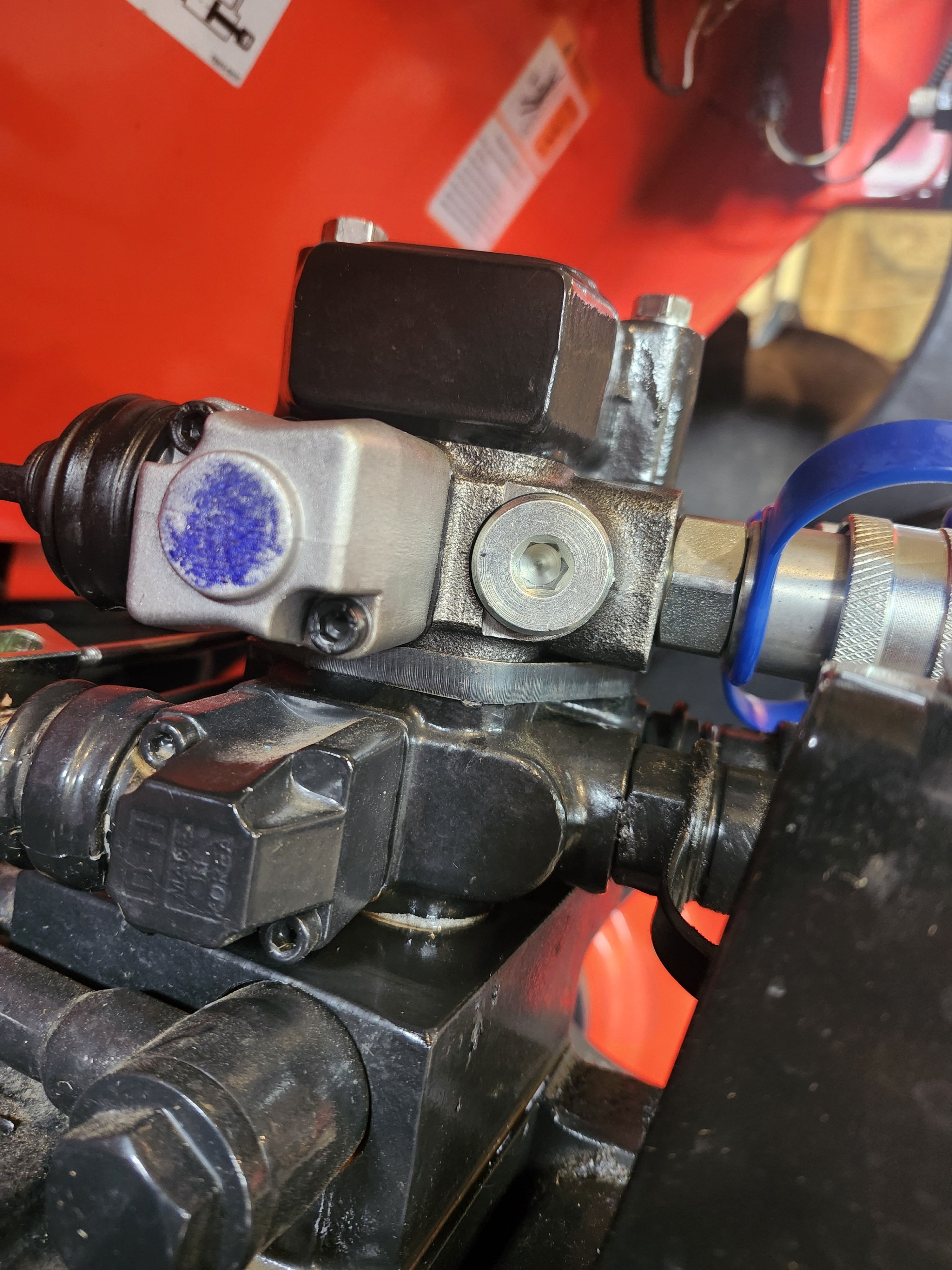

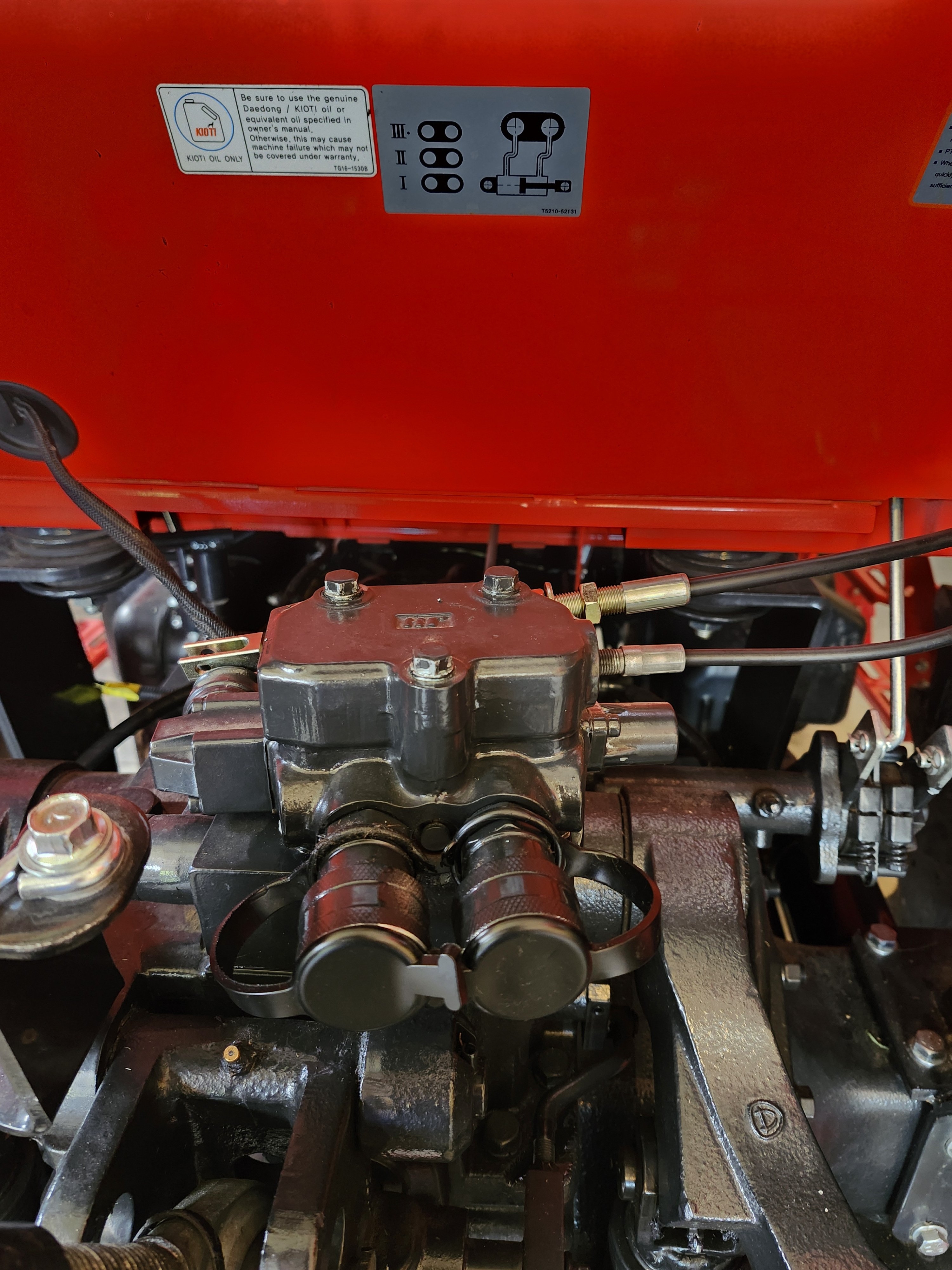

This shows top of valve cover. It has 3 bolts to remove.

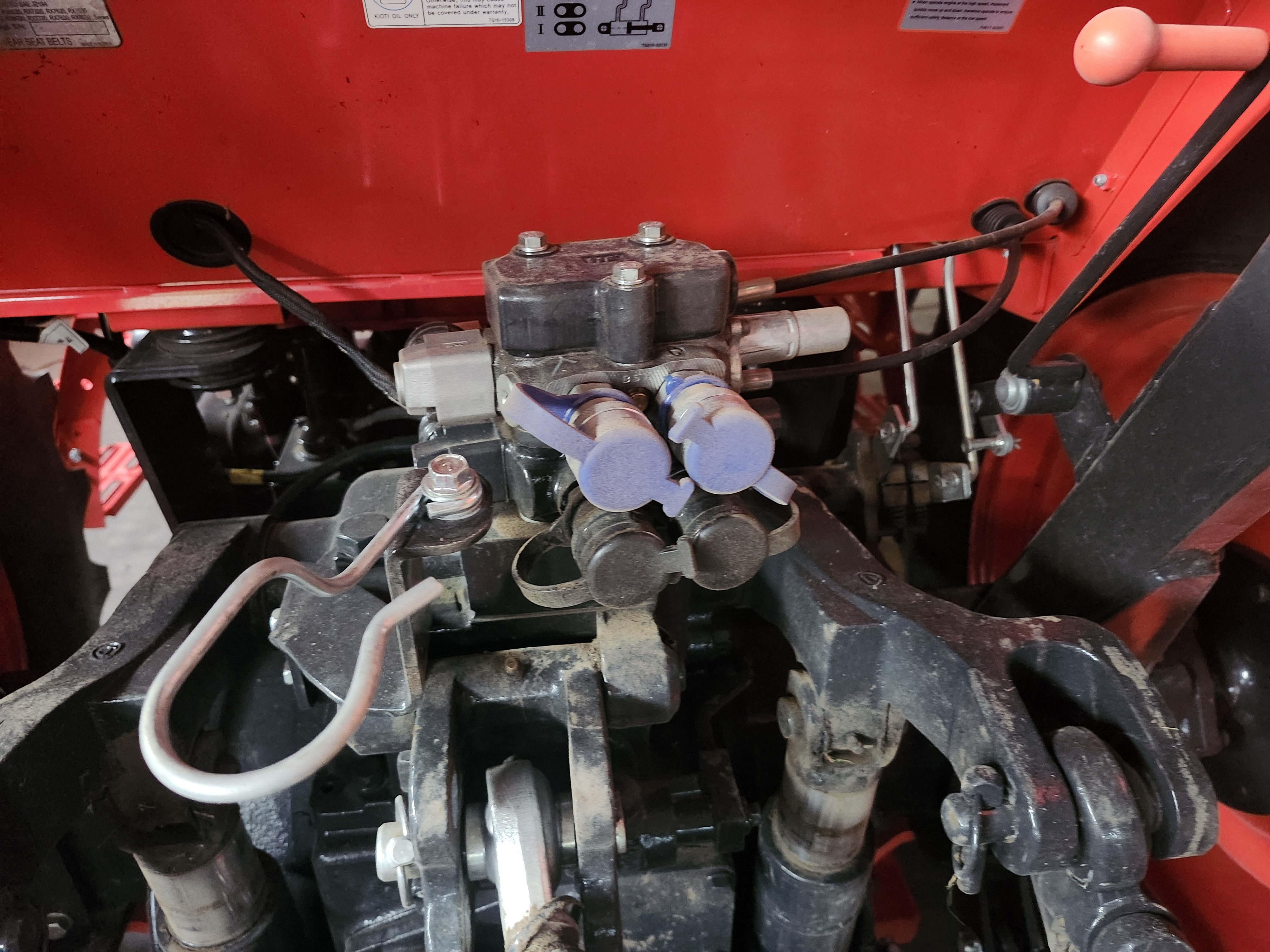

You can see in this image the thin plate that is sandwiched between the 2 valves. There is also a bracket bolted to this plate that locates the other end of the cable sheath.
I then assembled the connectors and plugs to the valve before placing it on top of the plate. I then reinstalled the valve cover with 3 new longer bolts included in kit. I then tightened the cable sheath to the bracket and attached the cable to the valve same as on the lever end. Done.
A few notes, it was tight working to install the cable and handle. There were no torque values. I just used my best judgement. The spacer plate and new valve have to be installed in specific direction due to o-rings. The cable was directional specific, so be aware of that.I found out there are 2 types of valves, at least for the RX anyway. Mine has a 3 bolt configuration. Some can have a 2 bolt configuration. So check yours if you plan on doing the work yourself. This is my 1st long instructional post. So I hope someone enjoys it. Also, this is to the best of my ability and don't take this as gospel!

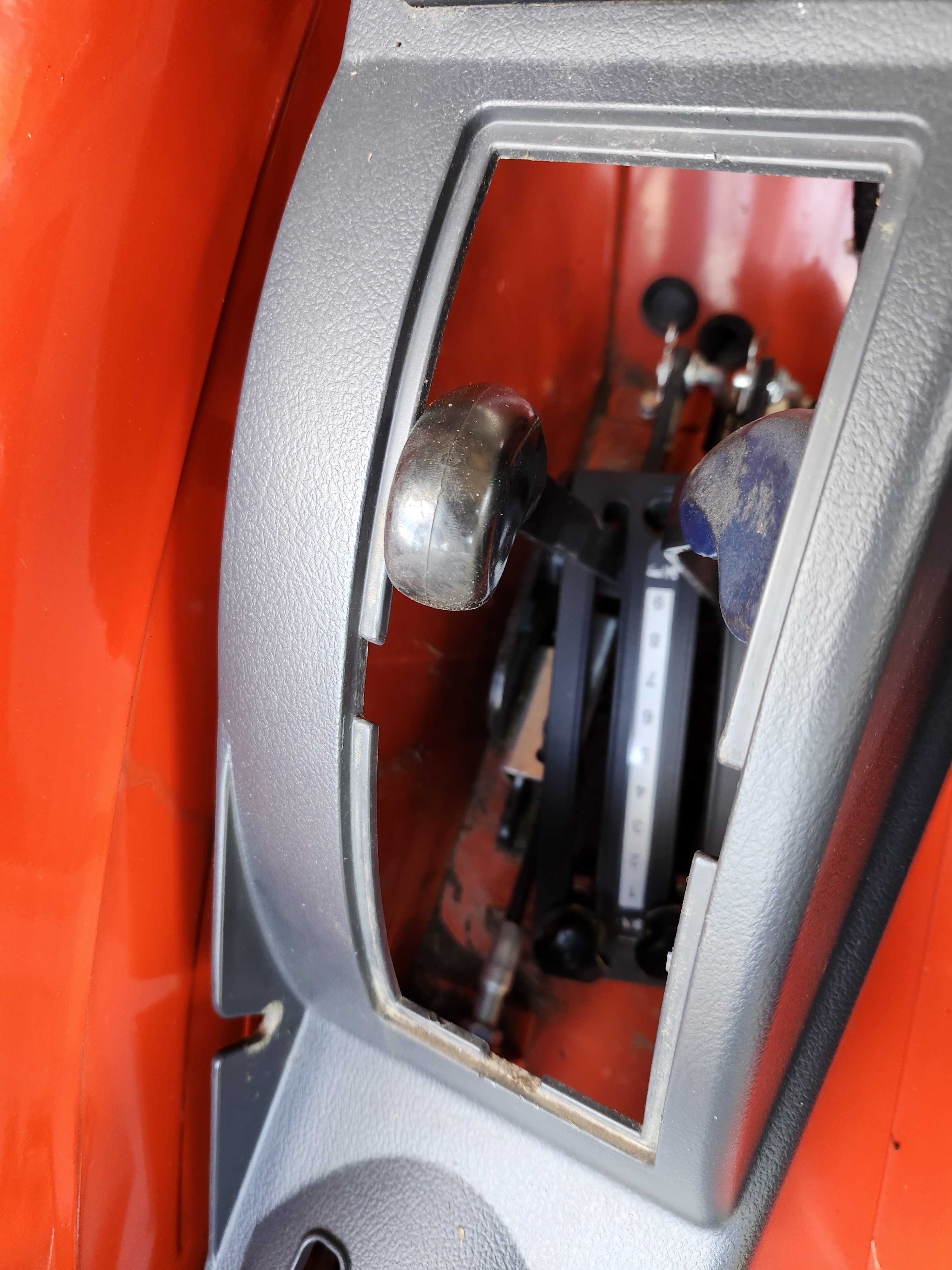

#2

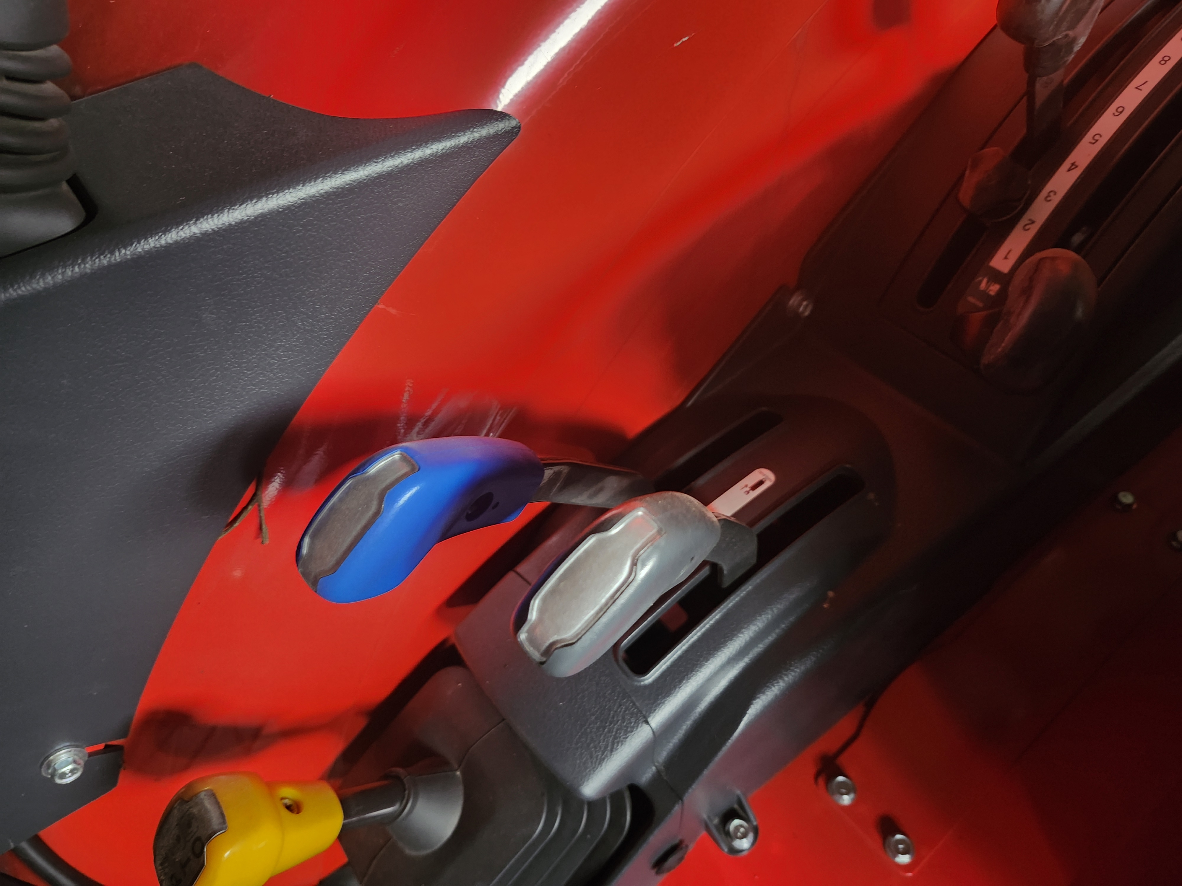

This pic shows both levers. Blue handle is the new valve.
This pic shows both valves. Blue plugs to differentiate the new valve. Also, notice again the thicker valve cover and 3 bolt heads.

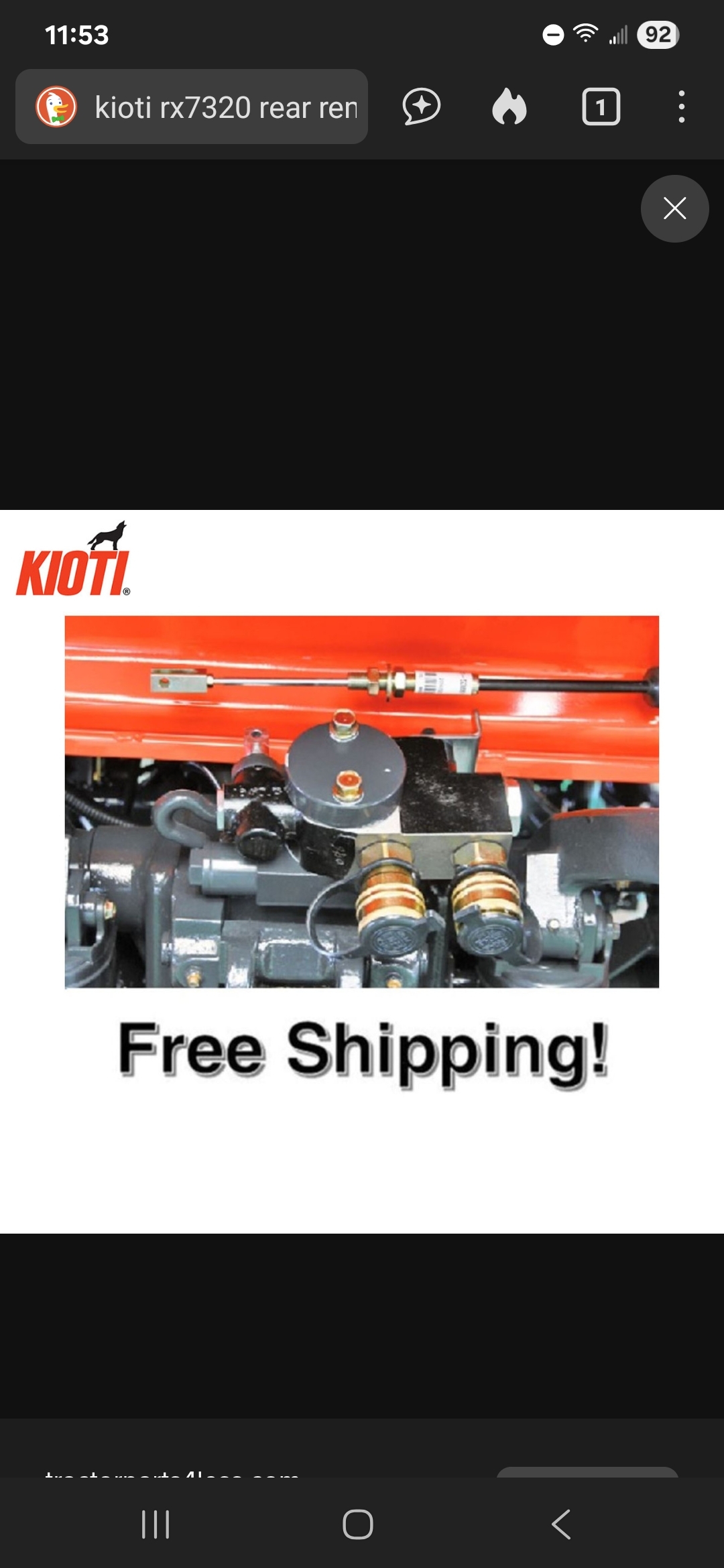

This is a pic I pulled off internet it shows the 2 bolt style with a small valve cover.
