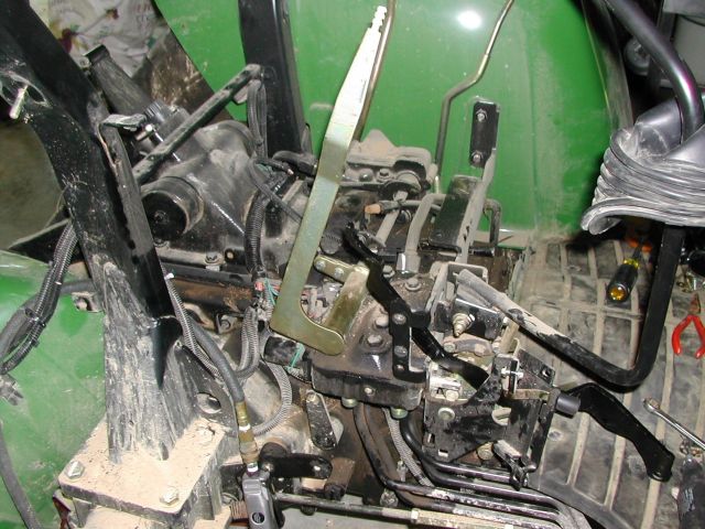

I started by pulling the right rear wheel and fender off as directed by the instructions. It also said to remove the seat assembly and seat panel. I figured I could get it in with out doing that and I was WRONG. I ended up removing a couple of things that weren't in the instructions.
As for the black grip on the 3 pt lever, I bought a new one at the dealer today and cut the old one off. After re-reading the instructions I saw that it said "remove rockshaft control lever" instead of the handle. They were referring to the other handle for the range shifter. However I did try to remove the entire lever last night but I rounded the bolt head because I could get the socket to seat right in those cramped quarters.
Attached is a picture of everything removed.

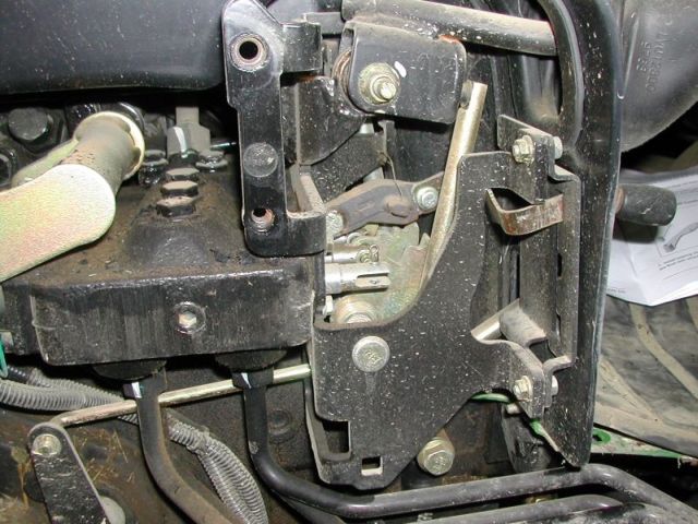

As someone has mentioned before, the 4310 already has the SCV, you are simply installing the lines, lever, and quick disconnects to it. Here is the close up of it.

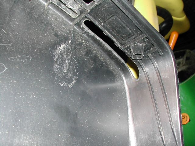

In my list of tools for the job I called out a Dremel. Here is why. A slot has to be cut in the seat panel to accomodate the control lever for the SCV. There is an outline of where you should cut impressed on the bottom of the panel. I used a Dremel with a cut off wheel to make the slot and then changed bits to make the round ends and finished up the sides with a file. Here is a picture from the bottom.

I discovered something else that needs to be removed. Take a look at the attached picture.
The two new lines are placed on the outside of the two existing hydraulic lines that come out out of Dual SCV. The line to the rear of the tractor has to be disconnected because the first line you install has to go behind it.

The lines will go in, but there are times that you will think that the guy who came up with those two bent torture tools was a sick sadistic John Deere employee. You have to really wiggle and push them and try different approaches to get them around the ROPS, existing lines, and wiring harnesses. But in the end it works.

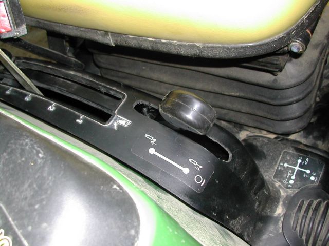

Last pic, the control lever.
