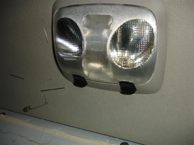

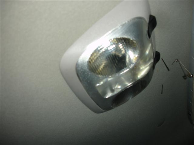

Just back from Sunday River tonight and had to run out to take a pick of the truck's headliner - Light was scavenged from Robertson's Auto salvage in Wareham, Ma - can't recall the model - great minds as they say if I could be so bold . . .

Forgot to resize the pics . . Here they are.
