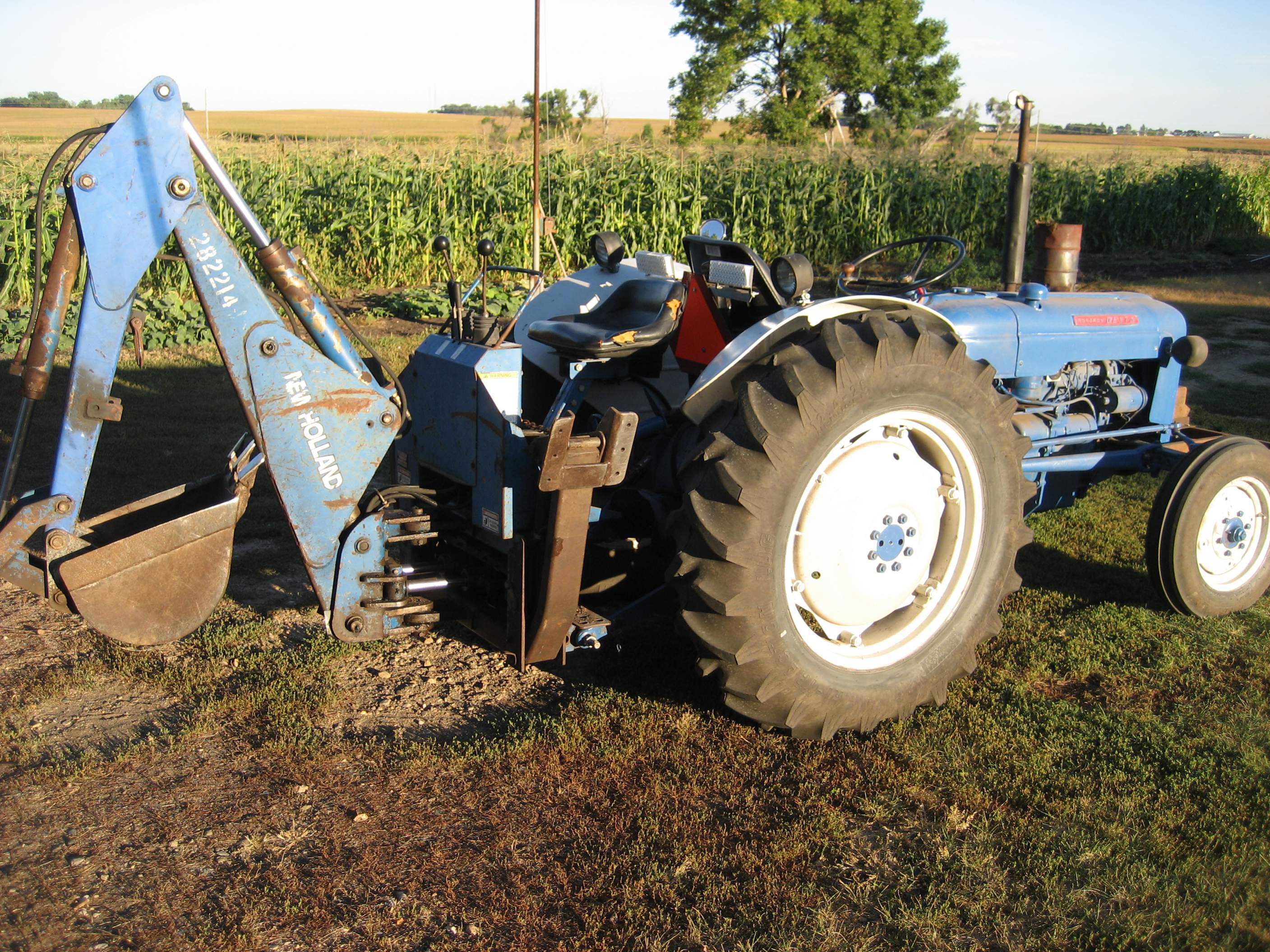

Soundguy I don't want to be a pest, but sometime when it is convenient do you think that you could take a couple of photos of how you mounted your hoe. It would be a huge help and I don't believe in reinventing the wheel.

That really turned into a nice looking combination. I hope mine turns out half as nice.
I don't see anything at all wrong with your work. :thumbsup:
I'm hopping the lower end of mine will be fastened to the loader frame. The loader is a Superior so the lower frame comes back to the axle on both sides. Your fixed third link is similar to the one that came with my hoe except that it ran down to the draw bar which we don't have. Yours looks like it would work just fine also.

good luck.
if you have a superior frame tot he rear axles.. deffinately connect to them.
I have a superior laoder on another tractor and thought very seriously about making that one the TLB.. but decided to do it to the 1-arm loader .. as the other tractor i use doing hay.. etc.

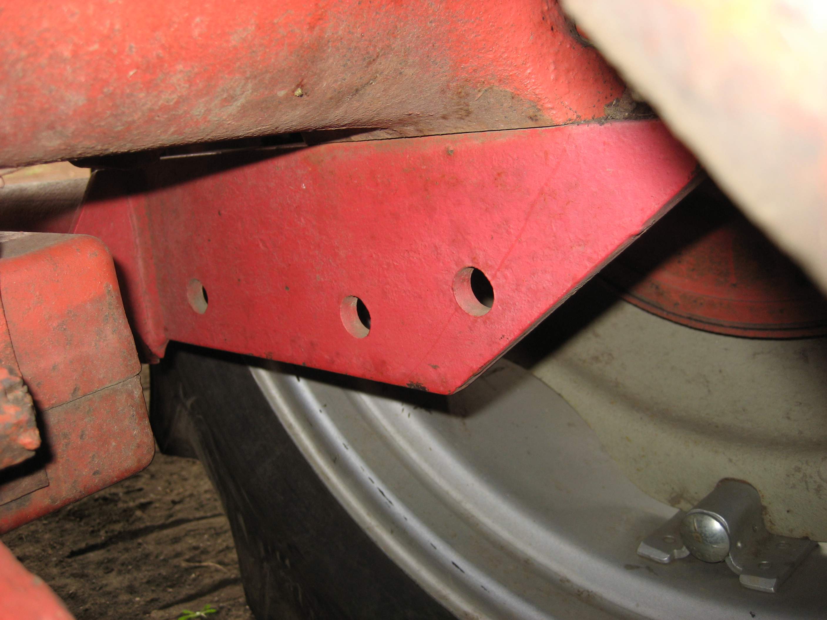

Here is what I have to hook onto. Looks like an excellent spot for it. The frame will extend forward of this point and attach there also. I can tell you one thing for sure, the tractor sure steers nice with the backhoe hanging on there now.

   / Installing a New Holland backhoe on a Ford 850 #9
yep. mine is plenty heavy with it's oil tank..e tc. and yeah.. I like the superior laoder under axle brackets. very beefy. will keep / help, from breaking the tracor in half if you hook a big rock or root.

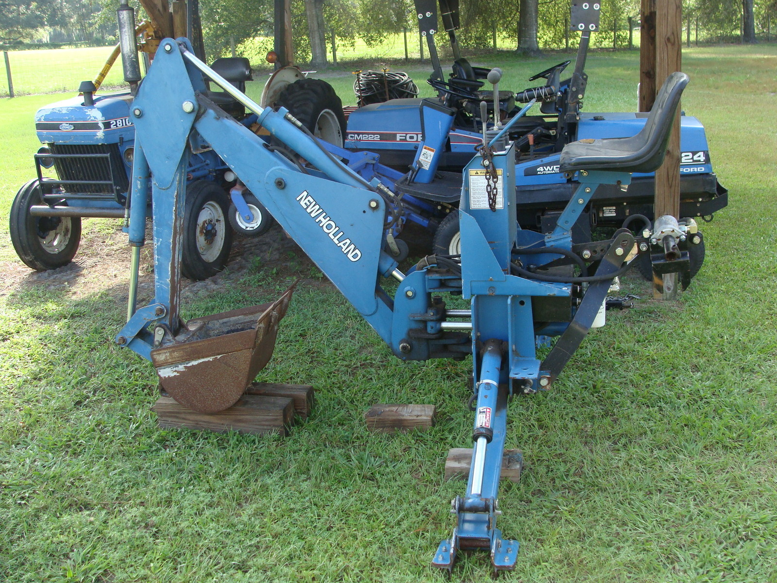

I was looking over your photos again and am wondering if your 3 point lower arms are still attached to the hoe?
Is your lower frame coming back from the axles angle iron (size?) or square tube?
I now have a PTO pump and a Farmhand oil tank from an F10 loader. I also plan on using the suction filter if the cartridges are still available.
Here is a photo of a similar hoe showing the third point attachment.
