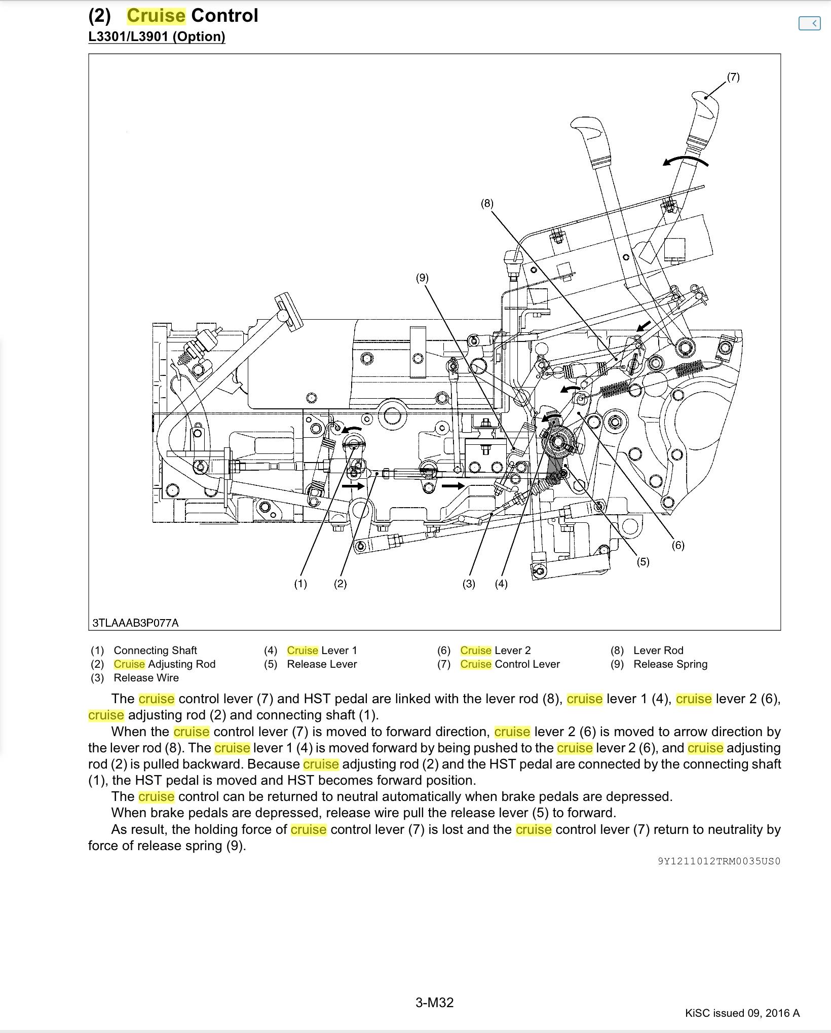

Hey folks, I finally broke down and bought the cruise control kit for my l3301 hst. The parts diagram was all I had to go by, and before I put the right floor panel back I tried to test it. When trying to test, it seems like the brake pedals weren't engaging the line to kill the CC. Does anyone happen to have the CC on their l3301 and by chance be willing to take some pictures of the brake connection and the CC "clutch" mechanism hookup?
   / Installing cruise control on l3301 #2
From the WSM for your machine.

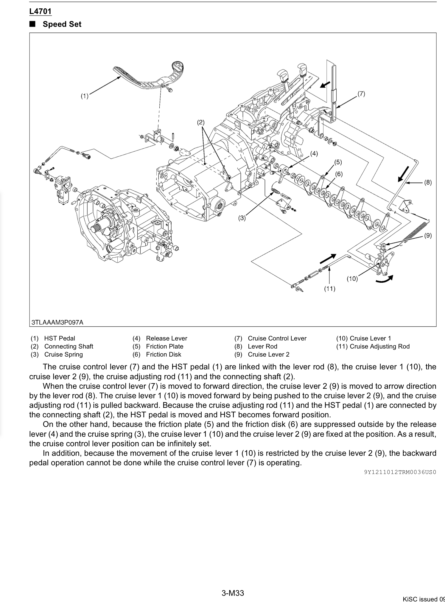

   / Installing cruise control on l3301 #4
Not a view from the right side, but the only other page in the section on cruise control from the WSM. Hope it helps.
