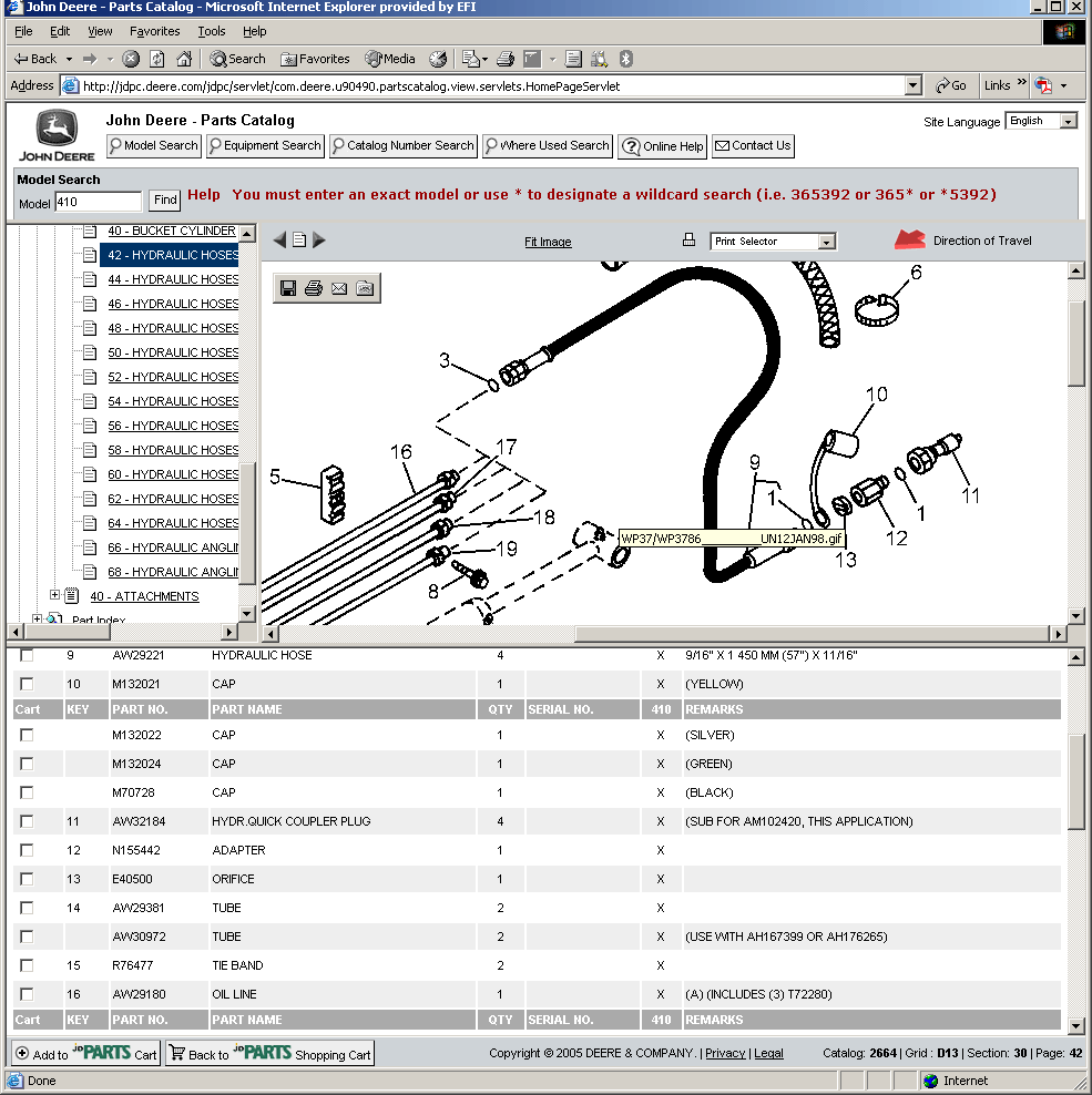

</font><font color="blue" class="small">( execpt for the boom lift line which gets a special flow-control oriface to keep it from dropping too fast.- Rick )</font>
I have a 4100 with the 410 loader. My arms drop very fast. Where would the orifice be located? Maybe mine is missing? Is it between the hose and disconnect?
   / installing FEL on 4110 #6
Its goes in a fitting that is put on the end of the hose before the quick-connect.
Parts 12 and 13 in this drawing. Note that the quantity on these parts is 1, while the quick-connects qty=4.
- Rick
