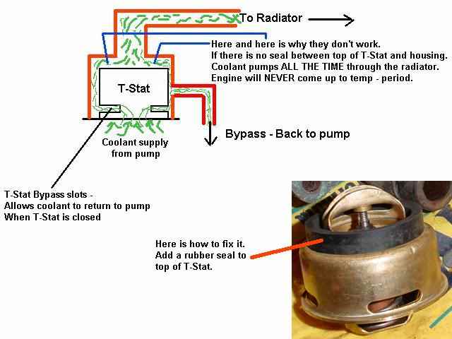

Thanks for the graphic Tommy, that was well done and easy to understand.

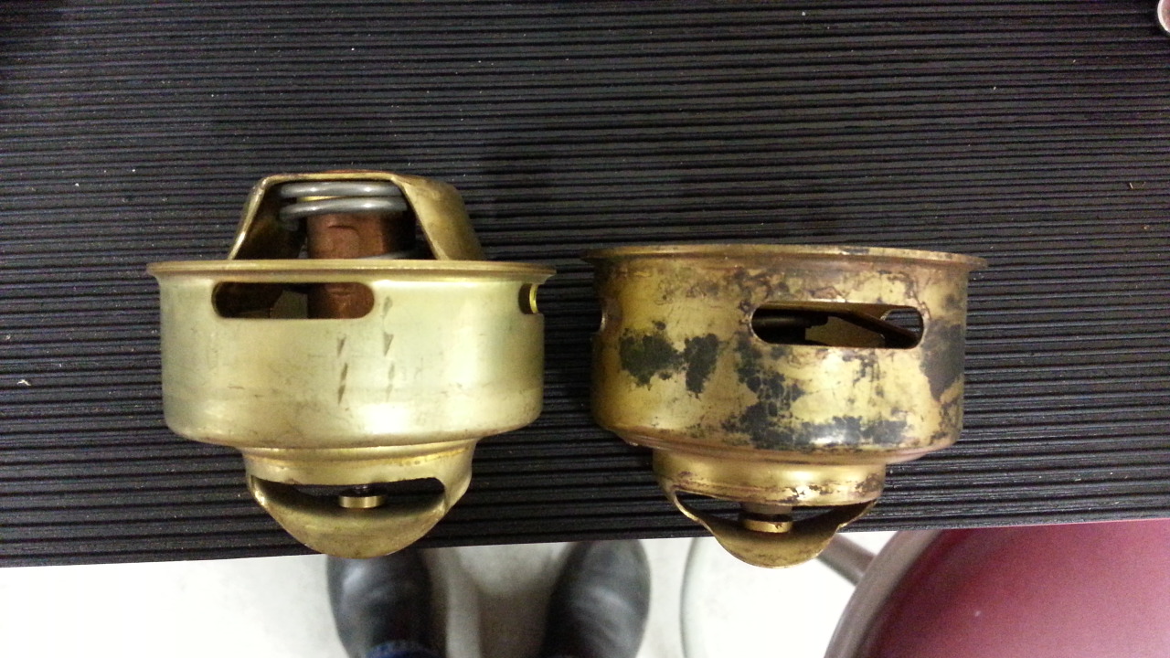

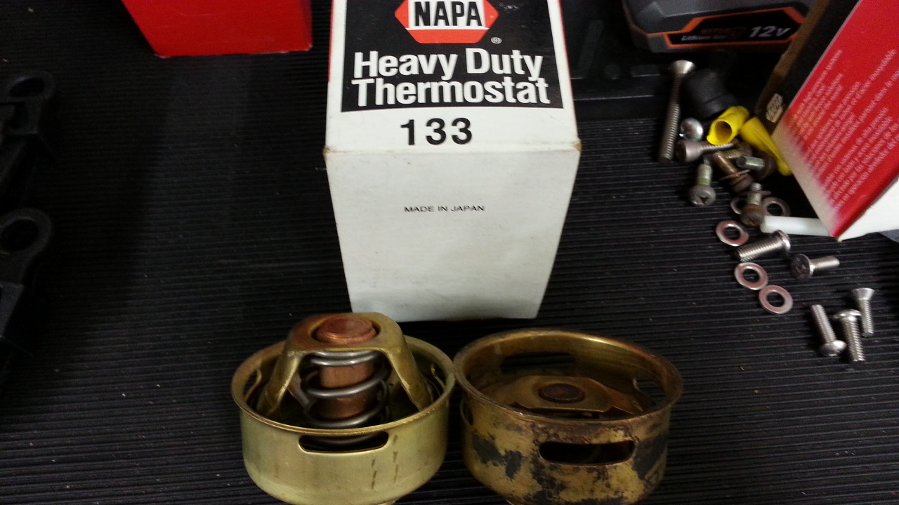

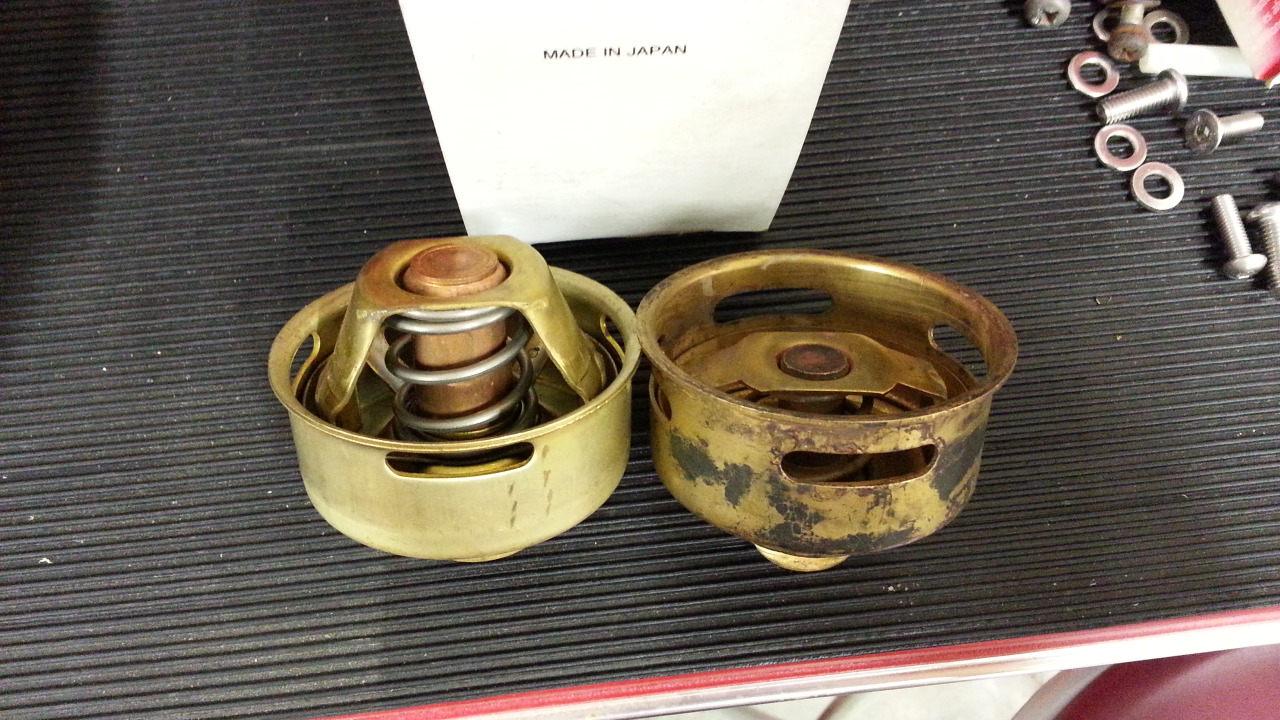

I'm merely relating personal and hands-on experience with four different Chinese tractor brands Bob. I generally don't try to "improve" upon mechanical engineering decisions. If I take out a 75C thermostat, I replace it with a 75C or Fahrenheit equivalent. I've changed thermostats in Foton, Jinma, KAMA, TaiShan. No two thermostats were the same. In fact, the two seemingly identical JM254s I had didn't even have the same thermostat. I attributed that to them being from two different generations of the Y385 engine. As stated, the originals removed were 70/75/80/85 (centigrade). An 85C is indeed 185F, but as I said - it's at the top of the range. Hence my suggestion to BJR regarding the temperature stamp on the thermostat he removed.

No worries Greg. My experience and education on diesel engines encompasses just about everything under the sun except Chinese tractor engines. My hands-on Chinese experience is limited to my little dozer. However, given that I have studied and worked on a myriad of heavy equipment in my 55-plus year working life thus far, I see striking similarities and certain engineering rules that are followed between equipment manufacturers of various countries. Emerging technology is a wonderful thing, and for the most part can be retro-adapted. There is nothing really wrong with a conservative approach to repairs other than you are not improving anything, and possibly propagating an undesirable/bad situation.
