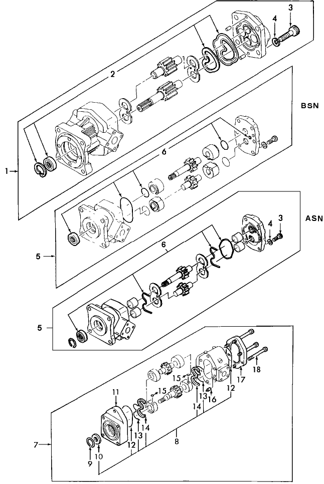

How do you think that 3pt hitch raises? magic? it uses hyds!! :) :)

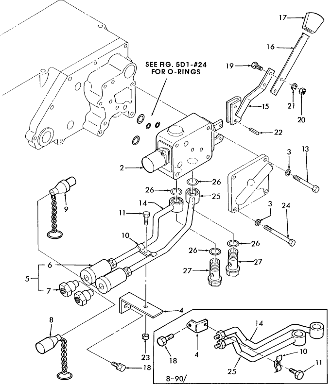

there should be a valve block on the right hand lower side of the tractor.. engine area.. this is where you can tap hyds from.. like for a loader.. or DIY valve.. however.. you can add a factory remote as well.
1920 4 CYL COMPACT T / 05E01 REMOTE CONTROL VALVE & PIPING KIT - 1920

Here is the simple version.
Your tractor has a pump, reservior, relief valve and diverter valve from the factory.
You can add a single spool rear remote valve to operate one function at the rear of the tractor. It comes with decent instructions, and can be installed with common hand tools and a reasonable amount of mechanical aptitude and common sense.
You can also add a mid mounted two spool valve with couplers to control a front or mid mounted implement with one or two hydraulic functions. The kit comes with instructions and can be installed using common hand tools and a reasonable amount of mechanical aptitude and common sense.
Or you can have either or both installed using only a checkbook. Nothing else required.

that's just a parts listing for the remote kit that cnh has, along with the exploded diagrram of it with coresponding numbers. i also tossed in a pic o fthe hyd pump.. so he knows he has one.. :)
