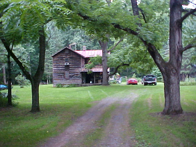

Howdy,
This is a bit of a stretch to be asking of y'all, but I haven't had much luck getting info, so here it goes.
I have an old (100 yr.?)sawmill shanty farmhouse with a hand dug, dirt floored, rock walled root cellar(basement) under the kitchen area. Unless we're nearly in a drought, it is wet down there. During rainy times, there is actually a stream running through it!
About 20 years ago, treated joists were sistered onto the rotting existing joists and things seem to be pretty stable down there aside from the moisture.
The joists I speak of are the floor joists of the kitchen, and there is no insulation whatsoever between the cellar and the kitchen. I would like to add some, but am afraid of what the moisture will do to whatever insulation I put down there and certainly don't want to trap moisture or cause even more damage than is being done by the wetness already.
Does anyone have an opinion on what the best approach might be for insulating the ceiling of the cellar?? Or a link to a good old house website?
I figure if anyone would know, it would be this group!
Thanks !
Tony S.
*edit: Attached photo is just a distant shot of the exterior.

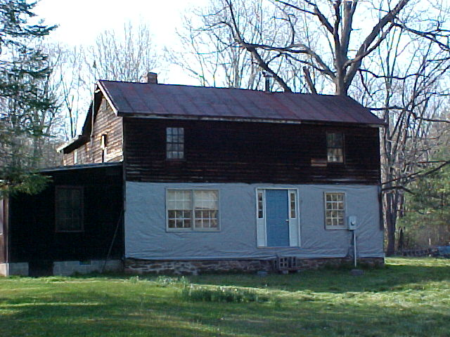

P.S. Photo shows front of house....definately a work in progress...except that I'm not making much progress!!

I see a brick flue in that picture. What about a wood stove in the basement to help with heat in house and drying in basement. Could be vented out that smokestack (or is that a fireplace). Wouldn't do much for you during summer, but that's still a while off.

BTDT, now that is a good suggestion, except that the flue doesn't go all the way to the basement. Believe it or not, the chimney stops just below the first floor and is resting on WOOD cribbing!! Looks to be 4x4 blocks about 24" long crossed atop each other. I've been in quite a few crawl spaces in my life but have never seen anything like this. It's probably been like that for 100 years, so I guess it is good to go. By the way, it comes down on the opposite side of a bearing wall from the cellar, in the crawlspace area under the living room. So, there would be no practical way to plumb a woostove in down there, and the entrance to the cellar is a horizontal trap door on the porch that makes access a pain. Great idea though!
Oh, the smoke stack you see on the right in that picture is an unused metal stovepipe from long ago that has never been completely removed. It stops inside the attic. Years ago that pipe went to a pot bellied stove that stood in the middle of the living room floor. At the time, the living room encompassed the entire downstairs area except for the kitchen. It was more of a hunting/ social gathering cabin at the time, but since then a partition was added making 2 rooms and leaving no place for the pot bellied stove or the pipe. I sure do miss that stove.
