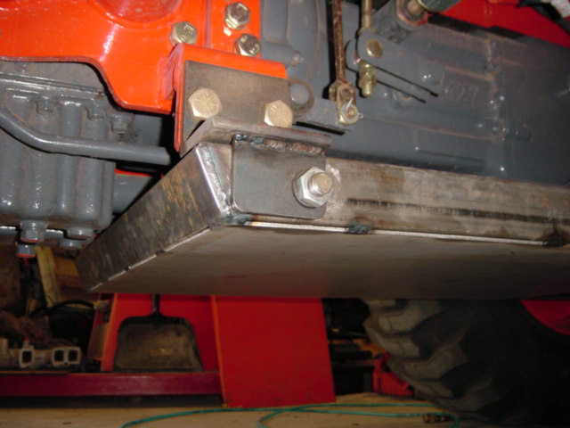

Thanks for the link, my next project is welding on a 3/8" chrome moly skid plate to protect the undercarriage.

mmmmmmmmm....chrome moly......mmmmmmmm /forums/images/graemlins/grin.gif
Uhmm,
Do you think 3/8 is thick enough?
Nothin like huntin rabbits with a grenade launcher... /forums/images/graemlins/grin.gif
   / Interesting Article...Farm Tractor Logging... #5
I'd go 1/2 inch armor plate. /forums/images/graemlins/grin.gif

Nice job, I just happen to have some 3/8" 4130 here and it welds real nice, so will be setting up something simiilar to your install soon when it cools off a little this fall.
