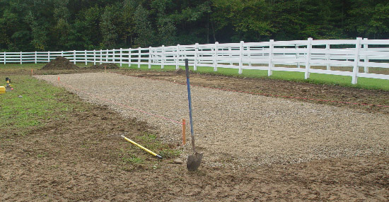

Well, i'm putting my new toys to use constructing a run-in shed for our winter pasture! We had these cool galvanized modular horse stalls in our barn and while originally we had planned to build from scratch, I found out there was a roofing kit for 'em, so being the cost concious fella I am i figure I'm gonna haul 'em out and build it that way....

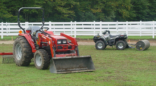

First scraped out the dirt a bit and put down a few inches of fine (1/2") driveway gravel to avoid the mud season. Used the box blade here to scrape, the FEL and backwards landscape rake to spread the gravel. Raked the area by hand to level it (see laser in picture at left) and rolled it with the Quad and lawn roller, then tractor with a full bucket of gravel to finish. Packed down pretty well!
See attachment for finished grade....
So far pretty fun! /forums/images/graemlins/smile.gif

Here are the tools of the trade for today!!! /forums/images/graemlins/grin.gif

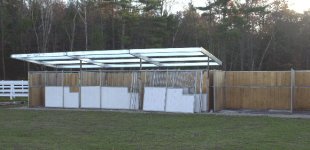

Next step is to move the stall walls. Pretty heavy suckers, probably 500 or 600lbs each. Couple chains on the FEL and out they came, took 'em down to the pasture and placed 'em together in two sections of three each (thats how the roof kits will come). Even painted 'em white to match the house! This looks easier than it was, but still beats bangin nails....

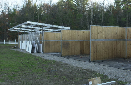

Got the walls up and put in these heavy rubber stall mats to keep the gravel out of the "kids" hooves, then the roof came! Talk about steel! 15' 12 gauge beams kinda heavy 150-200lbs each for the sides, lighter for the crossbeams. Took a steel pole that used to be a fence, drilled and bolted a heavy eye hook to one end and shoved the whole thing onto the end of my bale spear to make a boom pole (ah, science!) Worked perfectly to lift the beams into place so I could bolt 'em onto the steel roof supports. The cross beams were light enough for two people to lift in and bolt together. Sunday I will finish the roof beams, put the fronts on and start on the roofing. It is a metal roof (red, to match the house, CFO's orders!) I'll post more then..... /forums/images/graemlins/smile.gif

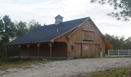

Ha! Good question! We have two other barns, one attached to the house, and a new one across the access road, each with new stalls and pretty nice. The old barn was mostly for horses we don't have anymore (adopted out) and the new barn has built in permanent stalls. So they were just sittin' there........ I have six more for the other pasture (spring time project!) and the old barn now houses hay, implements and tractor!
See pic of new barn.... /forums/images/graemlins/smile.gif

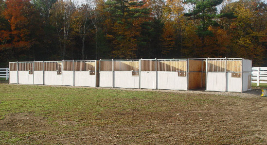

Here is a better shot of the stalls to show the inside and assembly...
