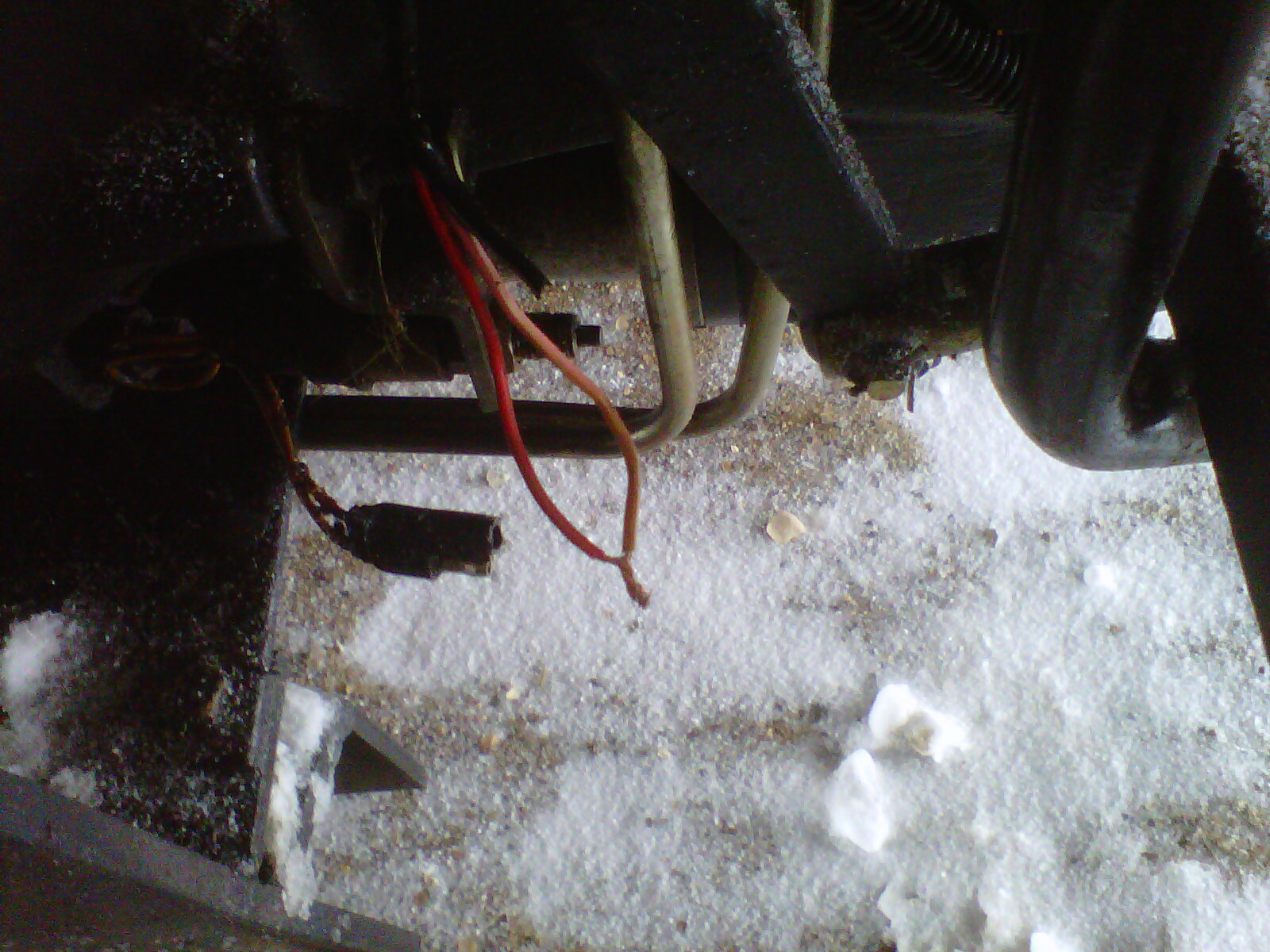

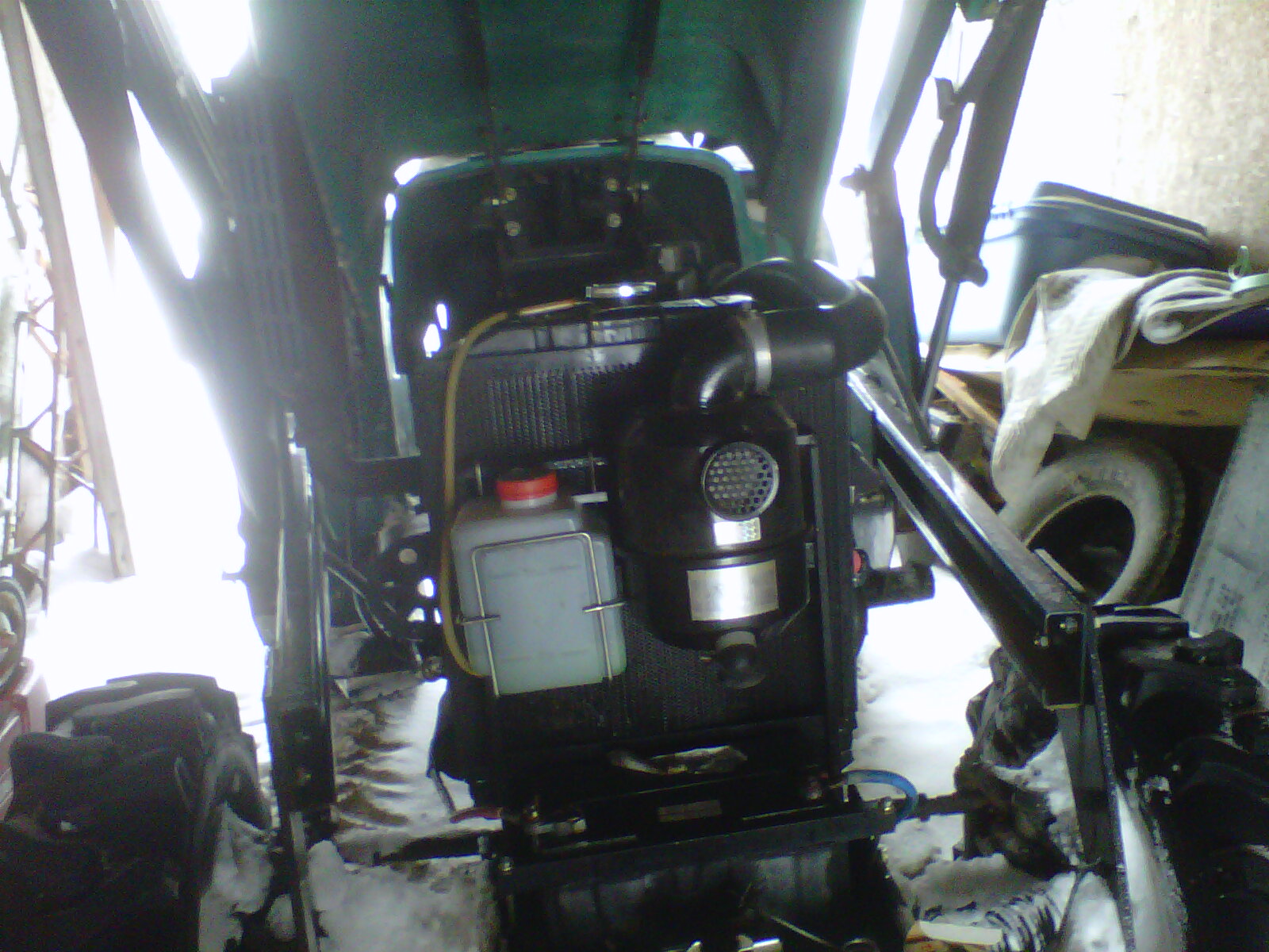

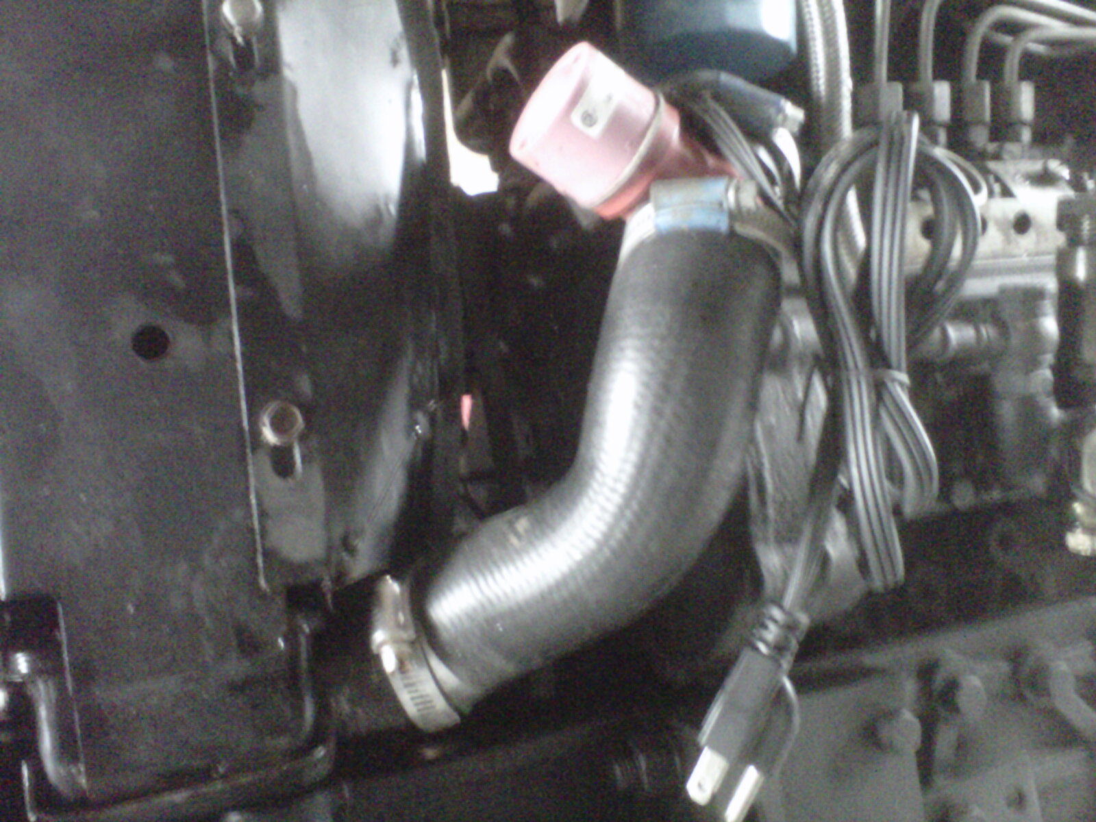

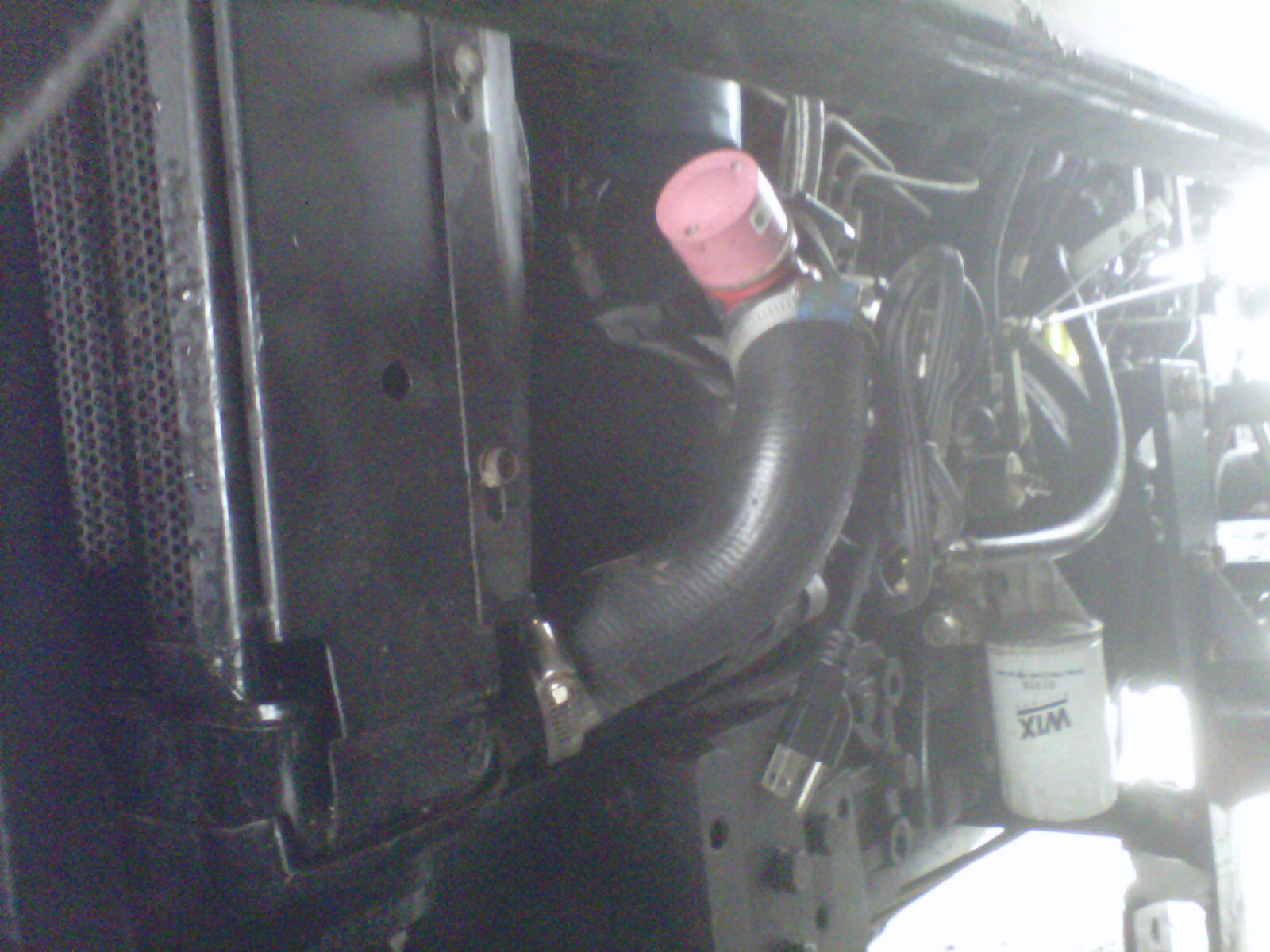

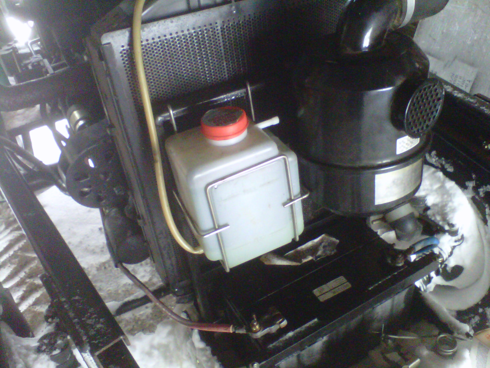

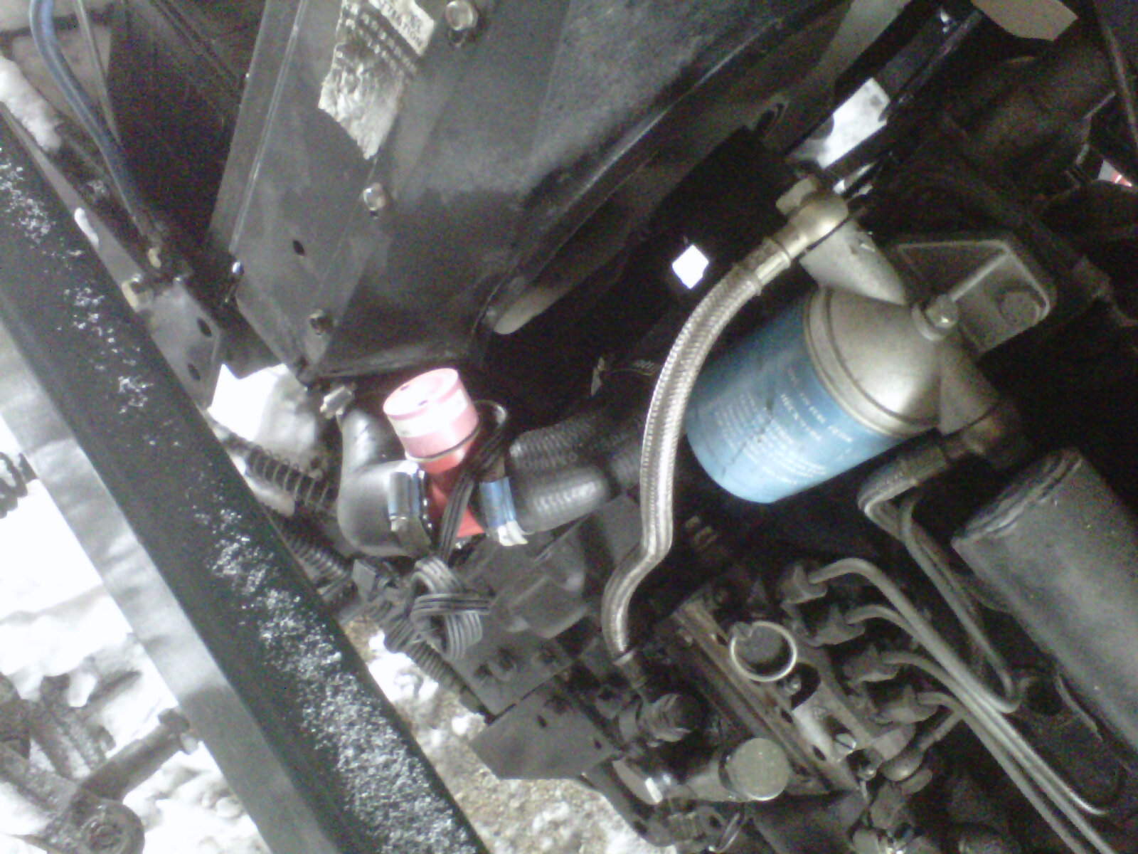

Came back looking for info, and what do you know ran into my own thread. In search of a radiator cap, so once again your info is helpful. Will head to napa in the AM and pick one up. Hopefully it matches up. I could not use that bottom hose listed, mine was a "S" shaped hose and did not line up like that at all. My intake sits much higher than yours for some reason. I will try and take a pic tomorrow and show how it all worked out. I did add a overflow catch. Worked great for a couple years and eliminated that air pocket always present in the radiator. Until this week.... one trouble after the next. Our winter has been brutal and my poor tractor has been working hard. I am hoping this rotted out leaking rad cap is the problem, and not the dreaded head gasket or worse.

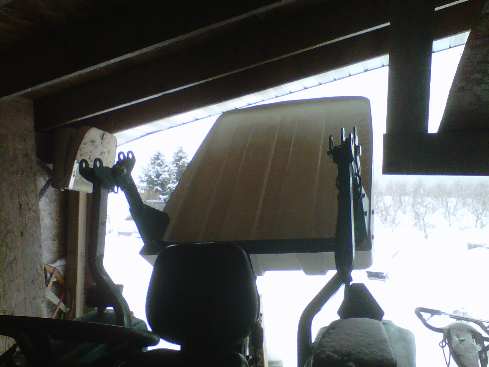

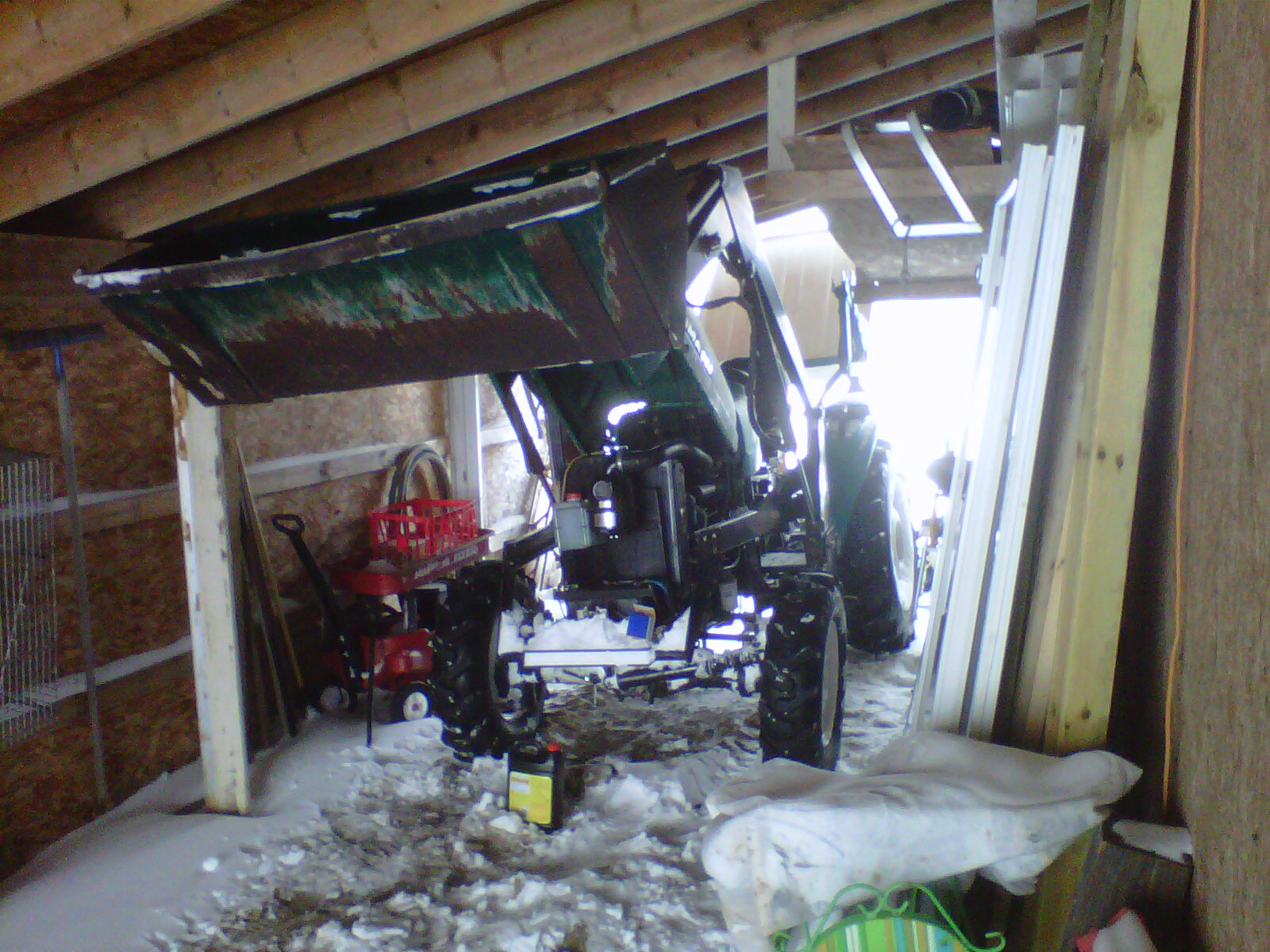

Summing up my week: headlight bulbs broke loose in cheap plastic holders, melted plastic and caught on fire. radiator cap is shot, hopefully only problem and not a head gasket. safety cut off switch that clutch contacts is water logged or fuel logged or just plain crap. Finally just cut the wires and wire nutted together to get started. O rings in fuel filter disolved. I tore that down and rebuilt it with all new rings. No leaks and and works great. BTW, there is no "reserve" on the fuel cut off on this, it is on or on, up-down, off is horizontal, but there is no reserve. To top it off, I park under a lean-to, and have to fold my ROPS down behind the tractor to fit under the roof. I was warming the tractor up and went into the garage to get something and heard the most awful crunching sound. My three point with the multi hitch was at that "just right" point and raised the hitch up, right through the roof of my ROPS. I now have a nice big hole through it. Yeah, winter can go suck eggs.

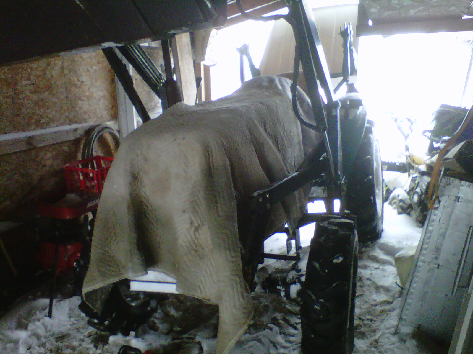

Couple of pics. Shows my lower hose, upper hose and new cap. My fun winter wiring. And the girl tucked away for the night with blankets to warm up. IMG-20140201-01342.jpgIMG-20140201-01334.jpgIMG-20140201-01335.jpgIMG-20140201-01336.jpgIMG-20140201-01337.jpgIMG-20140201-01338.jpgIMG-20140201-01339.jpgIMG-20140201-01340.jpgIMG-20140201-01341.jpgIMG-20140201-01333.jpg couple pics.
