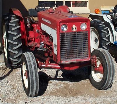

You amaze me Mr Miller! My 454 resembles the IH 2424 but is considerably more streamline. I'm looking at the picture to see if there are any loader mounting areas. The 454 has massive, I mean massive loader connections points. I have a 1972, IH 454 D with about 1600 hours total time. While the 179 cu in diesel is only 3 cylinders, it is very smooth and loves to be lugged. I often mow with a 84" finish mower with the 1000 RPM PTO but at half the engine speed, thats about 1100 emgine RPM. Because of the slow engine speed, I mow in 4th or 5th gear even on the hills. Thanks for the information, Rat...

That's great info on the differences in models. This 424 has a really stout loader on it. Of course the tractor has been burnt, so all the cylinders are suspect. Rat, we get up to Auburn all the time delivering tractors, the next trip is Tuesday. Nice area! Stop by some time and check out the toasty 424. Dave
