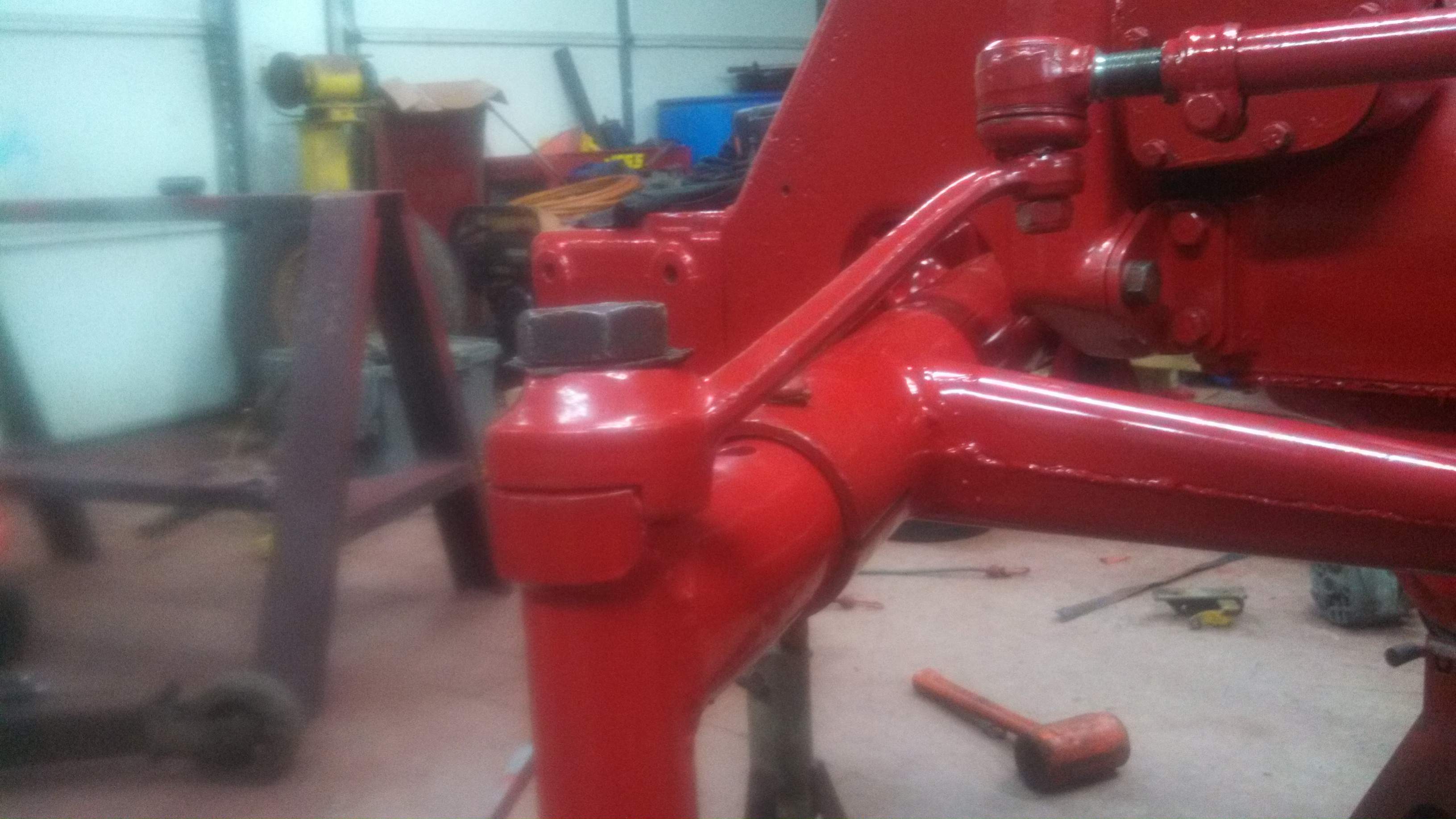

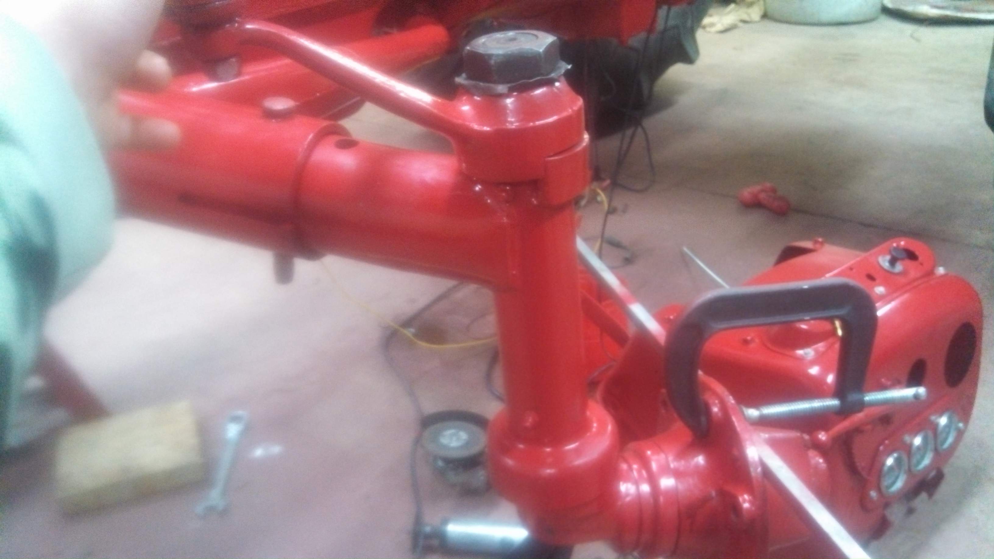

This is the left spindle as viewed from the tractor:
Here, the wheel is turned hard left and the axle is level. You can see I am against the stop. So....the axle cannot raise up on this side if it needs to, unless the tierod pushes back against the steering box.
Here the wheel is turned hard right. Again, axle level and against the stop. So The axle can cannot drop into a hole if needed without trying to pull on the steering box.
Same deal on the other side. In that first pic, the axle cannot raise if needed, but is free to drop all it wants, but the right wheel would prevent that. In the second pic, the axle is free to raise if needed, but again, the right side is into the other stop.
So...when turned hard one way or another, one side is preventing the axle from pivoting one way, the other side prevents pivoting the opposite direction.
Its like the gearbox has too much travel. I dont think it should be able to go from stop to stop when level. Otherwise it has no room to compensate when pivoting.
And with the adjustable axle, the farther out the axles are extended, the worse it is.
