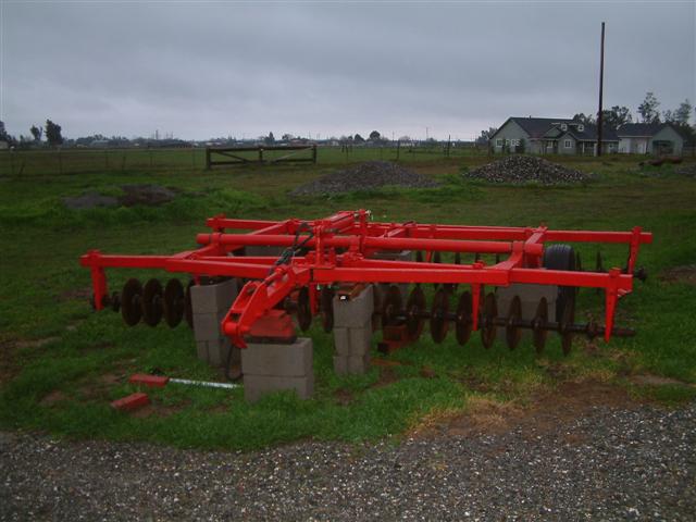

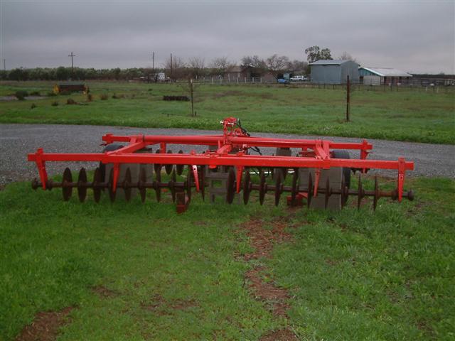

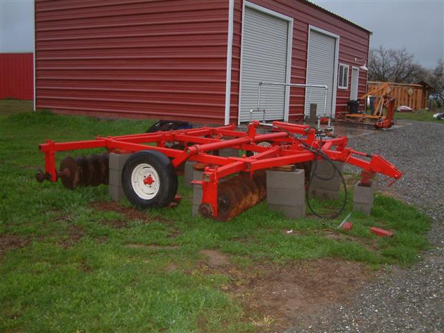

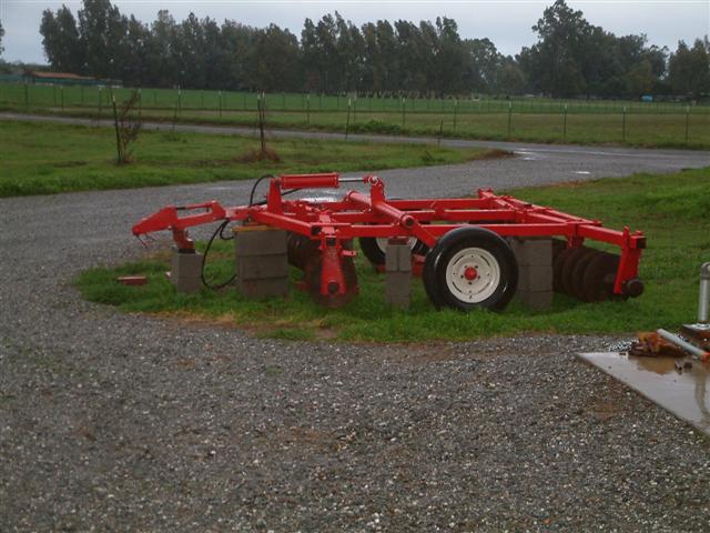

I have an old 13 ft Minneapolis Moline wheel disc that I made into a 10.5 ft disc by removing the two outer pans from each axle. I pull it with my Mahindra 5525 (54 hp engine, 2WD, gear tranny). Works OK in dry soil but bogs down in soft soil. Nice thing about a wheel disc is that you can adjust the height with the hydraulics to fit the soil conditions. Of course, more hp would be nice.
