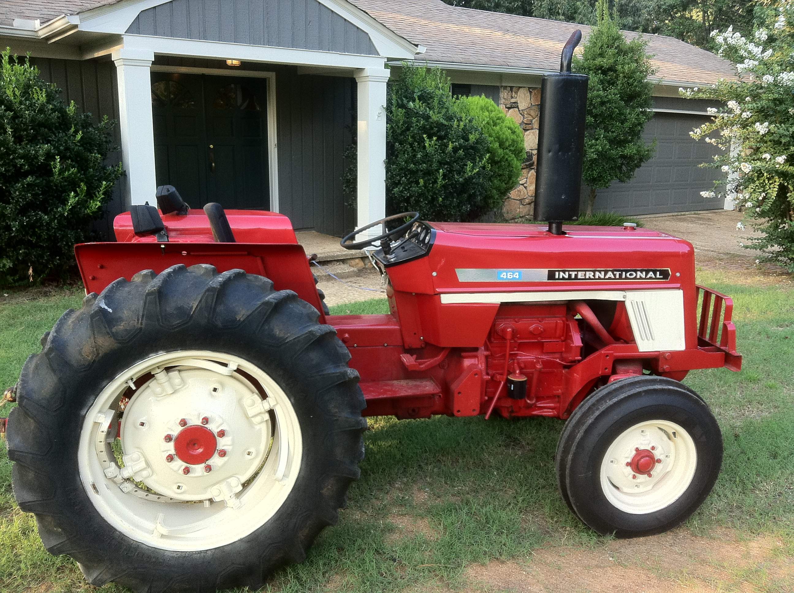

I have another question about the same International 464....The tractor has 4 levers located right by each other in the right console....the lift, draft control right beside the lift control lever, then on top the Independent pto lever,.....then right beside the pto lever there is another lever, but I do not know what it does? Can you guys help me out here? I have to rebuild the master cylinder as the left brake is not working...no big deal about that.....I am going to try to include a photo of the tractor...it is a beauty.....Thanks so much for your info.

If it's where I think you mean, it runs the rear remote valve.
MikeView attachment 222952
We have a 454 IH which from your pics appears very similar. I know which lever you are referring to, it has a little knob on the top and is similar in size to the PTO engagement lever. I can't remember off the top of my head exactly what it does, but it is related to the 3pt hitch. It's either a rate of drop valve or a raise response lever.
