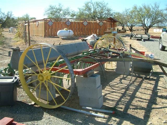

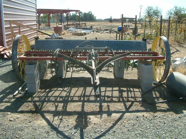

What does the hydraulic cylinder do in a grain drill?
You need to raise the disc openers before you make a turn and then lower them after the turn is completed. If you turn with the openers in the ground, you'll eventually damage them.
Here's the hyd cylinder I added to my drill
