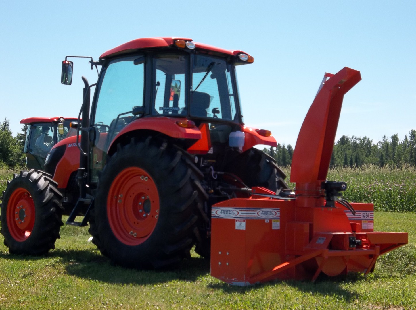

I have been looking at Pronovost and Normand blowers. Is there one blower manufacturer that is better than another (other brands as well)? I will say that I questions concerning the quality of the Normand paint. I see many fairly new ones that have plaint coming off and rusting. I know much of that is based on how it was used/abused and conditions that it was used...
In addition.. I have been comparing the Normand HYD vs the Inverted series... and of course, the Provonost PXPL.
Opinions on these...

Both are made here in Quebec and both enjoy excellent reputations with contractors.
Kind of a Chevy/Ford debate.
Perhaps weight might be how to select.
Both are easy to maintain as all wear components are 'off the shelf' from most suppliers,

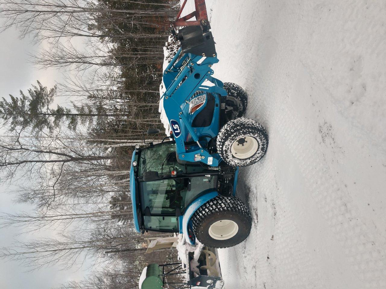

I have a cheaper 74" Farm King and for $4000 it was a good deal for my needs. I get 120-140"of snow a year with 250 yards of driveway and an open area about 1/4 acre to clear. This was the first year using it and no regrets. It is useless for clearing snow from a garage door etc but I use my back blade mounted on a 3PH SSQA adapter for back blading

What PILOON said. Both Pronovost and Normand are very good. The best blowers on the market come from Quebec. Right up to the big industrial ones.
I just priced an inverted for a friend. My dealer stocks MK Martin and Agro Trend. He says he never sees them come back. Just for comparison a 68 inch MK Martin inverted with hydraulic rotation is $4695 Canadian LIST price here. So a couple hundred cheaper.
