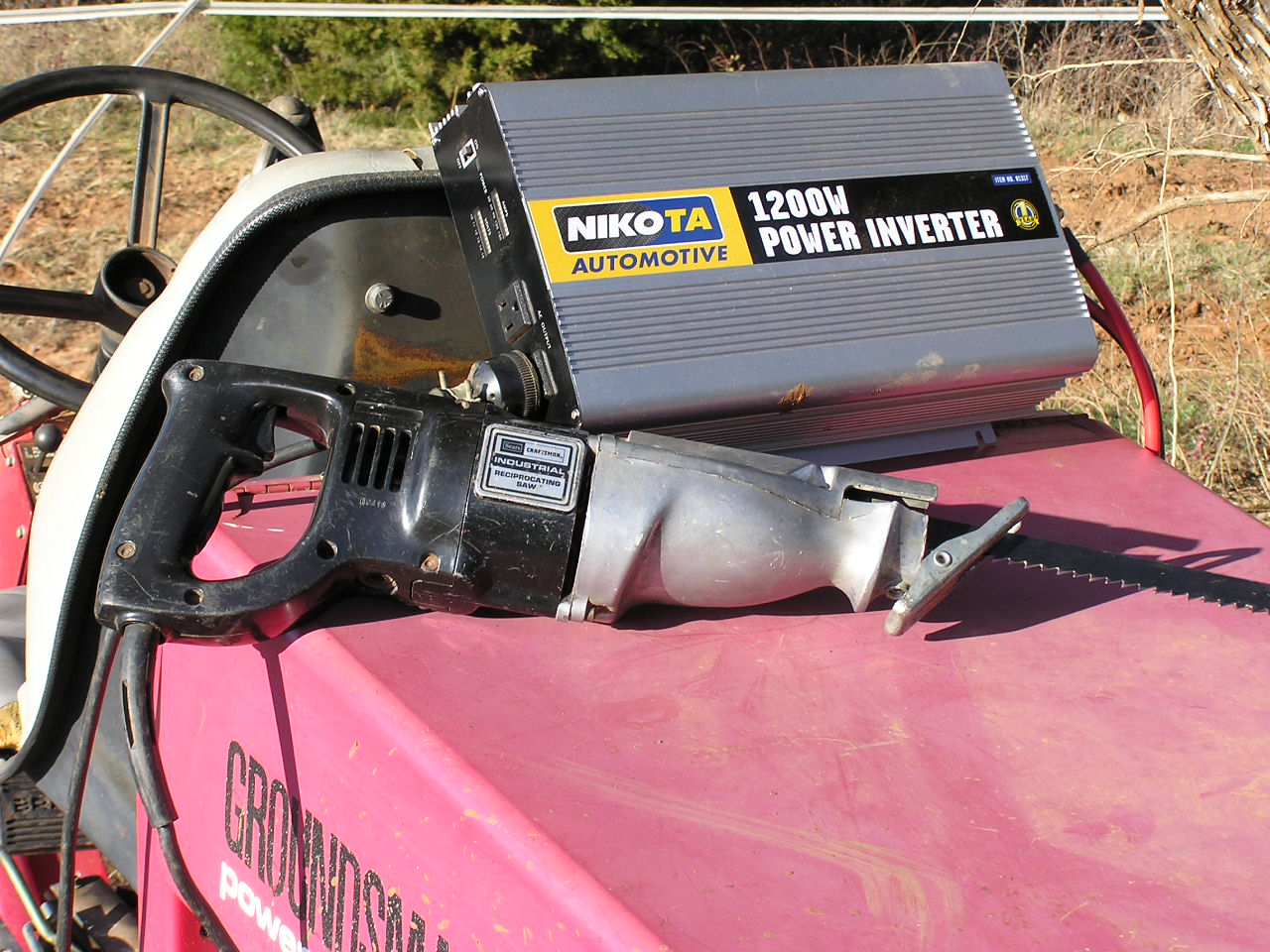

In thinking of installing an inverter on my NH TC40DA so I can run shall power tools like a sawzall or power drill out in the field. Any advice or lessons from those who have done this and would do it differently next time?

The first thing you need to do is check on the alternator and battery specs on your tractor. Many of them don't have enough output to handle an inverter.

The battery really needs to be heavy enough to handle the short bursts. 50 amps at 12 volts vs 13 amp at 120 volts for an electrical saw are very different animals.
   / Inverter on CUT? #5
50 amps at 12v is 600 watts. 13 amps at 120v is 1560 watts. That means that the saw would pull ~3x what the alternator can put out (factoring in an 80% efficient inverter). Ok for 1-3 mins at a time with 5-7 mins for the alternator to catch up and recharge between, but not something that I would do long term. If planning to do much work needing 13 amps long term, I would probbaly drop in a 1 wire 150+ amp in place of the stock alternator.
However it could work if you were pulling 5-7 amps (@ 120 VAC) for 5-10 minutes at a time.
