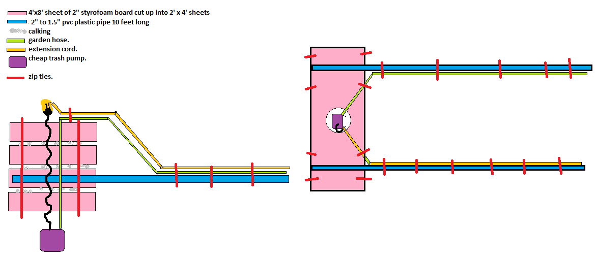

for temp doings during spring / summer for that small of a garden. i would skip any well pump. and just go with a "trash pump" you can pick them up at most local hardware stores for 30 to 100 bucks. many times they might be advertised as submersible sump pumps. like pumps you might have in a basement to help keep your basement dry. you can also get submersible pond pump, for liner ponds. but truth be told, you most likely better off with a trash pump just to make things cheaper. and trash pumps can handle some solids like a leaf or twig without clogging, unlike a submersible pond pump.
your problem will be, getting the pump out far enough, from any sort of vegetation that might be along your shore line. and keeping it up out of the mud.
my suggestion would make a light weight float with light weight handle on it. that you can zip tie a garden hose and trash pump to.
see diagram....
you need 2 handles. to keep the pump from floating / swinging back into the shore line. and ability to put long enough handles on it. if need be to get over any shore and change in water level of pond. so if needed get some male/female adapters and buy a couple more 10 feet sections of pipe.
some times trash pumps do not have a very long cord. and you do not want the extension cord and connection into trash pump cord getting into the lake. so make the connection above the float. and zip tie them down to the top of it.
the hole in center does not need to be that big. just large enough to get a garden hose and electrical plug through. ((note: you might want to shave some of the foam out. so the garden hose does not pinch on you)) but kinda has a soft easy curve to it.
it should be light enough. that if need be you can pull it into shore, and if need be unclog the pump. and when done for garden pick it up and toss it into the shed. or pull the pump out and toss it back into the pond.
you will most likely need to drive a couple posts or something near shore line to rope off the handles.
trying to toss even a small trash pump with garden hose attached and say 10 feet of cord out into the pond deep enough, and not sunk down into the mud. is a rather tiresome painful job, it can be done. it is just a pain to do so though. and every time you use it, it always seem you have to pull it back in and try to toss it back out just to get the pump to set right in the pond.
hence, a small float with handles. that will allow you to push the pump out far enough from shore line, to get descent water that is less likely to have any water weeds or water vegitation in it. and keep the pump off of the muddy bottom.
