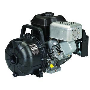

Okay, I have several questions. Feel free to answer all, some, or none. Since I have dial-up at home it may be Monday 12/5 before I can reply.:mad:
I am putting in an irrigation system for a small greenhouse, raised beds and small section of yard. I will be mainly pumping out of water storage tanks through sprinklers and drip lines. Reason being I have a well and it will not support this.
First set of questions is: My farm supply has a Pacer 2 inch flow, 195 GPM, 205CC or 5.5 HP Briggs water pump for $269.00. Seems like a good price.
Do you agree? Any one have any experience with this pump?
This link is not my farm supplier but the type of pump I am looking at.
2 In Self-Priming Centrifugal Pump - 195 gpm | Orscheln Farm and Home
He also has one he used to pump liquid fertilizer that has developed a leak. It looses about a gallon every half hour, possibly more with water. He will sell this to me for $75.00; good price? How hard is it to replace seals in this type of pump? Can you replace the pump for low $$? I am thinking about buying both?
The reason I have 4ac of produce and pumpkins I will plant this year and could use those to irrigate. And the river borders this field and two pumps would be handy.

Since he was pumping fertilizer, the seals may not be the only issue with the used one. Fertilizer is corrosive and I'm wondering if the whole inside of the pump would be rusty? As far as replacing the pump, I've found it's not economical or sometimes even possible to find the part. The pump can cost up to and beyond half the cost of the whole unit.

I suggest checking on parts availability before buying either pump. A lack of parts availability may be why the $75.00 pump is for sale.
   / Irrigation and Gas Powered Water Pump Questions
Parts seem to be available online.
Not sure about the rust from pumping liquid fert but will check it out. Most likely will only buy the new pump.
