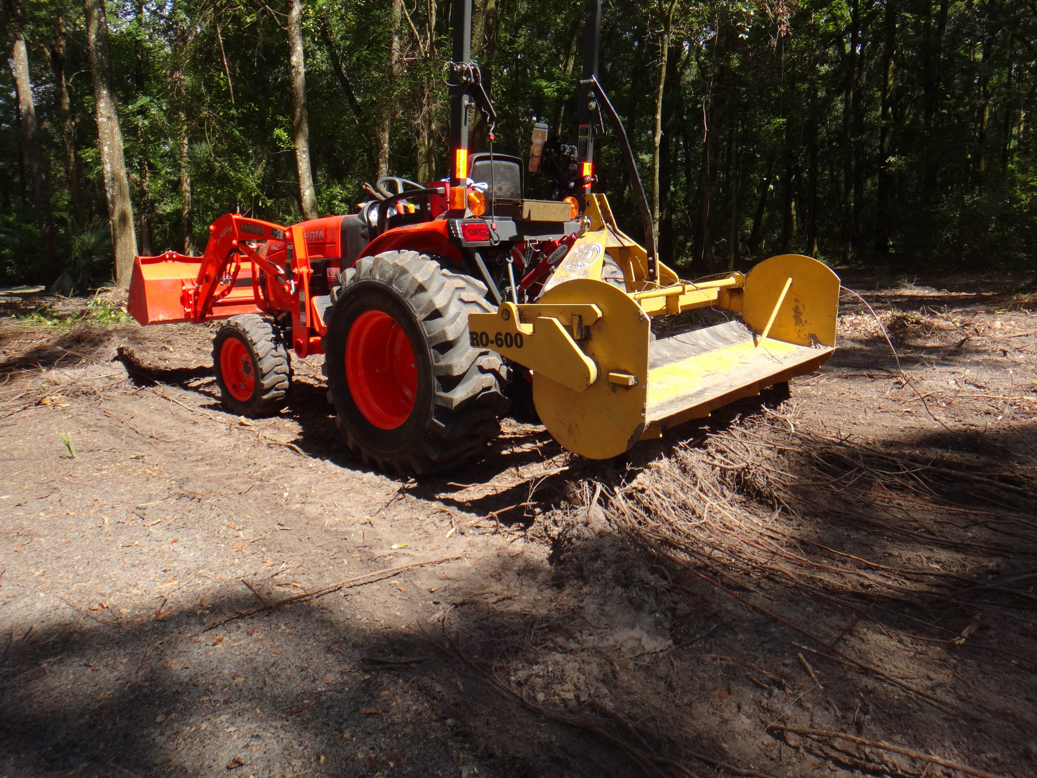

Regarding the box blade, I've never used one before, is it possible to operate in a way where you can use the scarifiers but you don't move dirt/gravel, or if that was my goal should I look more for a land plane. I'm guessing this is where the benefit of having a hydraulic toplink, I'd imagine you could lower the boxblade but lift up the rear a bit with toplink?

Regarding the box blade, I've never used one before, is it possible to operate in a way where you can use the scarifiers but you don't move dirt/gravel?
Scarifier lengths vary but the basic answer is YES.
VIDEOS: https://www.youtube.com/results?search_query=TRACTOR+BOX+BLADE+CATEGORY+2
Should I look more for a land plane?
Land Planes are for routine maintenance of established roads, especially gravel roads.
Land Planes are not heavy enough to serve as Loader counterbalance, which is a key function for Box Blades. Loader counterbalance is VERY MUCH a SAFETY ISSUE.
You have a single pair of remotes on this tractor. Partially extending the scarifiers makes the Box Blade squat and dig in.
With one additional pair of remotes you can hydraulically adjust the Top Link, which alters the angle-of-attack of Box Blade moldboard/blade, altering the thickness of dirt which is peeled up.
With a second additional pair of remotes you can hydraulically change tilt on the Box Blade which enables Box Blade to produce a shallow trench on one side. Trenching is pretty exotic for a Box Blade.
Multiple remotes are whipped cream. Consider meat and potatoes first, ie: quality Category 2 implements to get you started on your projects.

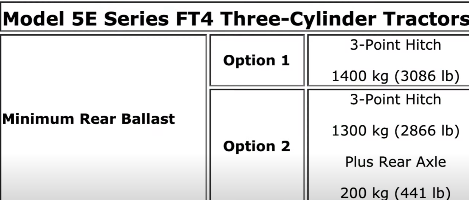

I wasn't asking for matter of rear ballast, I was asking about box blade function for my needs vs land plane. JD recommends just 3,000 pounds of weight on the 3 pt hitch as ballast I believe for this tractor, granted that's based on their loader not a Westendorf as that one has, I'd assume it's about the same.
I wasn't aware box blades had that much weight, do they. Or do they make box blades where you can add suitcase weights? I suppose I could weld something together. I was already planning on having to do something else for rear ballast and I don't think using box blade as ballast is really a consideration of mine if it's not a tool that is best for my needs most of the time.
I do not know what you are seeing but I believe your statement is incorrect.
Counterbalance necessary will be primarily influenced by Loader lift capacity, whether or not rear tires are filled with liquid (800 - 900 pounds) and projection of counterbalance to the rear of the tractor. For these reasons I have never seen a manufacturer publish a factory spec for Loader TPH counterbalance.
JD lists the lift capacity of the TPH at 3,192 pounds. This has very little to do with counterbalance.

If I don't need a box blade because I have more use of a land plane, then a key function of a box blade being rear ballast doesn't really matter to me. I'm aware I need rear ballast, a box blade might be a good way to help achieve that, but it also might not be good for me. I was trying to explain I think I should consider their function as a tool first for my needs, not what most people need, and then consider ballast after that, whether it is accomplished via box blade or other rear ballast weights, that's secondary to the tool's primary use.
The source on the other was actually from your youtube suggestion, tractor time with tim video, his review stated requirements for that 520M loader. Granted it's not the same loader, but I'd expect somewhat similar. I've been working on trying to find the specs for that aftermarket loader, but expect I'll have to email them to find out their exact recommendations.
