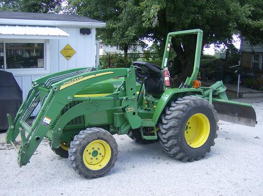

I have mine attached to a metal plate, the plate is clamped to the ROPS. ~~ grnspot
