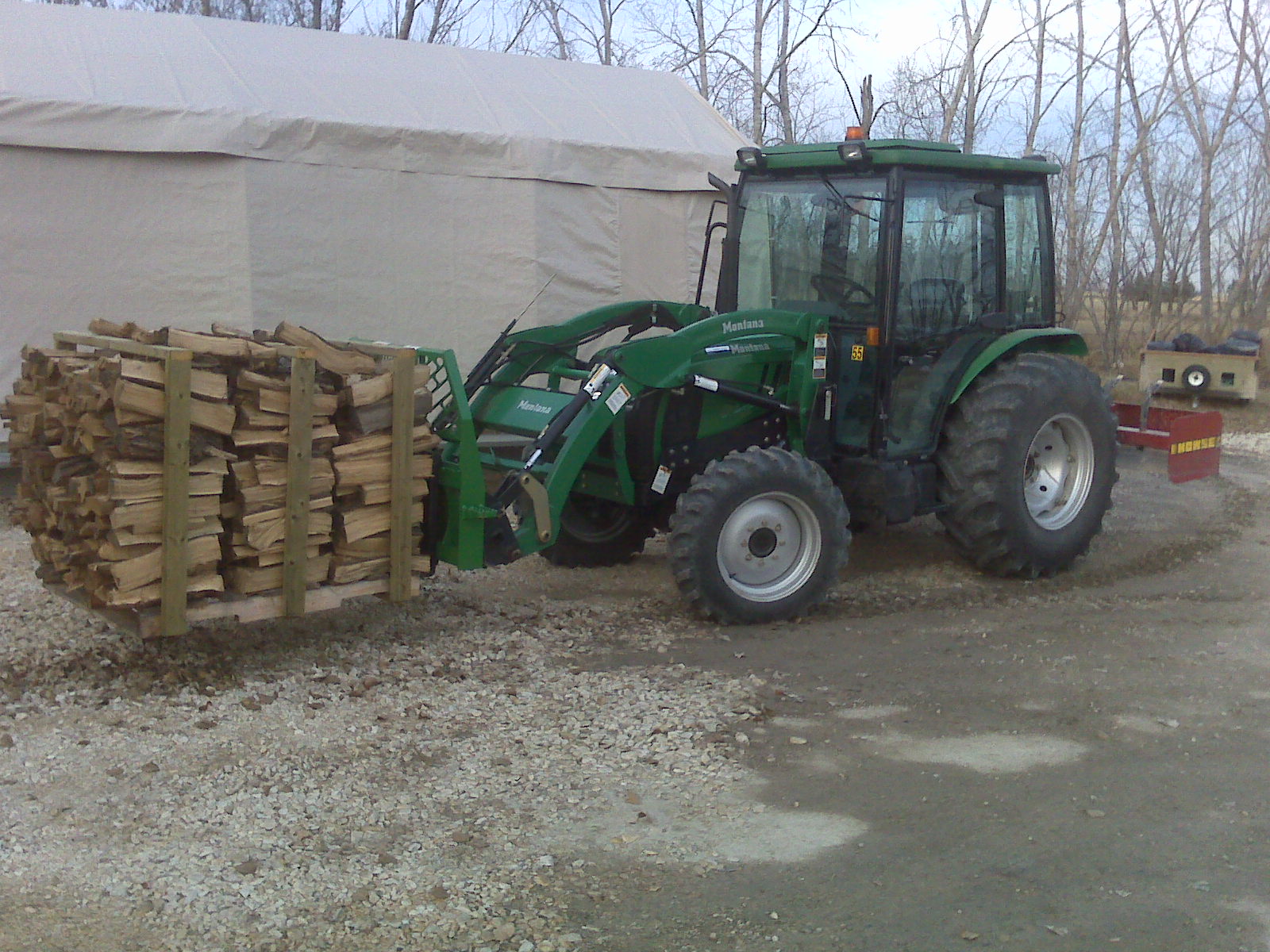

Hi Sarge, welcome to Montana-ing. Has your dealer been able to help you out with your issues yet? When we first got our 5740C, the 4wd would work its way out while I was snowblowing, our dealer adjusted it and now it sounds just like yours. Every once in a while it won't disengage even with the tractor in neutral, popping clutch a little, changing gears and I found if I just lower the bucket and slightly lift the front wheels it will pop right out in those instances. I much prefer it this way over when I had to monitor it or even sometimes hold it in 4wd. The other levers are tight too, but I don't mind.
Our tach engine revs up to about 200 over rpm rated speed (I can't think what that is right now 2400?) It feels like the tach is accurate, I don't have a way to measure it.
Here is a picture of ours yesterday hauling in a pallet of firewood (almost 1/2 cord oak). I cleaned it up, just waiting for the snow to start around here.
