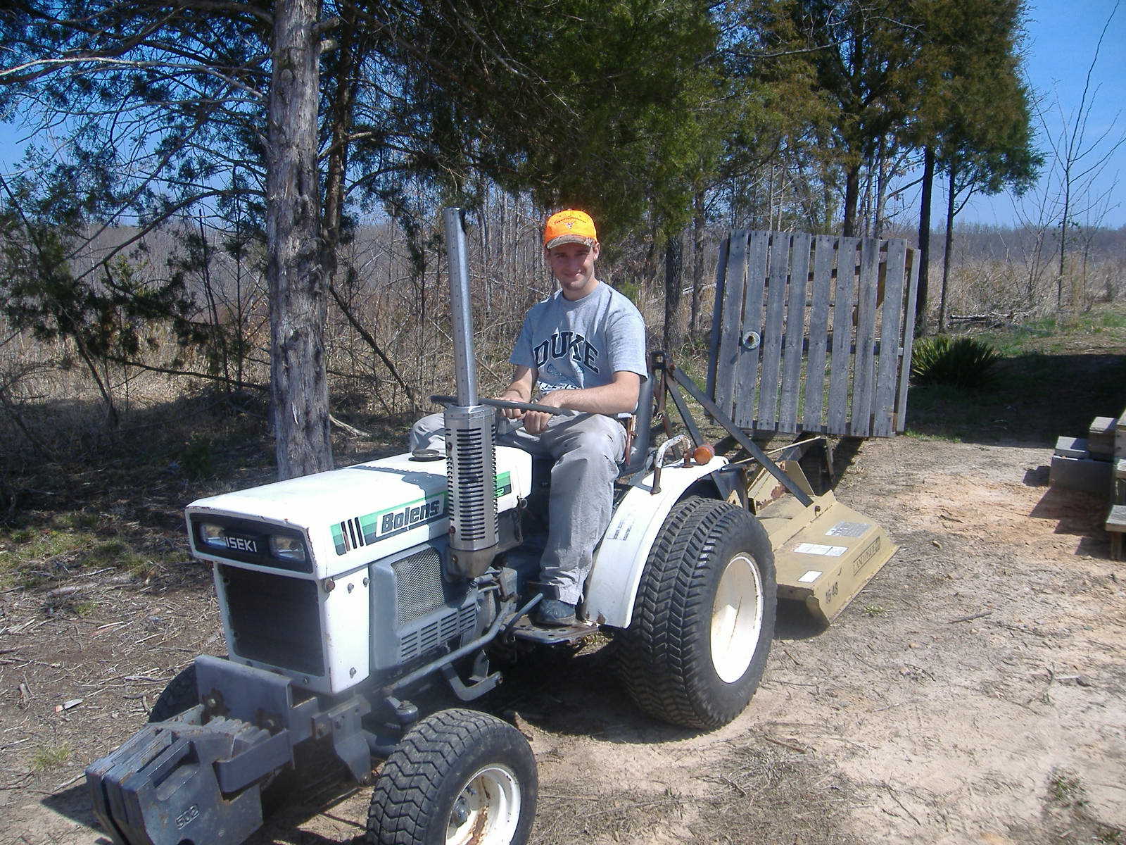

I had a 1976 152 that was a great little machine (owned it from 2007-2010). In three years the only problem I had with it was the hydraulic pump went out and I replaced it. I only sold it as I wanted 4-WD and FEL.
