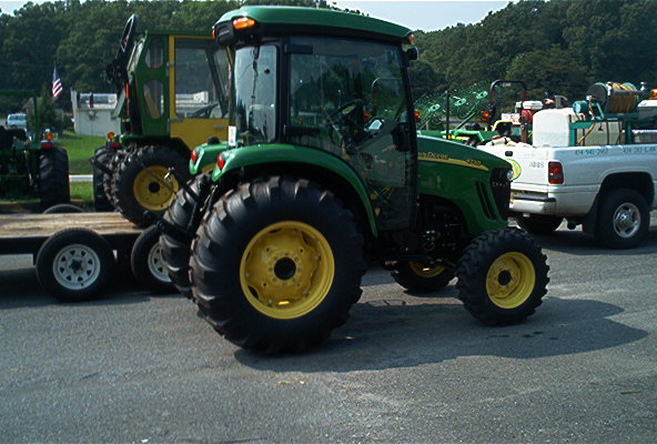

Well, I take delivery of this Monday, I'll bet this doesn't overheat bushhogging!
The PT can sit on site broke down, while I ride around in air conditioning. :)
