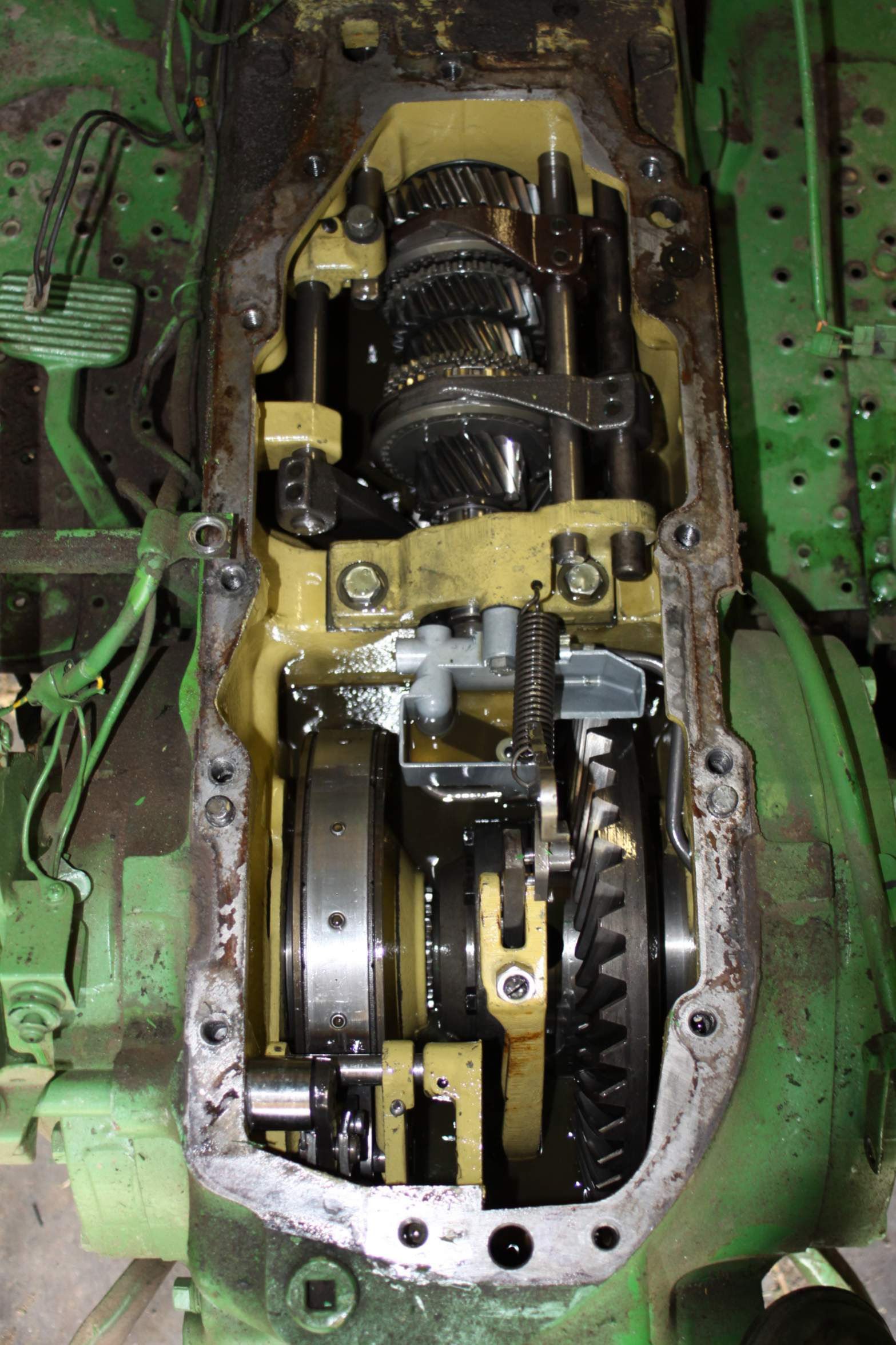

when the diff is heavily worn, you can get binding in the sun gears when you apply a lot of power. It effectively locks the diff. That is what you are seeing.
I ran a street car at the dragstrip for a number of years like this. It actually worked better than the posi I eventually replaced it with.

...all interesting thoughts. I would be really suprised if I had perfectly distributed lack of traction. Especially once I got down to the gravel. So far, tcartwri's thoughts make the most sense.
I don't think I have the experiance to recognise worn gears from new gears, but I do have a picture from when I had the 3PH off to rebuild it.
As for the diff lock, I have the pedal also, but it doesn't do anything. The dealer gave me some ideas what to look for to assess what will be needed to repair it. I'll be looking at that this spring after it warms up sime since my shop isn't heated.
