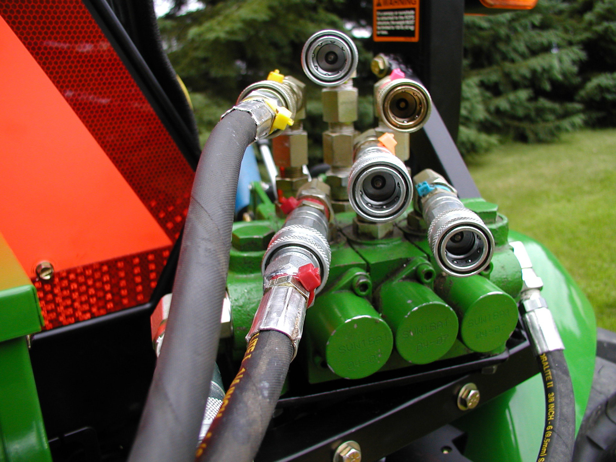

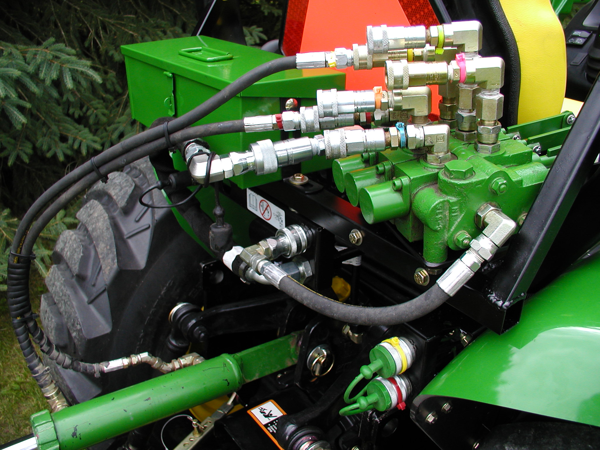

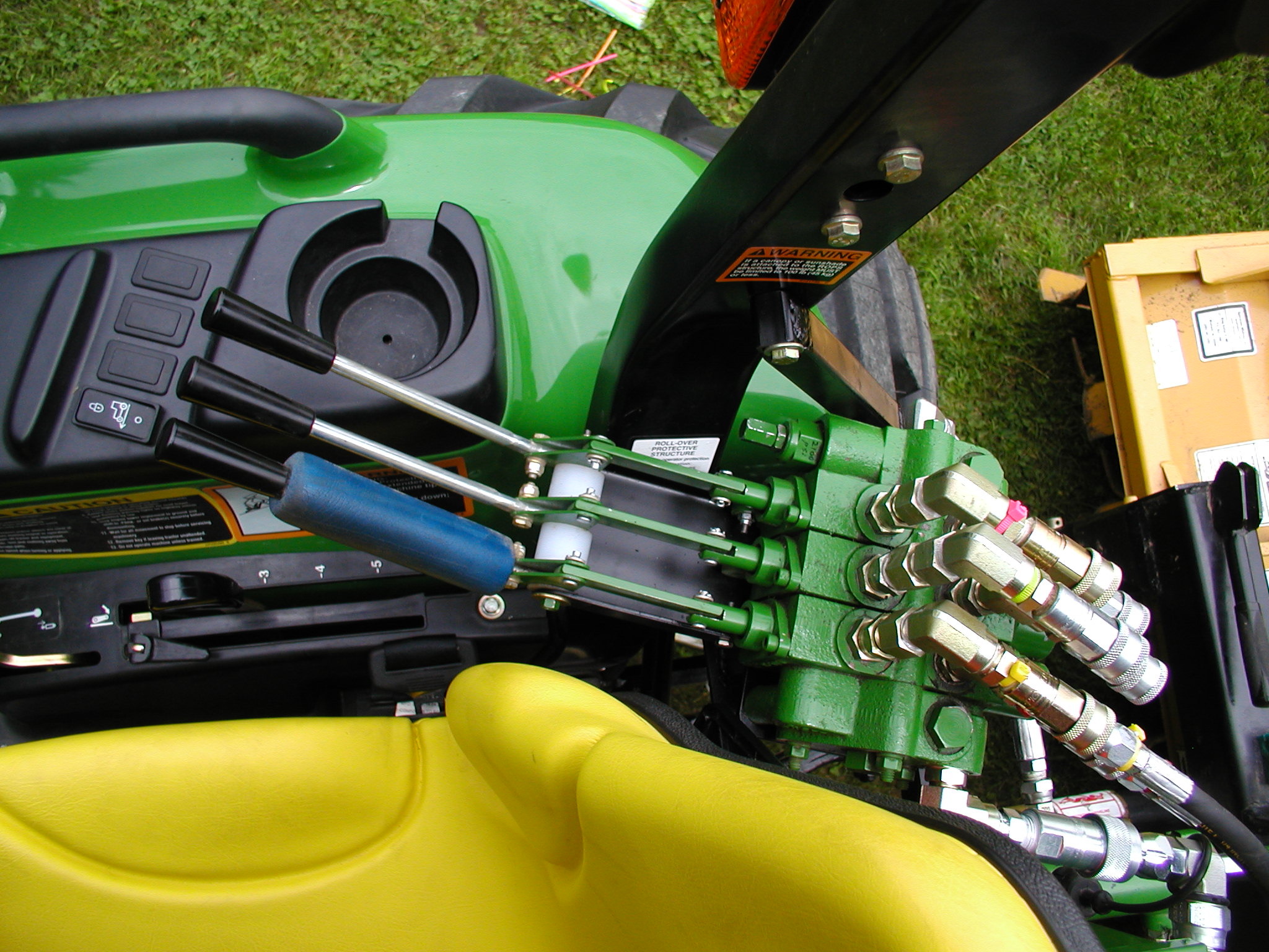

Adding hydraulics is only limited by your imagination. It really helps to get a boost by ordering the stock power beyond option, but even that can be user configured. To get you enthused, here are pics of my year 2009 JD 3720 installation:

I'll second that. My tractor came with a rear remote and I added a joystick for an additional 2 ports and routed the rear remote through a selector valve to give a second option for the lever. Recently added a backhoe and just put it in the loop.
Thanks for the pics, and I'm impressed with the design and the accomplishment.
The pics leave me "somewhat" enthused. But the added clutter leaves me with the desire to find a better design, or do without.
No offense meant, but are the lines extra heavy duty or large and necessary, or could they be smaller such as 1/4" or 3/8" ?
And the control valve assembly? Could it be a bit more petite?
