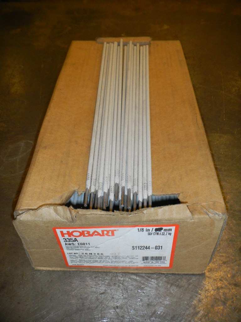

For now stay away from 7018. Use 6010, or 6011, they are a lot easier to start. I really like Hobart's 335A 6011.
