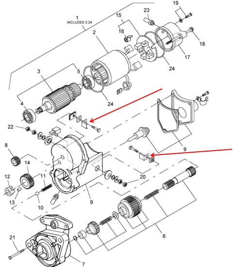

Good evening all,
So I have 2004 TC35 12/12 with 2503 hours. Has never had a serious mechanical problem. Just this week, when I turn the ignition, the starter does that grinding spin and doesn't engage. At first sporadic, but now happening with increasing frequency. Is it inevitable that the starter will fail? If so, having not looked at the tractor today before leaving for work, can anyone remind if the starter on that model is easily accessed for owner replacement? If owner doable, any special tools I need on hand?
Any counsel greatly appreciated!
Jed

From your description, it's likely that the solenoid intermittent pull-in plunger contacts are worn, bent, or dirty. New Denso starter ($100 - $150 + shipping) or new contact set (from ebay $5.00 free shipping). Been there. Identical symptoms. Easy to change-out. You might get by without having to remove the whole starter. Just pull off the solenoid. Be careful to save/preserve the insulation washers.

It may just need some TLC. Mostly cleaning and lubrication.
As someone said, lots of cheap "Denso" starters on E-Bay.
   / Is my starter going? How to replace.... #7
If it spins but doesn't engage its the solenoid. Easy repair.
