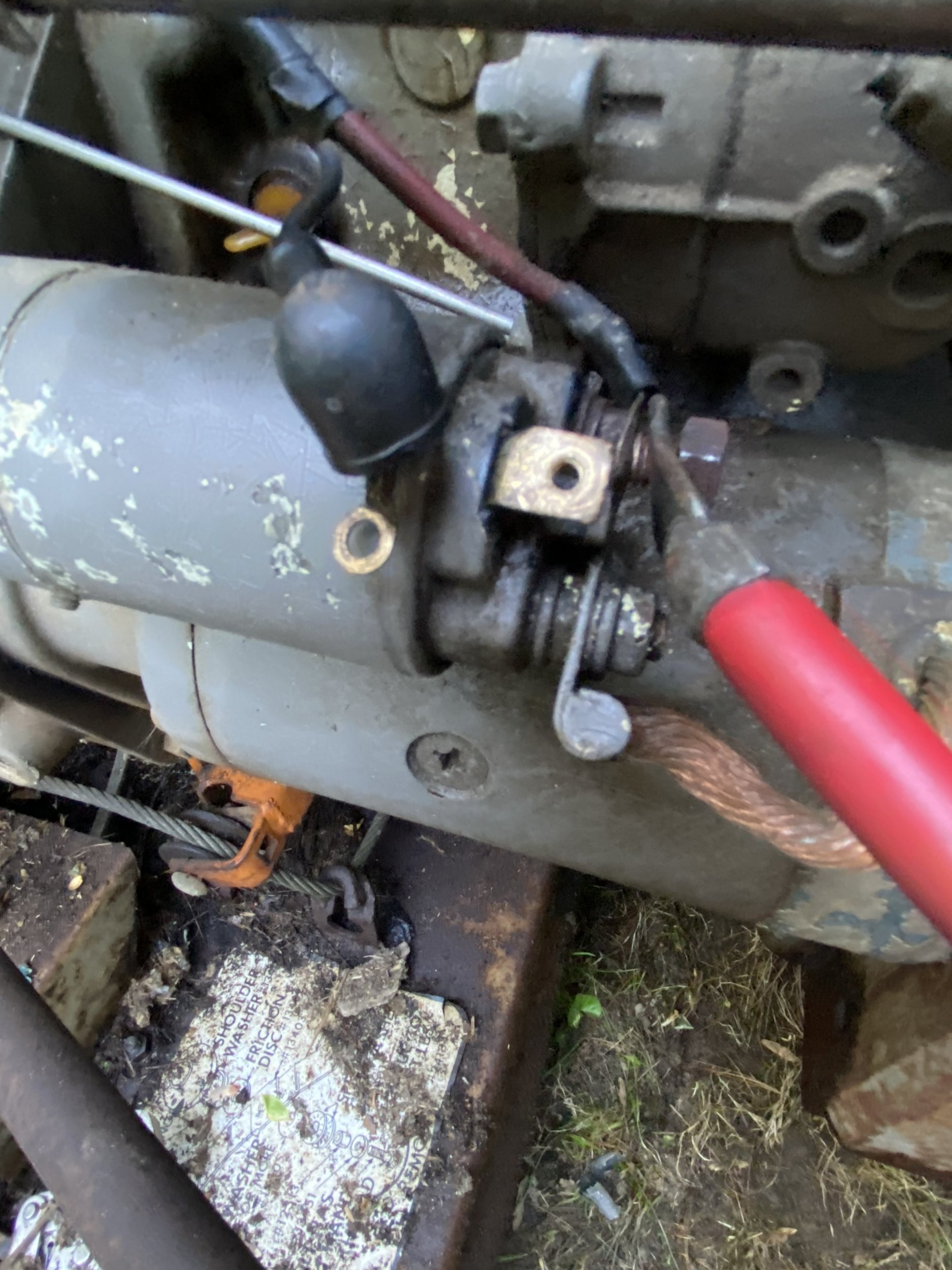

Is my starter motor faulty only getting sparks no noise? Hotwiring
   / Is my starter motor faulty only getting sparks no noise? Hotwiring #1
tractoroldhard
May 3, 2022
10
massey furgson 220

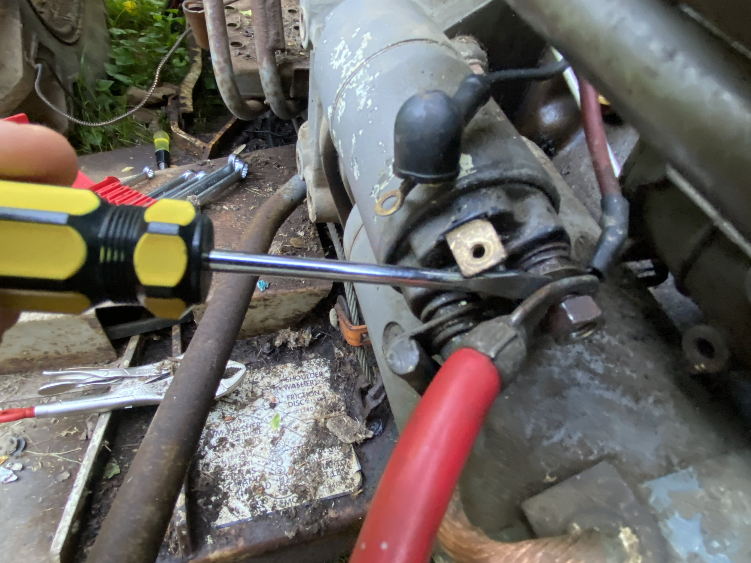

I'm trying to test my starter motor with hot wiring and screwdriver. All I'm getting is sparks no noise no sound nothing. Just sparks when connected.
   / Is my starter motor faulty only getting sparks no noise? Hotwiring #2
Heres something that takes less time to do than tell you how. Loosen starter mounting bolts enough to alow shaking starter side to side a few times then retighten bolts and this time don't be timid when you short accross terminals. Thats to say don't pull screwdriver away at first spark. Report back with results and we can take it from there.
unscrew the copperwire thats connected to a bolt left to the picture right? Then trying short it and hold
