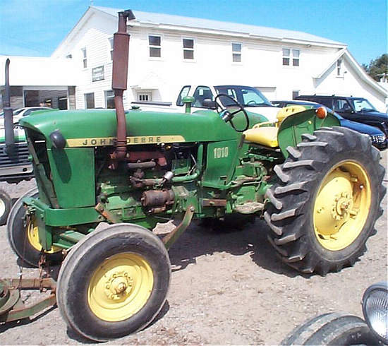

Found an old John Deere model 1010. The man said he didn't know how old it is, but said probably 1970's. Sold his property & doesn't need it. He's had it 3-4 years and it just got a rebuilt motor when he bought it. He doesn't have any idea how many hours on it & said it doesn't "use oil". He probably put about 50-75 hrs. on it himself. It has a 5' bushhog, a ginpole???, and a post-hole digger. Oh yeah, & an extra set of blades. Man says he hasn't started it in about 3 weeks, but we can go over there & he guarantees it will start right up. I don't need anything I have to work on, since I'm not mechanically inclined - just the gas & oil thing for me! He wants $4,000 for it.
What do you think??? Is it a good price for such an oldie?
Am I asking for trouble?
Thanks for you input.

I believe the 1010 was built in the early 60's. It was, if I remember correctly, the first tractor in that size class with more than two cylinders and replaced the model 430 (last of the 2-cylinder tractors in the M, 40, 420, and 430 sequence). The only big difference in the tractor from the 430 is the engine. It was made in Dubuque, IA.
I would expect the tractor to be of good quality (my JD420 ran well for me and my dad for better than 40 years). I would not expect it to be something that does not need some mechanical ability on your part from time to time. No tractor is like that. If me, and with your non-interest in mechanical things, I would make sure I had a good dealer within easy reach to take care of you.
The price is not cheap, but is average, in my estimation. These tractors are collector items for some. That brings the price up a bit and may not be of interest to you. If the tractor has good metal, then it will bring that price from someone who wants to restore it.
   / Is old JD worth it? #3
You can go here you can get a "blue book" value which shows prices from $2797 to $5450 depending on the condition and options. This site shows that model being made between 1960 and 1965. It will also tell you a lot about the tractor. This should give you a good head start. Good Luck!/w3tcompact/icons/smile.gif
