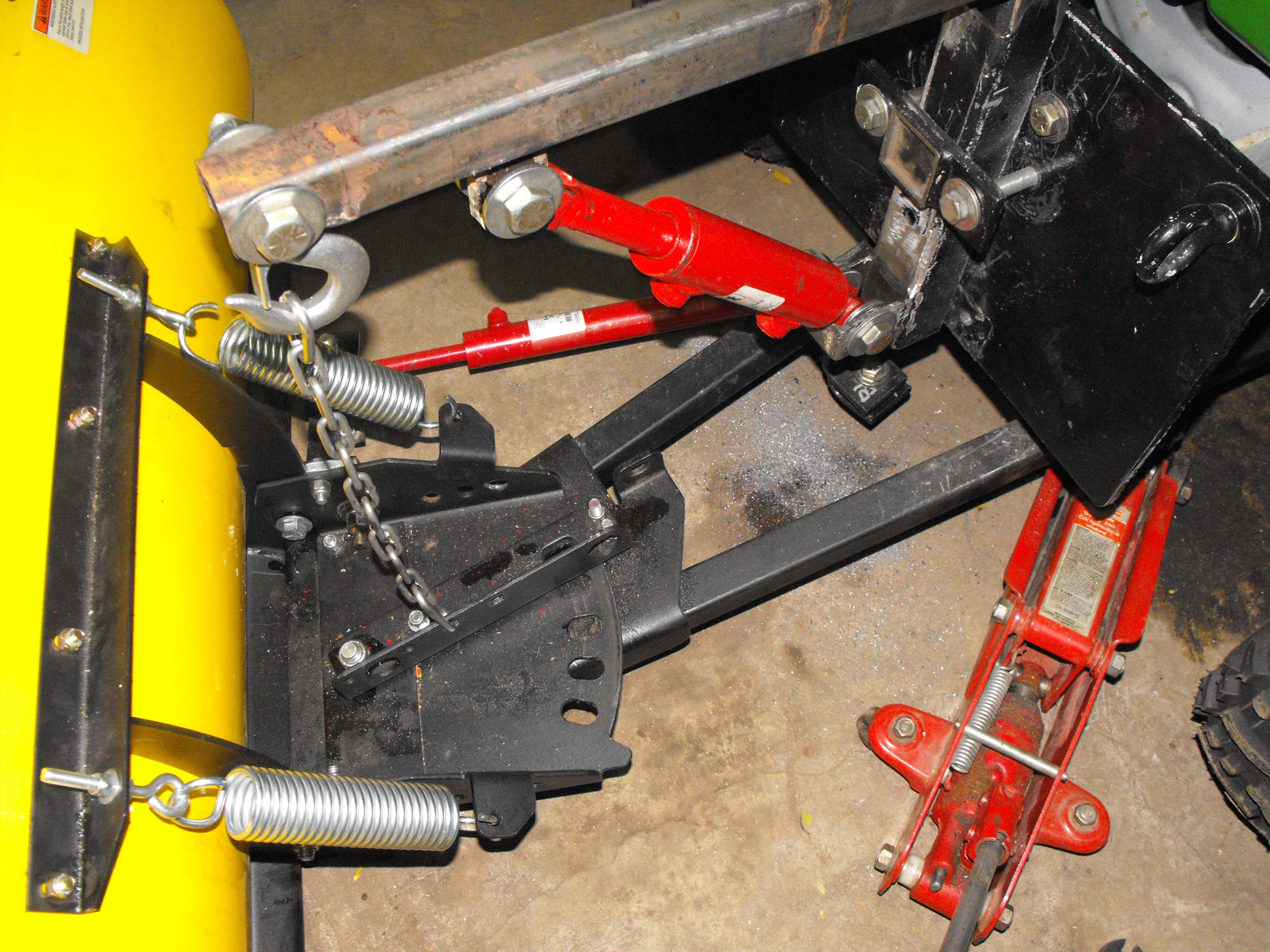

Hi David.....the 42" Craftsman had but one center spring only...the blade was kinda' cheezy...it was always tripping/folding down flat... so I installed two chains.. yes it did catch once or twice and twisted it a bit last winter...I've since sold it.....here's a photo of my new snowblade...take care...Ampa <> :)

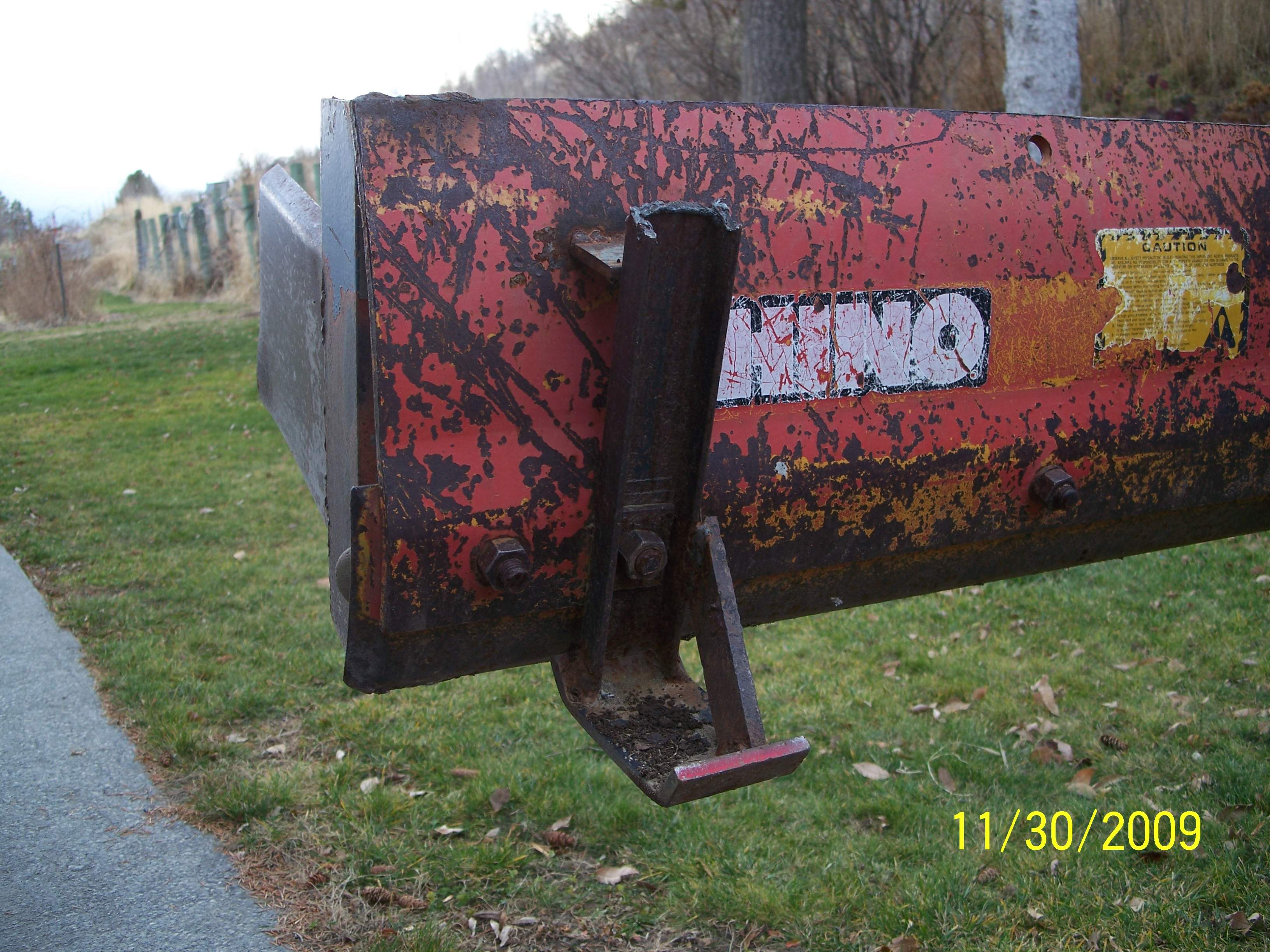

I built these shoes for my back blade a few years ago.
My reasoning was to adjust the blade height to leave the gravel and plow the snow. The channel iron is slotted for initial adjustment about 1/2". The top like tweaks the clearance when adj. in or out.
The shoes also work really well when grading dirt or gravel. The shoes being on the "leveled side" of the blade, knock down humps and it makes a very nice finished surface.

:thumbsup: Exactly the reasons i have build shoes on mine,+ it keeps the blade last longer.
