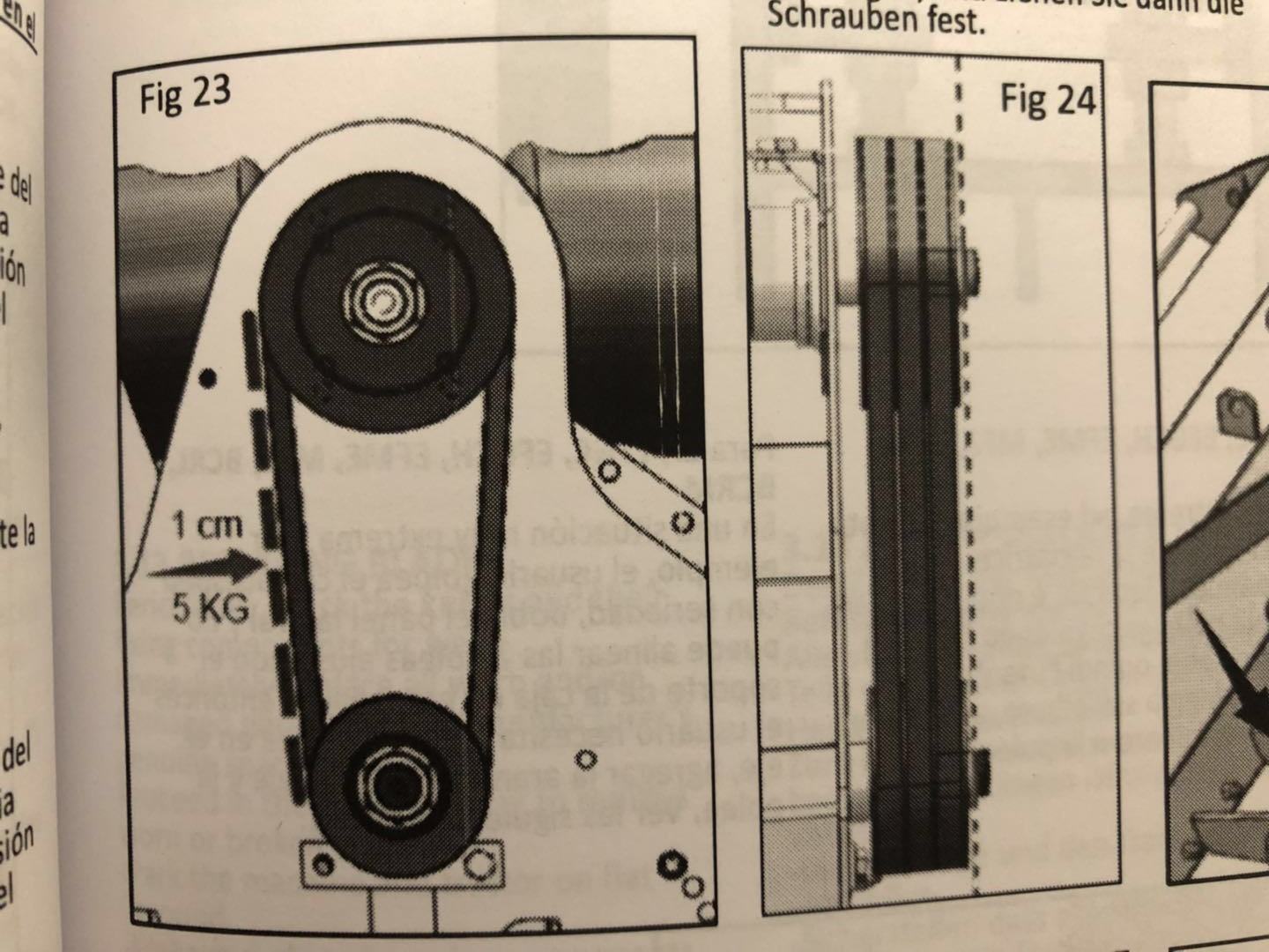

The key points include:
1. make sure the pulleys are in the same line
2. correct belt tension, you can press 1cm down when you use 50N force to press in the middle of each belt.
this photo explain it.
   / Is there a video of anyone changing the belts on a Caroni TM1900 #3
Hey island mountain, I have a TM1300 and just changed my belts last week or so. My flail is not as wide as yours model, but it has the same 3 belt drive system. I had to completely undo the tensioner and found a way to keep it out of my way while I worked the belts on. You have to get them in the first pulley slot and then move them back until you have all three on. It takes a little force to make them jump the pulley as you move them back. Once they are on, you can reattach the tensioner and tension them as the previous post states. Be sure to clean the pulley grooves up before you install the new belts. Mine were clogged with bits from the old belts.
