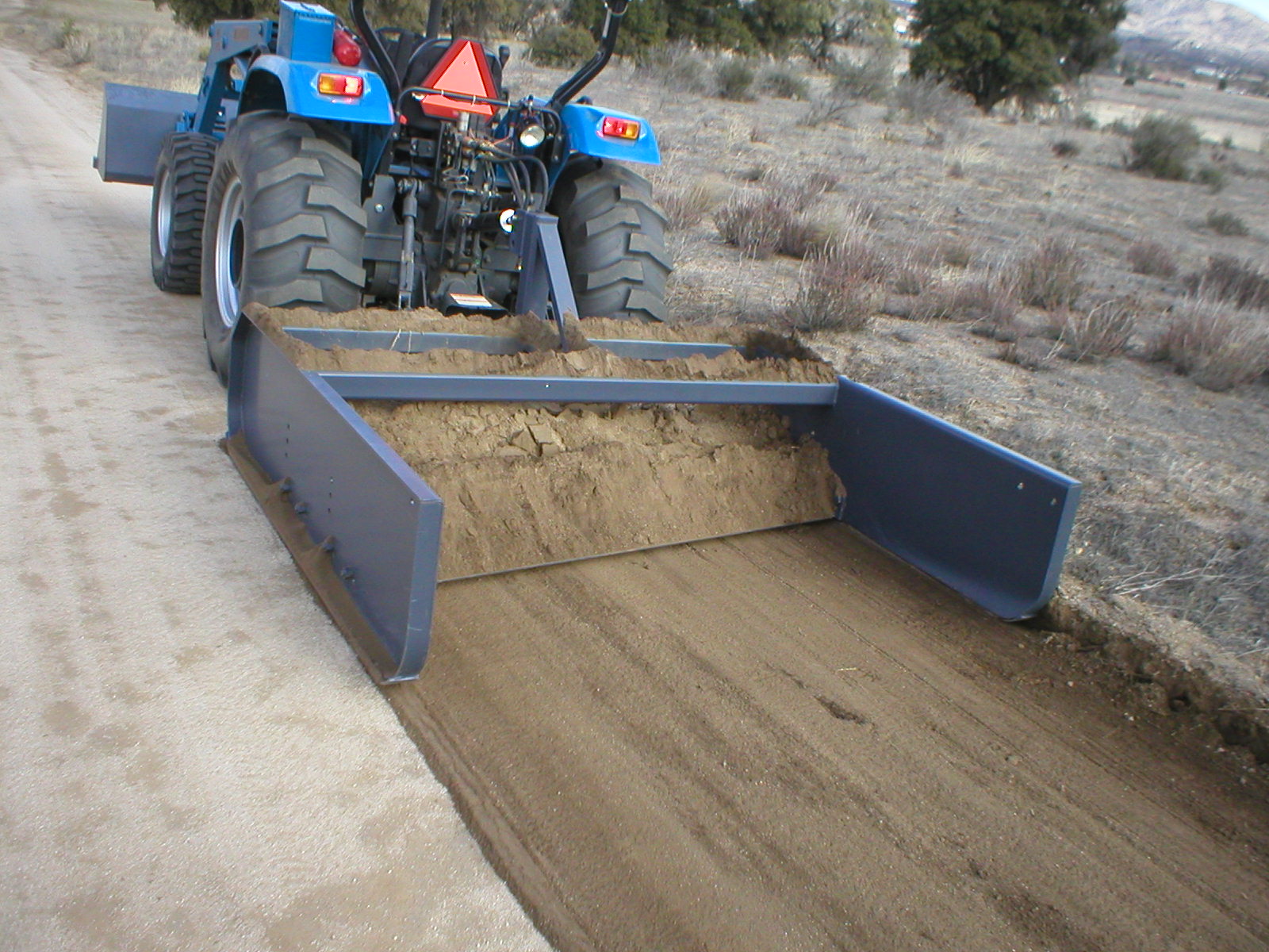

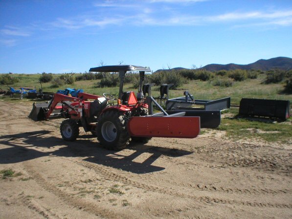

Vegetation will always be a problem of some sort.
Try the LPGS by just setting the implement level on the ground, but only just touching the ground. Do not have the position control lever all the way forward so that the cutting edges are always cutting full depth. You want to actually hold the implement from dropping.
You can see in the 3rd picture that I load up also if I let the blades just keep digging
This works very well for me with both of my machines that I use LPGS with.
