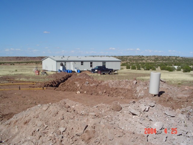

Where my tractor is going to end up theirs alot of variation in soil. Meaning very hard pan to soft soil to sandstone. Been trying to find info for post hole diggers most of which I get from the forums. But I have yet to read on one that has a replacable bit. Sure they seem to work fine when new but am reading that over time because of soil conditions that the cutting end of it will wear down (understandably so).
I'm just wondering if they make one that has a variety of cutting bits, if you need one for going thru sandstone you would put on a carbide tipped one on. Or if you wore down the end from using it on hard pan soil you could simply replace the end rather than buying a new auger regardless of cost?

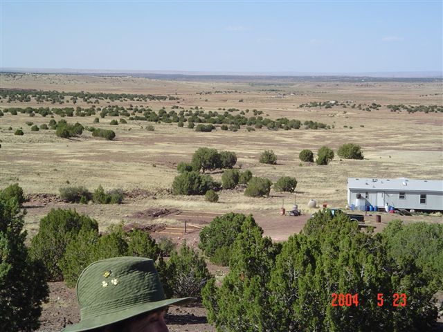

We get under 12" a year their (north eastern az.) As for the rest that were kind enough to respond, From what I get on the net (granted I dont have nearly enough links in my favorites folder) all they show is the unit at a far distance and it would take super human eye sight to tell if the augers have replacable cutters.
I have but one link that provides a very up close picture of the cutting edges themselves. But for sandstone those wont be nearly good enough. One would have to be made of carbide and NOT hardened steel. To put it as best I can I was more or less thinking if they have replacable heads, kinda like a well drilling rig, they simply (or by force) replace the worn unit with a new one.
If I were to dig holes and 6" below the dirt I hit sandstone I would like to unscrew/remove the cutting portion of the auger and put on something like a carbide toothed cutting head to finish the job. Living in the city (soon to be elsewhere) I simply dont have a tractor supply outfit close enough to visit after work to get a closer look, most are way on the southern end of town and arent open on weekends.
