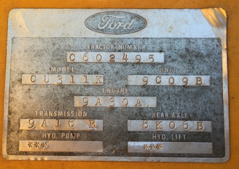

I bought an old Ford industrial tractor with loader and backhoe and I'm not sure if it is a 340 or a 340A. I want to purchase manuals for it so I can do some maintenance, but I would like to make sure I purchase the correct manuals. The ID tag on it is shown below. Any information you could give me about it would be very helpful.

Rrancher51, the date code and model code stamped into the bell housing on the RH front ledge just behind the starter and also on the sticker on the hood will tell you what year and model you have for sure. I don't have the model code for the 340 available right now, but the date code for a 340 will be: 9#**B, 0#**B or 1#**B where 9, 0 or 1 indicates 1979, 80 or 81. The # is a letter, A- M where A = Jan & M = Dec; I is not used. ** is a number representing the day of the month.

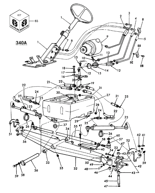

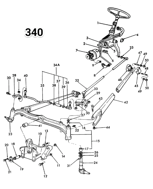

Now the easiest visual way to figure out what you have is whether your front axle is a forged axle (340) with no external steering cylinders or a welded box (340A) with external steering cylinders.
The other difference is in the 4X4 shuttle transmission. The 340 uses a blocker valve that prevents shifting the shuttle when the engine is above 1200 rpm. The 340A use a modulating valve that allows shifts over 1200, but 'modulates' so that the tractor doesn't shift abruptly when making direction changes.
