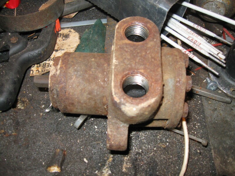

found it in my grand fathers barn as he said anything in it is mine. if its a motor [thanks kennyd] i could use it for my snow blower shoot. thanks

Do you mean "if it's a motor I can..."?
Looks like a small motor because the ports are the same size. Pumps usually have on port larger (the return or suction) than the other.

yes i ment motor sorry. on a motor does it work to put power to one side to make it go one way and power to the other side to make it go the other way?

Yes, Correct.
