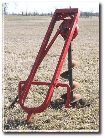

I was looking at this post auger this afternoon and was wondering if anyone knows or recognizes this auger. Is it worth $400 CAD (~$325 US).

Don't know who made it . But for the price .... It might well be worth buying .
Can't say I'd be real comfortable around that exposed shaft and U joints though . John

Looks like an old Dearborn or Danuser or ARPS by the way the scissor frame is made. Pretty tough machines.

I took another look at this auger last night and noticed the pto shaft is really twisted. The owner must have replaced the shear bolt with a stronger one and hit something hard. I was also thinking about the exposed pto shaft and decided to pass on this one,
I was at TSC today and see they have sell a "Green Line" auger with 12" bit for $629 CAN (~499US). Steve

Green Line, made in Bowling Green, OH is a good auger. $499 is a good price.
