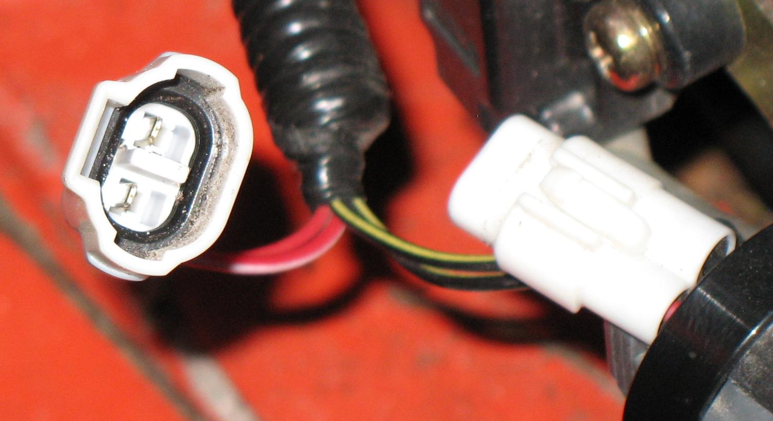

This is the seat safety switch connector on my L3940. I'd like to buy another one of these so I can jumper the aftermarket one, plug it in, & have done no damage/ mods to factory connector/ wiring.
Where can I get one?
Thank you ...

Oops ... Nevermind, I think ... Just dawned on me I can just unscrew the other "plunger" switch right next to it & let it dangle free. I think that switch over-rides the seat switch shown in the pic.
   / Is this a standard elec connector? (pic)
For anybody who might've read my two posts above: It didn't work; Removing the two screws & letting the plunger switch just dangle didn't work.
I thought it would since it would be the equivalent of the seat being up leaning on the steering wheel at all times. But, apparently Kubota made that switch operate so that if your seat is UP you can run the PTO but not actually move the tractor ... since a press of the hydro pedal kills the engine.
So, I ended up just jumpering across the two wires going to the in-seat switch, so it thinks I'm sitting on the seat at all times.

Didn't you read the other couple of recent threads about Seat vs. Tilt switch functions/issues? :p:D
I applaud you for the "don't try this at home".
Plenty of people have, and will continue to, jumper their seat switches, but at least it won't be on your conscience. :)
