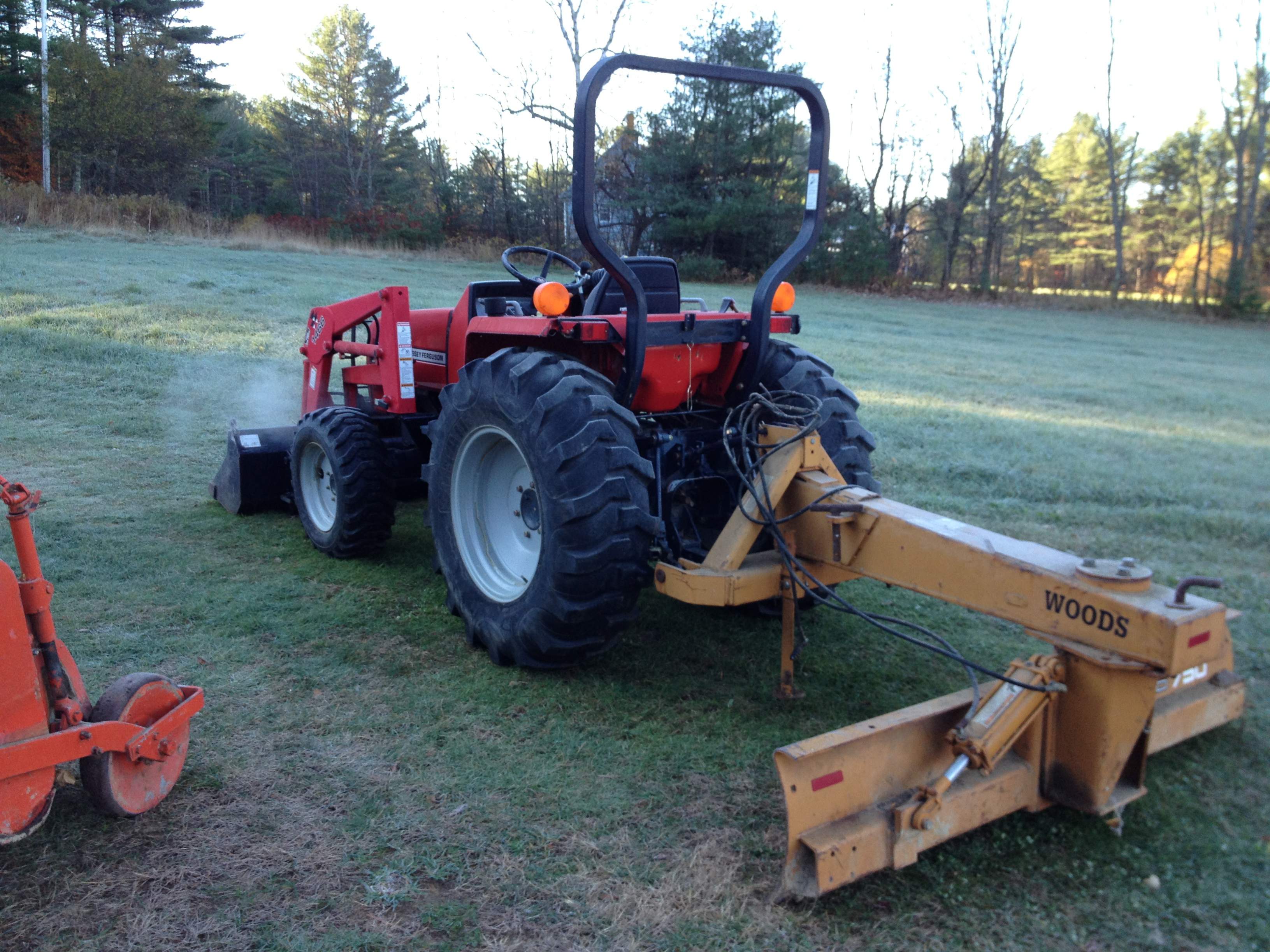

You mean like this Woods 750 on a 1433?
Just kidding, I only had it there to move the blade out of the way.
I am thinking like others, too much blade for too much money. If it was a great deal, it might be worth considering, as I think your machine could handle this blade for most scenario's, but that is not a great deal and it is not the ideal blade.
