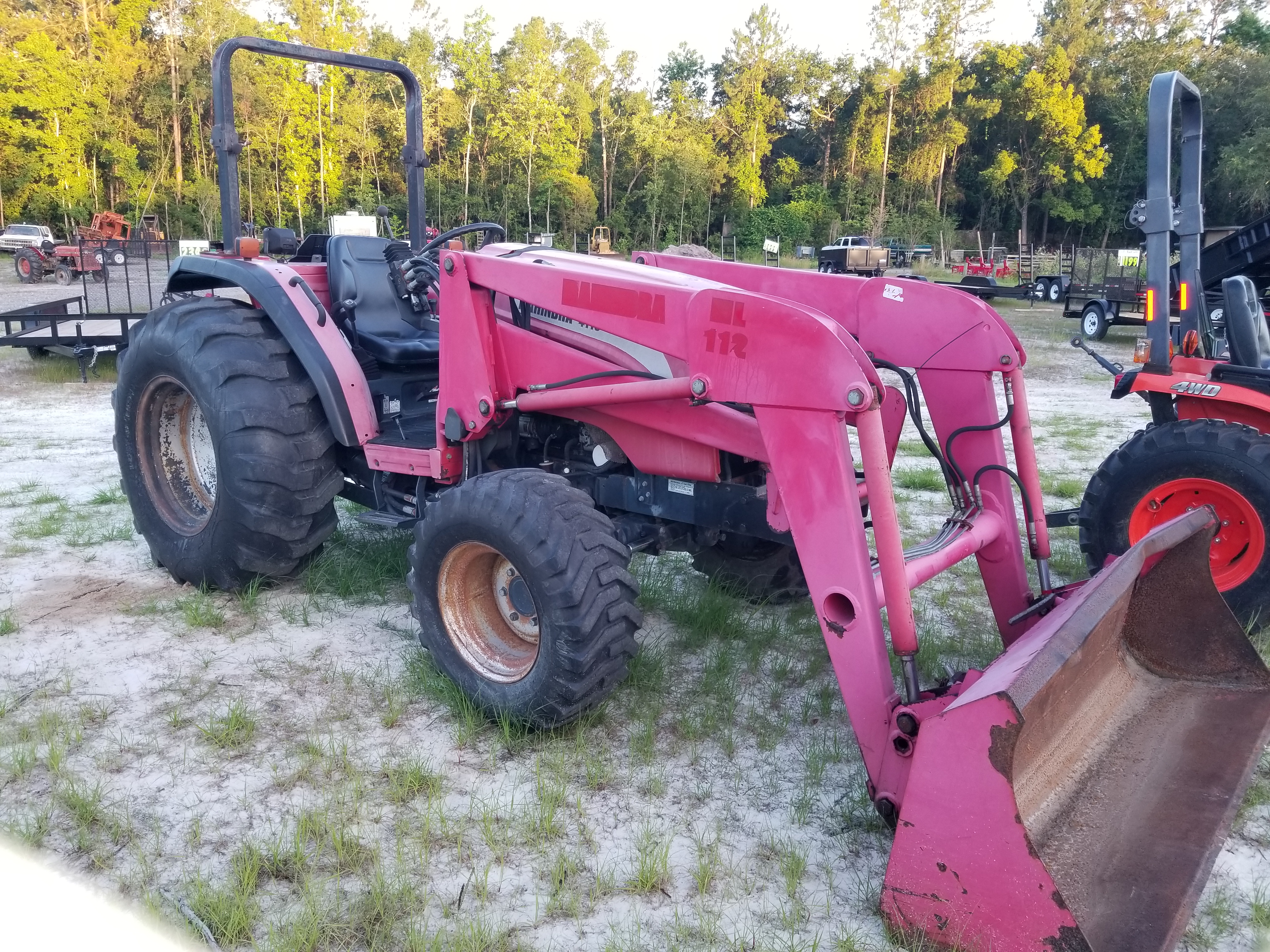

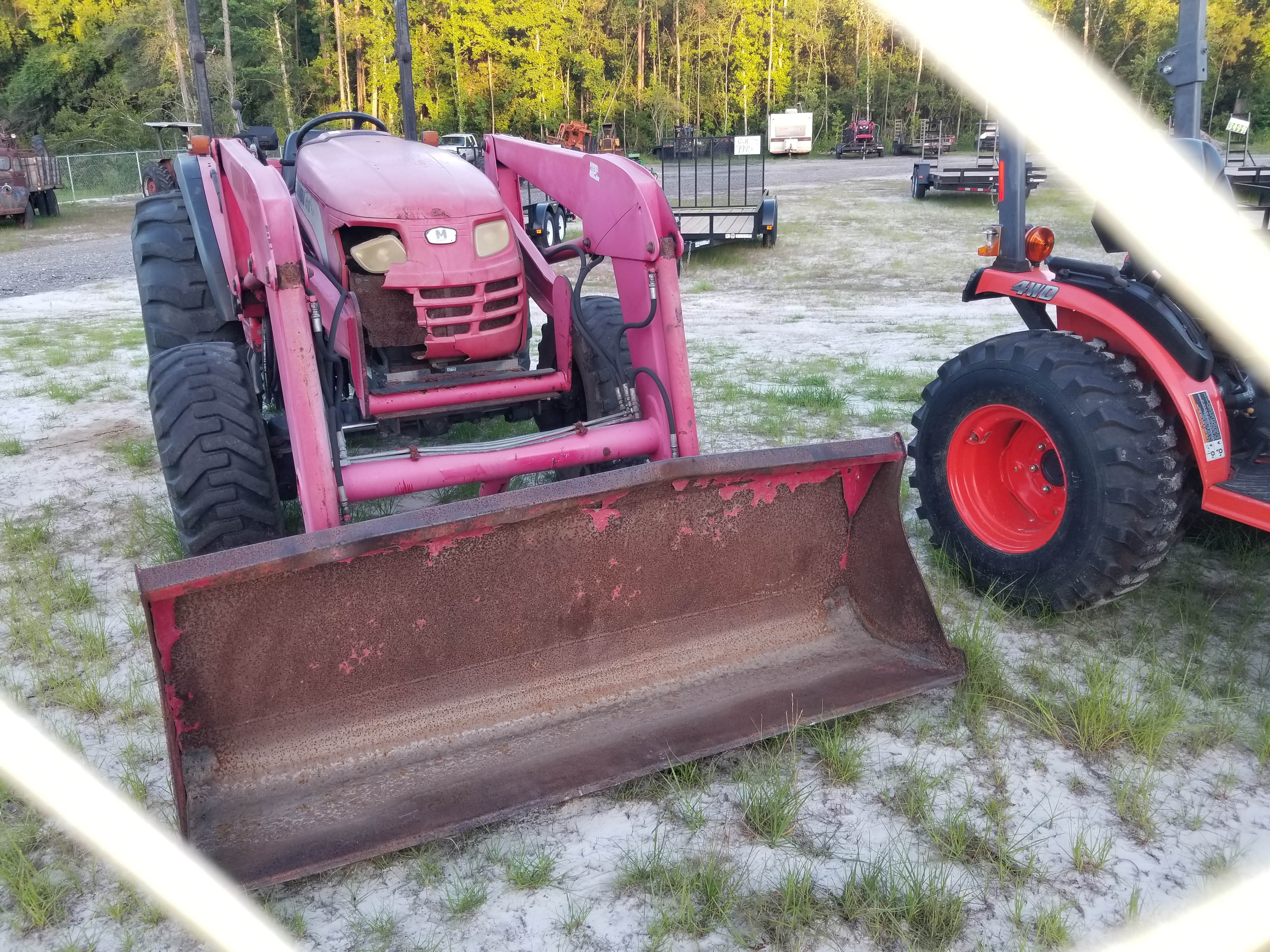

it has 1600 hours ..Manuel trans.. he wants $8500, it runs and works great he says, just has never seen the inside of a barn.forgot to ask year,they made this model from 2002-2009. no attachments rams just repacked,( it would replace my 1963 ford 4000 loader,its tired of me!)

IMHO it's rough. Paint fade doesn't bother me but the front grill is cracked along with the front headlight. Looks like it's had a hard life. I would be concerned about maintenance on the unit. If that could be verified you still have a geared tractor with a FEL. I would be looking for at least a shuttle shift or hydrostat.

Needs tires (also note fronts are reversed) plus other things mentioned. Tires and damage may be a bargaining tool if it runs well.

Not sure if it’s my old eyes or not but I do not see much grease around the pins.
