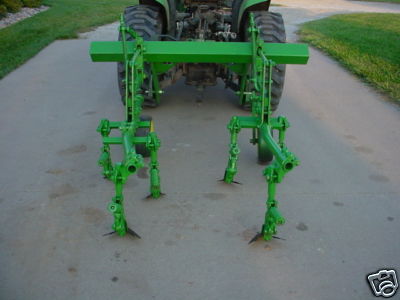

I need to know what you think .... 1 row or two row?

I would call that 2 rows. Each pass up and down the field, requires you to move over 2 rows with the tractor. (Or if you like, the tractor can be driven on top of each row, and you will destroy 2 rows at a time.;) Been there, done that.)

That is a one row cultivator. A two row will do three middles at a time.

That's a ONE ROW cultivator. The single row of crop will be between the two 1/2-row sweep(s) A two row cultivator would have a wide, full width center section, then those two sets of 1/2-row sweeps at each end.
Cultivating corn (or any other row crop) takes more skill and attention than just about any farm chore. I've seen many a row of corn plowed out by a "sleeping operator".

It disappeared because I had a link to a website that was not allowed ... After a PM from the Mod and sorted it out I reposted.
I agree its a one row, when I responded to the ad that had A two row for sale, the seller Told me I obviously was to young to realize that this was a two row.
Here is my thought. A one row straddles one row, a two row straddles two all the way up to ... well the biggest I used as a kid was a 12 row... that took 12rows.
Also as a kid, dad always made sure when we where cultivating say with a four row, if need be always skip 4 rows ... I think he was teaching us to count ... BTW the headlands where planted accordingly...

I am looking at it different than you are. If each set of 3 cultivator sweeps is designed for a half row, then you are exactly right. It just seems strange to me that if this was say a 4 row cultivator, that it would have 6 sweeps/row. That seems excessive for a cultivator. Also, the width between the 2 sets of cultivator sweeps is fairly wide and not very close to the row. My prior cultivator had shanks much closer to the sides of the rows. Another reason why I thought it maybe a 2 row. I used to use a 6 row cultivator that had sets of sweeps for 6 rows and 2 additional outside half set of sweeps. The outside did onside of a row and when it turned, the other half was completed by the same outside set.
Your probably right and I am wrong. Just hadn't seen a 1 row cultivator. When I look at the picture again, the sweeps are not very wide which would also support a 1 row cultivator with 2 half sets.

That particular cultivator is a cut down version of a Deere "RG" cultivator. That's what I used in my corn for 30 years. The proper set-up for multiple rows has more sweeps per shank mounted on the interior rows. There is still just the one row unit, but additional sweeps are mounted on it, totalling 5 sweeps per FULL ROW on mine, that was set up for 30" rows. The outer "1/2-rows" had 3 sweeps. Mine was a 4-row unit. It had three FULL ROWS, plus the two 1/2-rows on the outer ends, for a TOTAL of 4 rows. That's the norm.
I raised about 25 acres of organic popcorn every year. No chemicals allowed. That had to be cultivated 2 or 3 times, until it canopied. I MUCH prefer a mid-mounted cultivator to where the operator wouldn't ever need to look back. It's virtually impossible to hold course with eyes to the rear. With enough practice, I got to where I could cultivate at roughly 4mp. My cultivator had either rolling shields or fender shields to keep dirt from burying young crops.
