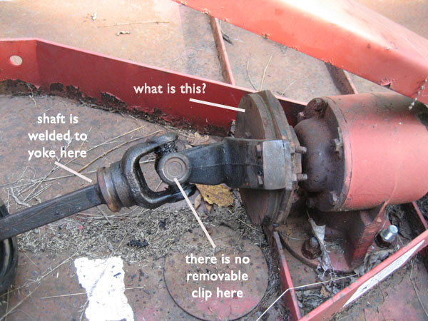

I bought this used rotary cutter. I'm a bit of a newbie and know that I'm supposed to have some kind of shear protection, like a bolt, but don't know where to find it.
Here is a photo of my PTO shaft and how it is connect to the cutter. As you can see the shaft is welded to the yoke.
(seperately, I'm trying to figure out how to disconnect the shaft from the yoke so I can replace it with a longer shaft)
Am I missing something -- is there supposed to be a slip clutch or a shear pin? Or is the thing marked "what is this" the slip clutch?
I assume if I don't have either then this is not a good setup to run?

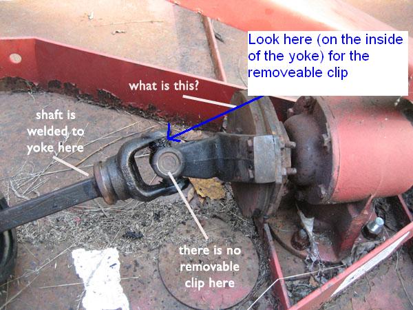

On the removable clip question, your clips are on the inside of the yoke, about where my blue arrow is pointing. rotarymower1074Notes.jpg
The welding of the shaft and the yoke looks normal to me, there was at one time a guard that hooked into the groove on the end of the yoke near where it is welded to the shaft
As to the "what is this" thing I dont know, but if you pull the 4 bolts that hold the cross bracket halves together you should be able to take the whole thing off and that will make it MUCH easier to work on the yoke (trust me, I had to disassemble a similar yoke for our mower conditioner this summer). If it was me adding a longer shaft onto the yoke, I would take off the 4 bolts and take it into a shop and let them change out the shaft, it will be MUCH easier for you and to have the yoke rebuilt on our mo-co this summer only cost ~$30 (parts and labor).

Inside clips, interesting concept - I've just never seen any. If you don't find them on yours, my guess is that you just hammer the cross out like any other U-joint. The "what is this" component looks like some kind of primitive slip clutch. Hard to tell from a photo if it's operable - or even salvageable. It would help to know up front what kind of RC this actually (make and model I mean)
As far as lengthening the shaft, you can get PTO driveline components (repair/replacement parts) at or through any farm supply store - or online from places like AgriSupply. But if that slip clutch is frozen - and if the rest of the RC can be considered worth the additional investment - you might want to consider buying a whole PTO drive line. If this is a 5 foot or smaller medium or light duty cutter, you can probably get by with the less expensive shear bolt type. If it's 6 foot or larger medium or heavy duty, I'd spring the extra bucks for the slip clutch version.

You can get a new yoke/shaft (male shaft and half of the yoke) at tractor supply or a similar store. However if you have never taken apart a yoke before I would not recommend it unless you are very good with tools, it has to be put back in just so or it will bind and removing the center takes some creativity with a vise as the inside clip retainers are a PITA to get loose. If you pull the 4 bolts and take it into a decent dealer they should be able to get you the parts you need, and put it together. I would guess that it will run you $60-100 for the shaft (depending on the length and style) and $20-30 for the center of the yoke.
If you don't have a good tractor dealer nearby, you can pull the 4 bolts, take the assembly into tractor supply, have then set you up with a shaft and take the whole thing to a truck repair shop, they will be able to press out the old center and in a new one with your new shaft pretty quickly. You may need to have them take it apart first so that you can get the measurements as to the yoke size and then take them the new shaft.

You may also be able to remove the whole assembly after removing the 4 bolts and put in a whole new PTO shaft.
Pull the bolts and post some pictures of how it looks.

It won't slip. When you get into the rough stuff - wet grass especially - or hit an unseen rock or tree stump - the clutch is suppose to slip before the shock travels all the way up the driveline and breaks something inside the tractor transmission. You need to disassemble/clean/adjust/reassemble - and hope for the best. If it won't come apart, it likely won't slip either.
