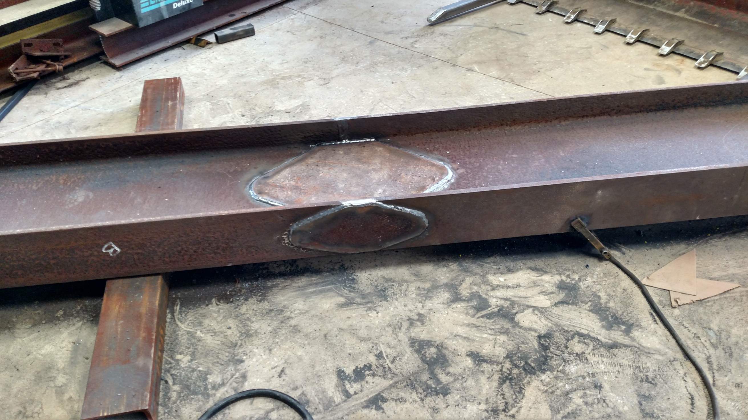

Is this the proper way to weld a patch?
   / Is this the proper way to weld a patch? #1
franklin2
Gold Member
Dec 28, 2010
320
Staunton, Va
kubota f2000
I want to know is the below method the proper way to weld the patch to the I-beam splice? I have a book that says to never weld all the way around the patch, only weld two sides and those sides need to be parallel to the length side of the beam. The book says welding all the way around creates too much stress in the patch and it will tend to crack later. Unless you have a way to heat the whole area red to relax it. I see he welded it at a angle, and I have heard of "fishplating" before. If that is the proper method, how does putting the patch at a angle get rid of the stress from welding all the way around the patch? Just trying to learn something here, not being critical.

You'll see fish plates more so on equipment, than on structural shapes. There are two schools of thought on welding the fish plate all the way around, or just two side. I really don't know the correct answer. Always left that up to the engineers.
   / Is this the proper way to weld a patch? #3
When an I beam is loaded, all the stress is in the top and bottom plates. The web in the center just keeps the two plates separated. So, what happens in the very middle doesn't matter much. (That's why you drill holes in the center for wire passage, etc.). The purpose of a fish plate is to avoid having an abrupt change in cross section, which leads to a stress concentration at the transition point. It looks like a decent repair to me - what is critical is the top and bottom plate connection.
   / Is this the proper way to weld a patch? #4
im no engineer but the only thing I don't like about the above "patch" is the continuous welding....if it was to crack for some reason the crack would eventually (in theory) keep traveling... now if it was stich weld and cracked only that leg of the stich would be comprimesed and not the entired patch.... just my 2 cents and that 2nd patch on the outside flange? Ive never seen that done b4.. usually just the flange is beveled and filled in.
   / Is this the proper way to weld a patch? #5
As long as the flange scab plate is the top side of the beam or the side opposite of compression forces, I don't see anything wrong with the joint. All the weld areas should be full penetration welds which in severe service would require xray of the welds to confirm.
I personally prefer to fully weld any patch to avoid water intrusion that would cause corrosion to form underneath the patch. With the patch shaped as in the photo, there is very little stress induced into the area.
I worked for 45 years in heavy construction and this is the way it was always specified by engineering. Whether that is 100% the correct way or not might be debatable by some.

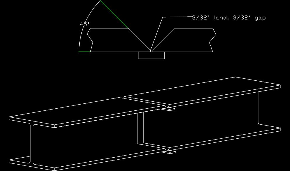

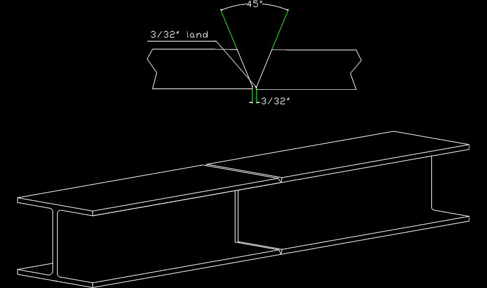

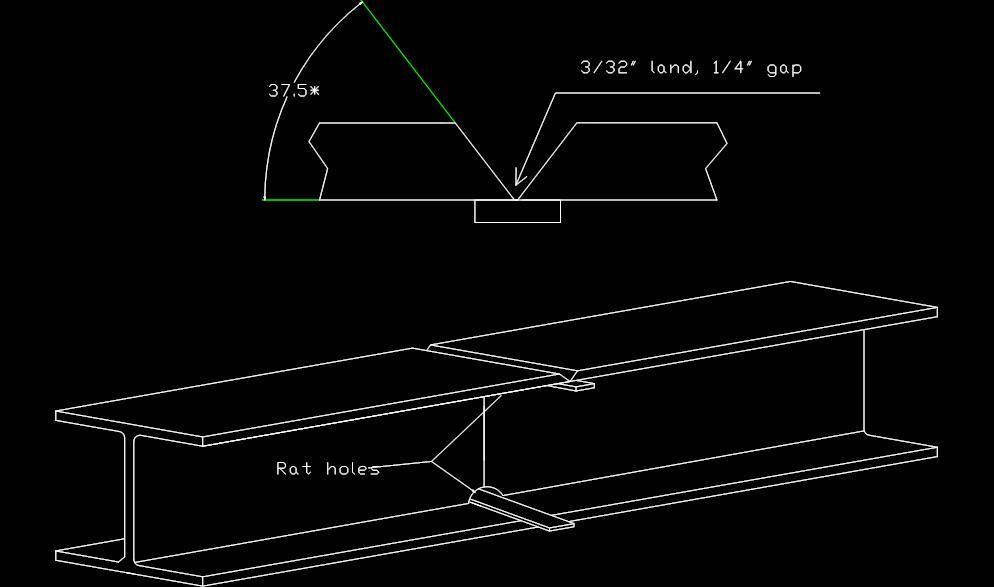

Even though I'm just a hobbyist welder, I've spliced a beam or two.
Here are some joint preps I like to use.

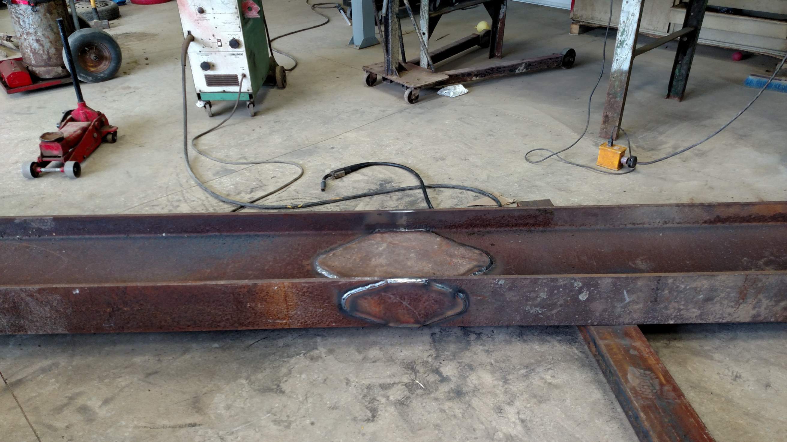

Most all of the plates I have seen on heavy equipment, backhoes, and even my little kubota FEL are similar diamond shape and welded all the way around.
I figure the plating isnt even necessary with having beveled everything and welding all the way around assuring 100% penetration. So the plating is just for extra measures since I aint a very good welder.
And it is plated ALL the way around, including the very critical top flange. Here is the rest of the pictures
IMG_20151115_155414894_HDR.jpgIMG_20151117_121344471_HDR.jpgIMG_20151117_121400982.jpg

I don't see the harm in the fish plates, it's not like you're paying for the labor. On the job site it might be a totally different story!

My home sits on the 4 concrete foam block poured walls with a 3/4" thick 12" tall 52' long I beam running down the length in the middle with 2 pillars sitting on concrete footings. They beveled and welded the 2 beams together with Dual Shield and then did the plates on top, bottom and both sides. Fully welded. They made sure that the welded portions were on top of the pillars. Hope it holds a few more years.
   / Is this the proper way to weld a patch? #11
The truck upfitters use fish plates a lot when modifying a chassis (lengthening, shortening, offsetting). The ones I've seen usually are welded completely around the perimeter of the plate and have a few plug welds in the fish plate.

If you want to weld all the way around your fishplate is correct if it were a square plate, you would have only wanted to weld parallel with the beam and plug welded inside the plate.
A vertical weld would only cause a "stress riser" and subsequent failure at that point.
One can weld too much and make a structure more prone of failure.
I have a book I give to new welders called Welding Secrets by Hal Wilson, that illustrates that point as well as others.
In short if you do it wrong you create a "notch" that focuses the stress into the material where it is most prone to fail.
Other than that looks like you didn't clean the weld area well enough leaving rust in the beam that would lead to inclusions in the weld and didn't allow the fillet to completely tie the plate to the beam. It also looks like you were too "cold" from 6 o'clock to 3 o'clock, better at the tip around 7 o'clock but that is the main problem with MIG welding, being that if you are not there watching as it is being laid down, it might look great but have little penetration. Why we have X-ray, dye penetrant, etc to test them after the fact.

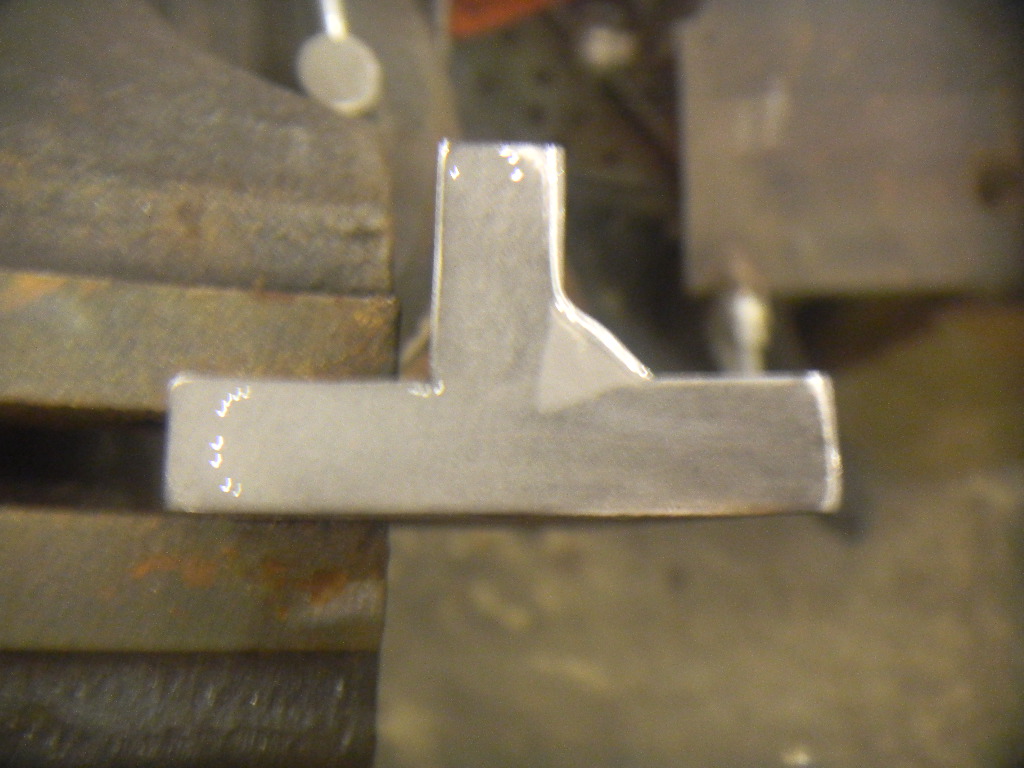

The secrete to getting good penetration with the Mig process, is very simple. Pure power!;)
224-amps, 29-volts.

Amperage, wire speed, diameter of the wire, how clean the weld area is, shielding gas/flow and where it is all directed all have effects on penetration.
The second photo above (#14) is less than 50% into the parent material looking into the "pie".

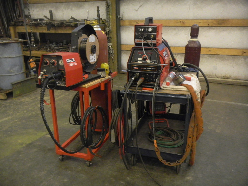

What gauge wire do you run for that kind of juice?
I think that was .035" wire. I ran that with my Lincoln V350-Pro inverter.
