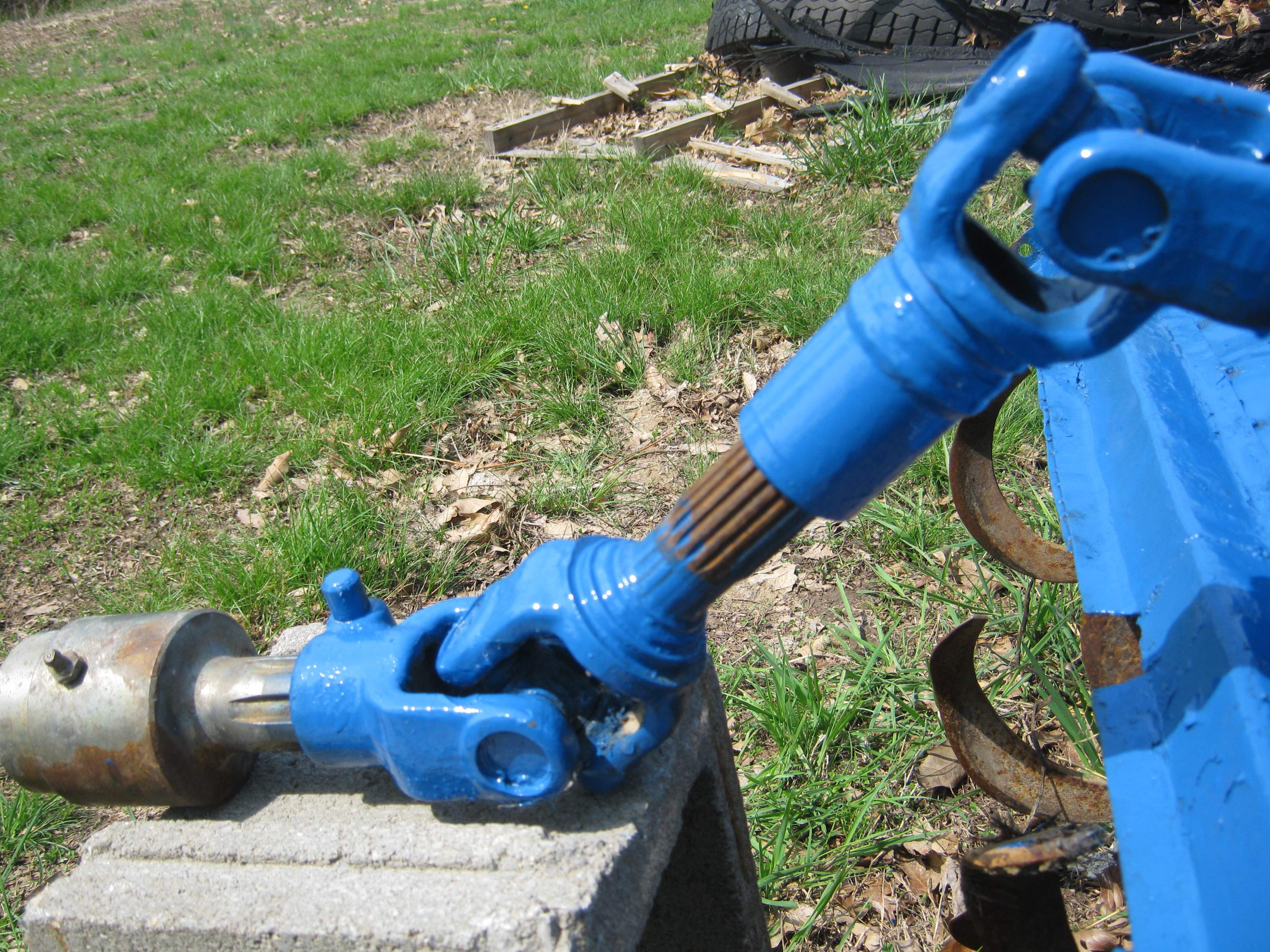

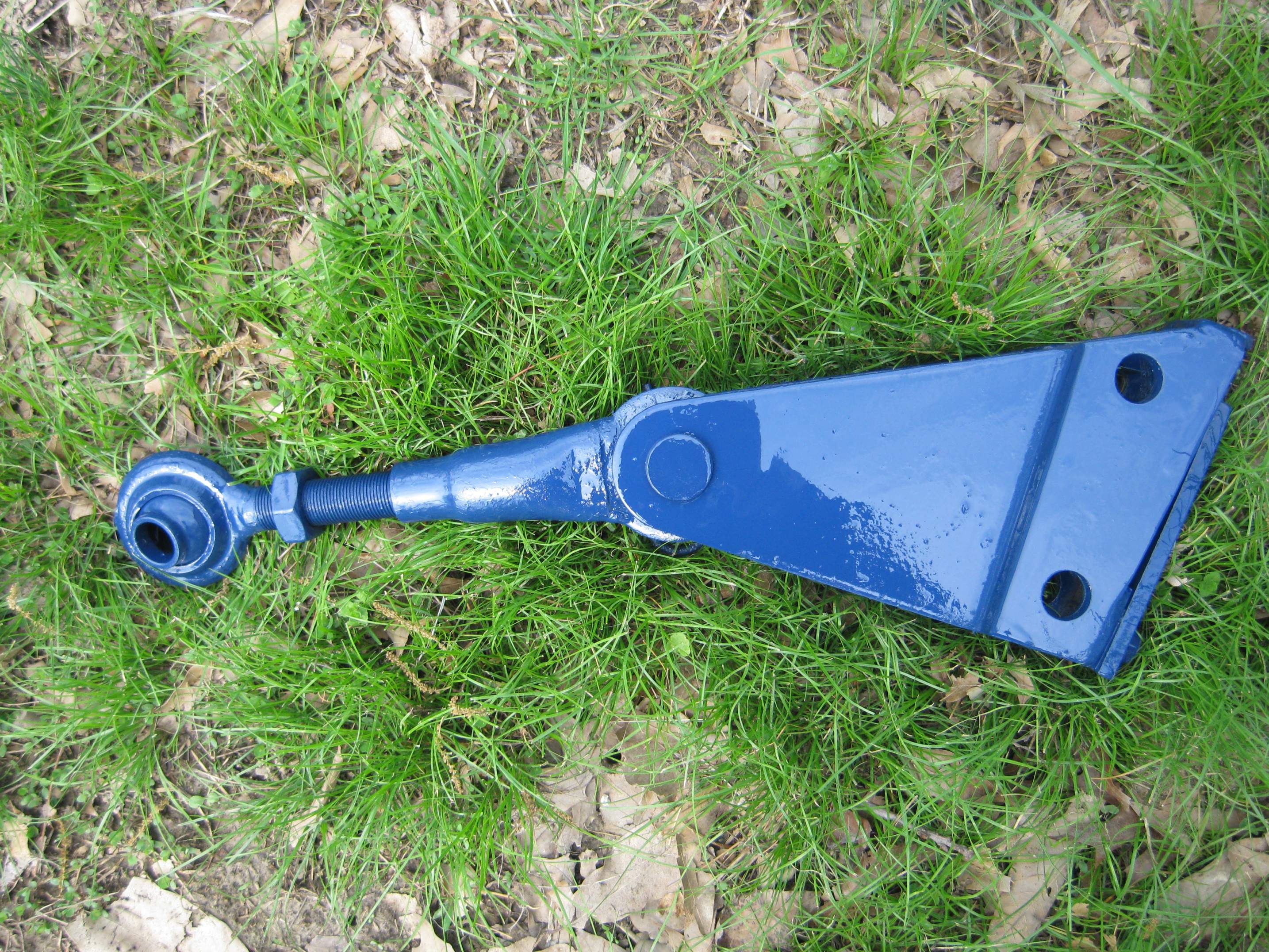

This is the basic set up that has come with every rice tiller I've had. A short slip splined shaft w/ u- joints. This is an original Iseki drive shaft with a PTO overrun clutch/extension to allow it reach on my tractor. I have a shorter pair of lift arm that allows the pto to hook up w/o the pto extension but the tiller hits the tires with that set up. I have used the tiller this way for years with no problems.
AS far as the top link, the tiller should have come with a special short unit. You can make your own though. I have a top link I cut an rewelded and use it with the tiller sometimes. You could simply make one out of a piece of pipe w/ flattened ends and holes drilled/torched in....might just have to get creative.
As far as the tiller pins being too narrow. Can you take your sway bars loose from the lift arms and hook up to the tiller then? If so, just make a set of chains to use as sway bars when using the tiller....this is what I had to do with my current lift arms. If that doesn't work, a variety of lift arms are available at our local farm supply stores and are pretty reasonably priced.
These tillers are not made for tilling very rocky or super compacted soils but they will work great as long as you use a little caution. If the ground has never been broke, run your box blade scarifiers, disc, plow or something though it first it just to loosen it up. The next year you should be fine. I do occasionally break tines and fortunately have extras. Some day I'll do what bjr did but these tillers can and will work fine as they are....you just have to be a little careful with them.
