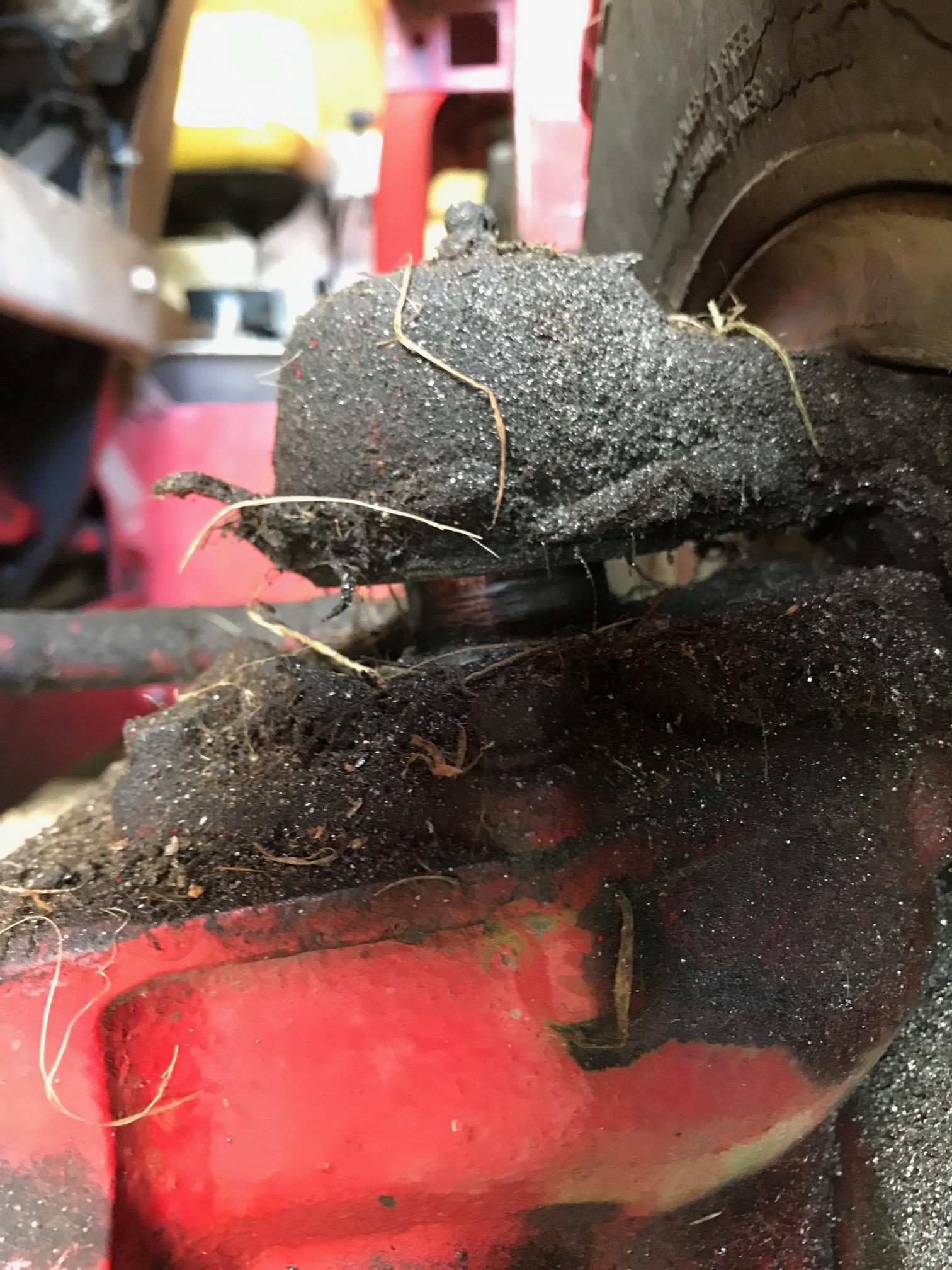

I have an Iseki/Field Boss 37 4 wheel drive tractor. The frontend ball joint/kingpin on the left side looks like it's coming apart. Does anybody know what's going on and do you have any suggestions on how to fix it? Please see attached photo. Thanks in advance.

I looked at AGCO Parts Books ( enter site as "Guest"). If I am looking at the right diagram ("Final drive, power front axle" pp.114), I looks like there are 2 snap rings that hold that shaft in place. I would suspect that one failed.

Sorry I didn't/couldn't reply to you sooner. Thank you Darryl for providing the link to the parts book. I'm looking at it now and getting a good understanding of what's going on.
