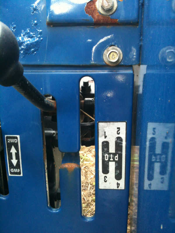

I found a thread in the past that said what each position was but I can not find it now. Mine has the H pattern and 4 speeds. Not sure which one is 540.

I have an Iseki TL 2300 with the H pto pattern. I run my brush hog in position 1. I believe that is 540. I have a operators manual for Bolens G274 which shows only a 2 speed selection (540/1000).

Hmmm. Which way is up in the picture?
I wish mine was labeled with numbers!
   / iseki pto speeds and positions #4
Howdy.
#1 and #2 are "Up".
The #1 position is closest to the transmission body.
Thanks for your reply! I have been using the wrong speed! oops.
